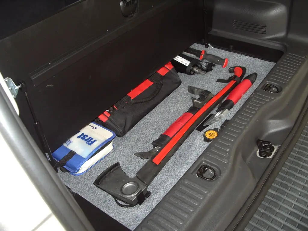

i have the same idea to install a 2nd battery , have the room for it here
took the 3rd row seat out , there is a ton of room left where the 3rd row foot well is . also want to install a 3000w inverter to run my converted air compressor and some other goodies .
i was told it would be legal to mount the battery inside as long as it was in a batt box . haven't been able to find a diagram to do what i want . it would be a good idea to use a deep cycle battery for your back-up , since it will be isolated. the only advantage of an optima battery is that you can mount it on it's side , because it's a dry cell and it can take extreme abuse , they also cost about $200 .
