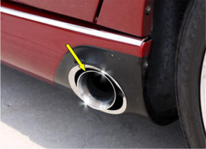

Can you please tell me if this fix was done under warranty at a Ford dealer and did they state that there is a new TSB for it? I have an appointment to take it back in, but based on the phone conversation it sounded like, it was going to just sit at the dealer as they did not have any other options than what they already did. The revised exhaust tips turning down, makes sense to me as I feel it is the exhaust getting pulled back into the vehicle as it keeps accelerating.

Anyone thought about redirecting the exhaust to the side??
