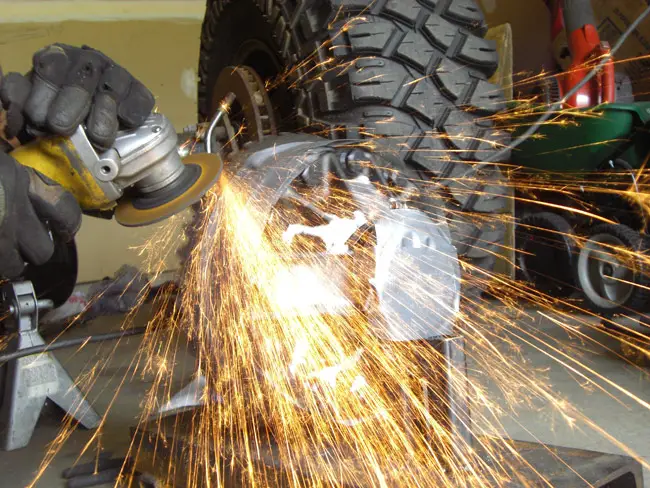

Or you can grind down the ring gear ;) Since the contact patch to the pinion never really goes to the full length of the teeth but more towards the middle -- just a wild crazzzzzy idea.
EDIT: voila (different axle though):

Pretty sure whomever did that would have been pretty careful to make sure it was still round. I would have spun it while grinding... but that's me.
yeah i think thats how the guy did it. Plus the guy said that being out of round doesnt matter too much even if it throws the balance off a bit because people have been notching other ring gears to get the center pin on (ex: ford 8.8) -- as long as the contact pattern isn't touched.
