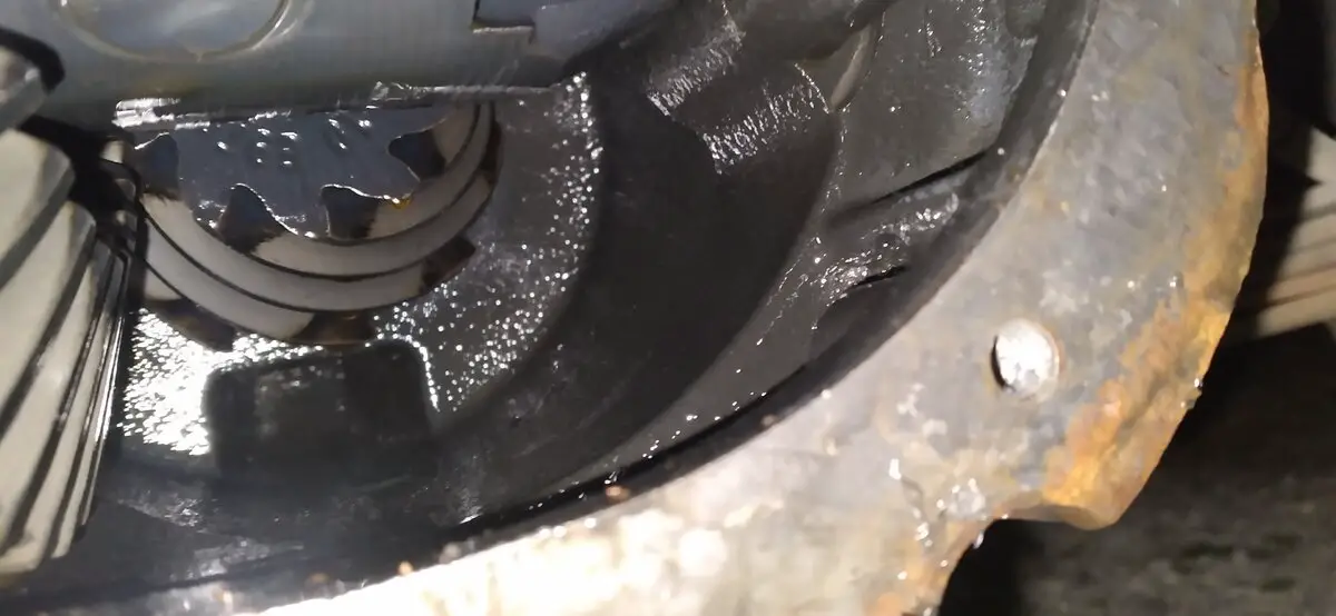

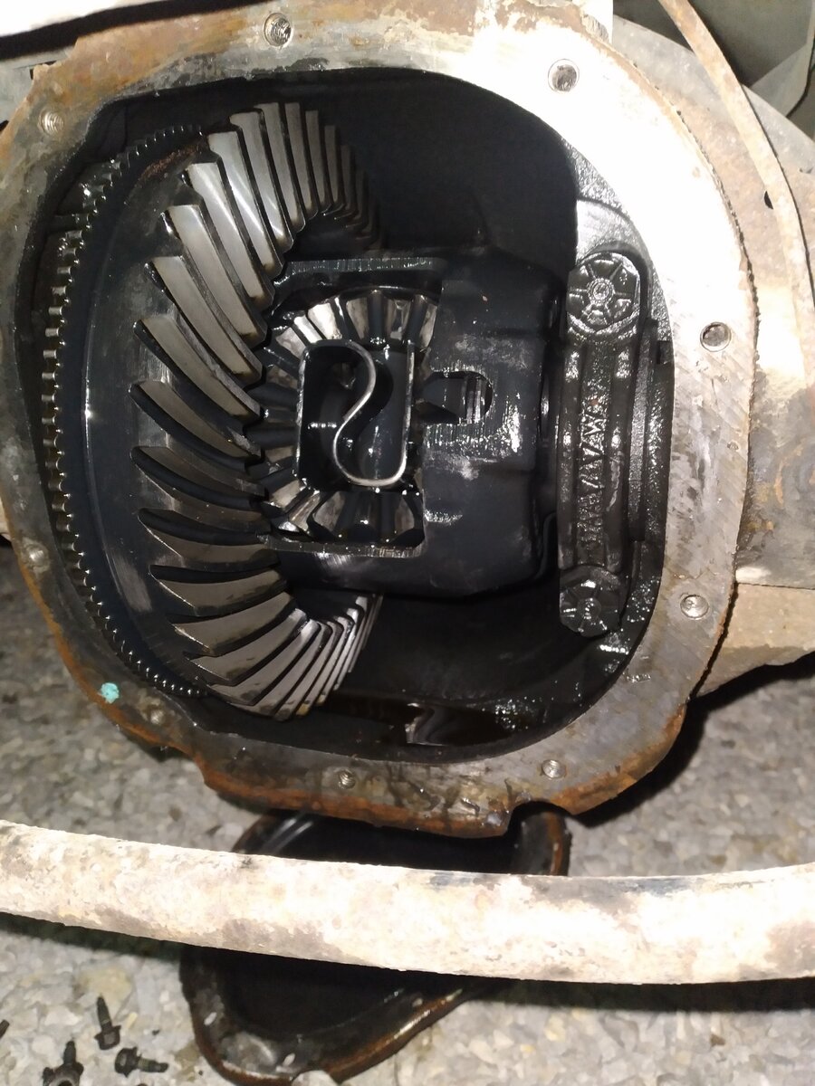

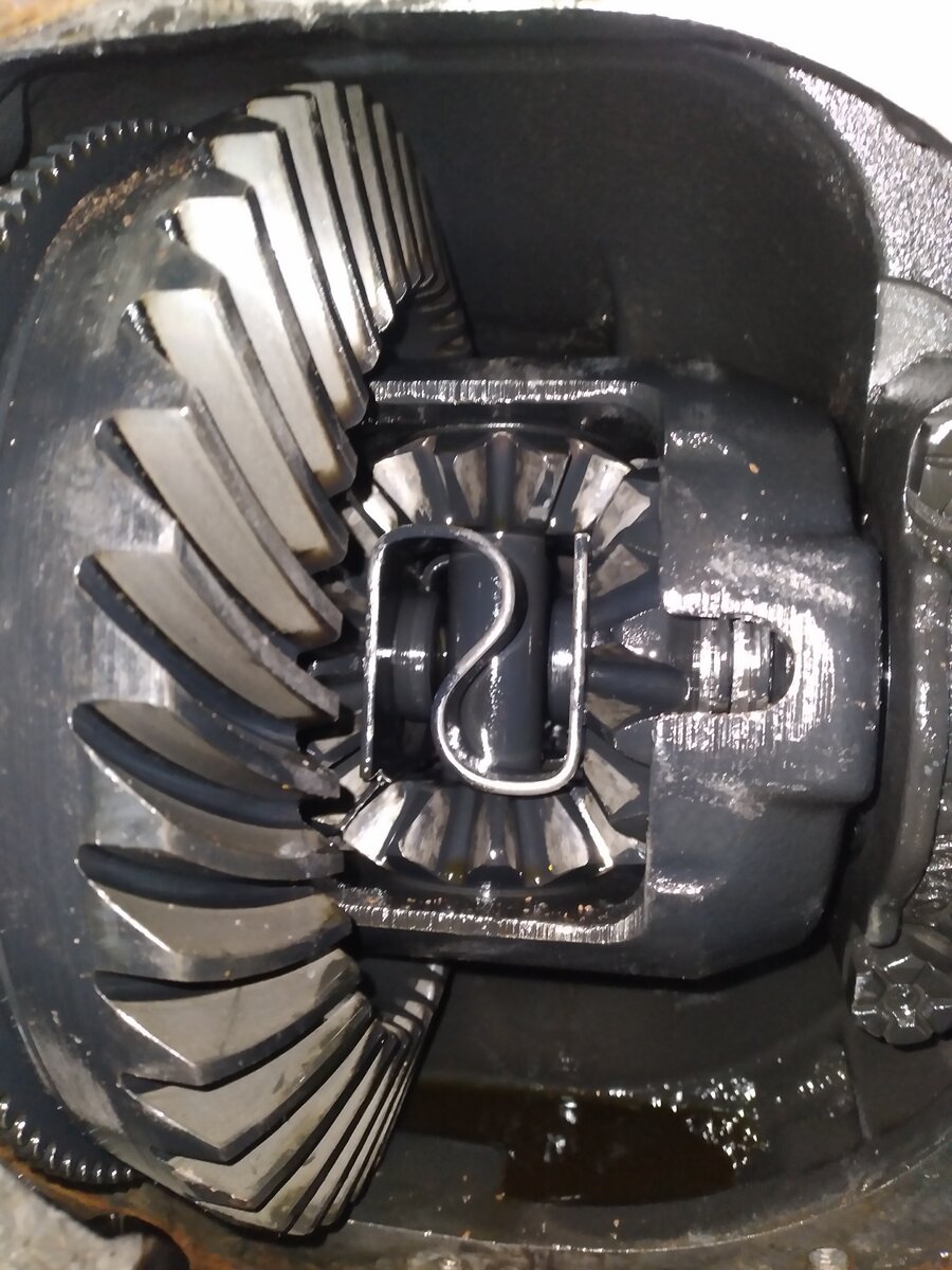

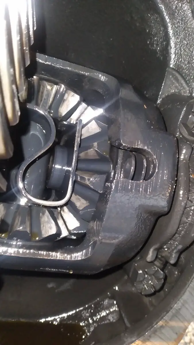

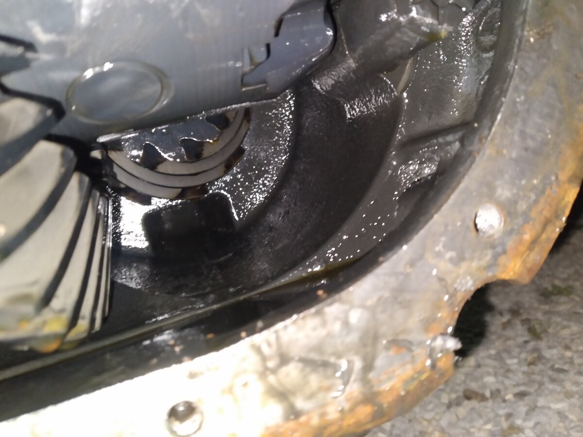

Can anyone tell me if these spider gears are bad? I have been getting a loud banging noise coming from the drivetrain. It only happens while accelerating and it happens when driving straight. I had a guy look at it and tell me the spider gears were bad. I was also told that if the spider gears were bad, it would only make that noise while turning? My next question is, if it is the spider gears, should I just replace the whole differential? Sorry I don't know much about this, and I don't have alot of money to put into it right now. Thanks for the help! 20221110_163815.jpg
Hard to say. They look worn for sure, but how worn is too worn? Kinda odd for spyder gears to wear out…
How many miles on the diff?
Generally, for spider gears to go, it means either abuse or a severe lack of maintenance. Could also be a bad batch of gears, but unlikely esp if OEM.
I replaced mine when I rebuilt my original rear at 328,000mi and they looked absolutely new.

Gears are worn. If money is tight, get a junk yard replacement. Open it up before you leave the yard with it to make sure it looks good. The 8.8 in my aerostar has over 300k miles and the gears look brand new when I pop the cover off to change the fluid.

Could you post some pictures of the ring and pinion gears? Running low on oil causes other issues. If the gears were starved for lubrication, then the bearings could have suffered the same fate. As far as the popping sound is your explorer 2 wheel drive?
It is 4wd. I don't have any pics of the ring & pinion but it looked like it had been replaced already. The only thing that looked worn was the spider gears. If I replace just the spider gears, should I get a bearing kit also?
