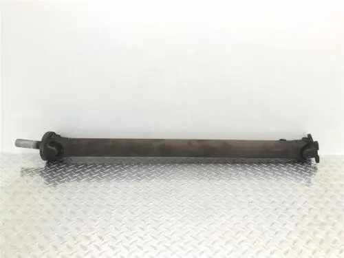

Trans fluid might not be enough , apply grease to splines. Some have bolt flang s on both ends, slide in center
98 4door 4wd looks like that

No just Curious if the single pc drive shaft spines will need to be lubricated
I never read it anywhere on this forum That the output shaft spines need to be lubricated I thought that the transmission fluid Did the job

You do NOT lube the splines on the slip yoke style ONE PIECE driveshaft
You DO lube the splines IN THE SLIP YOKE of a TWO PIECE driveshaft
Now with that said I never install a driveshaft into a transmission tailhousing dry, you can rip the seal. So some atf or a light coat of vaseline is the way to go. You do not want to put anything else inside your transmission

The tail housing on the 5r55 transmissions inside is dead space. The only thing in there is the park actuator, but yes lube the seal.
