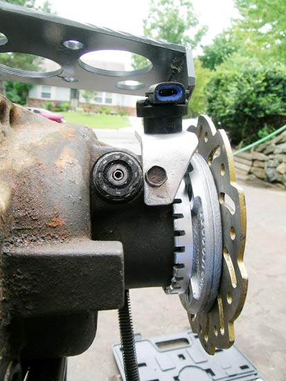

Can't you just use a spare tone ring? I think I have one :rolleyes:
Thanks - i have one but I don't think an 8.8's tone ring will work cauz this is what my RABS setup looks like
