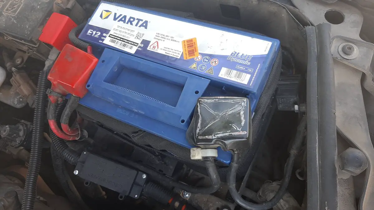

The battery dimensions was too high for the vehicle.
Actually the hood impact damaged the battery negative terminal .ive replaced the last battery with the oem dimensions and fixed the problem permanently.
3 ruined batteries lol
No parasitic draw.just the battery cells damaged issue
No parasitic draw.just the battery cells damaged issueView attachment 429943
Well, that's gotta' suck.
