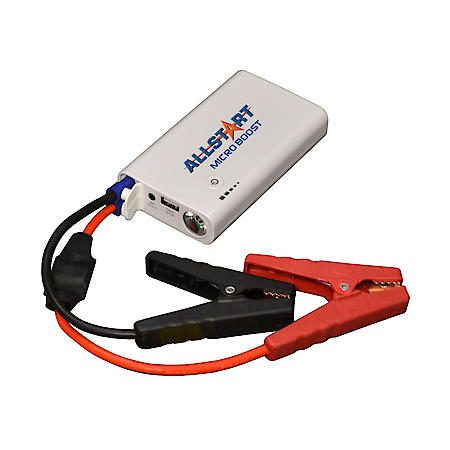

Even better, and safer, is a jumper pack. I've got one of these and it has saved my bacon on several occasions, not to mention helping out friends and neighbors.

Not sure if I'd call a jumper pack all that much safer. They can still create a spark that ignites hydrogen fumes and those as pictured have Li-Ion cells in them which if defective, or the charging circuit, or aging in a vehicle subject to hot and cold weather, could fail and result in a fire when you're not even around to catch it or while driving.
I just don't trust storing any Li-Ion powered device in a vehicle, let alone one where I don't know if they're using quality, major manufacturer Li-Ion cells in it.
I've had no problem using 4ga and 6ga cables, but come to think of it mine are so old that they're probably all copper. Today you have to assume you need a lower gauge to make up for the fact that they're a higher resistance copper clad aluminum wire, unless specifically stated to be solid copper.
While these are all valid points, I'd like to point out the following:
1) I don't store in either of my cars, simply taking it with me when I may need it (long trip, having battery issues, etc...)
2) As for the spark issue, with the one I have, you connect the leads to the battery, and THEN plug them into a shrouded socket on the pack, so, there is no spark near the battery.
