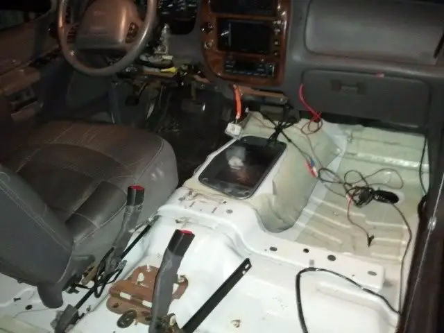

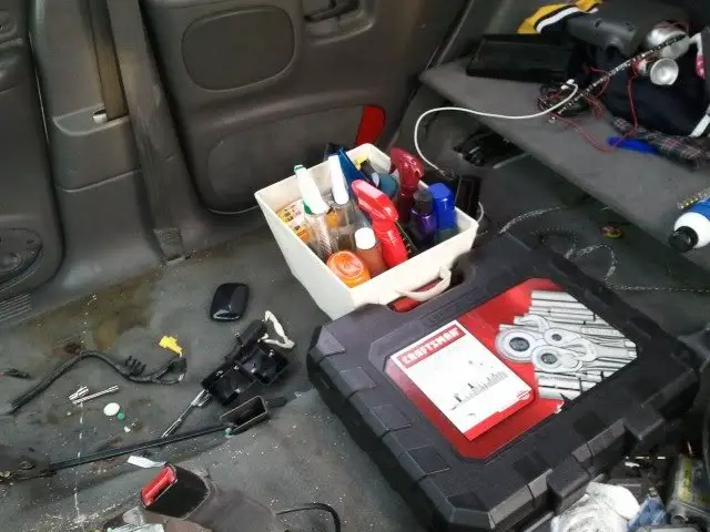

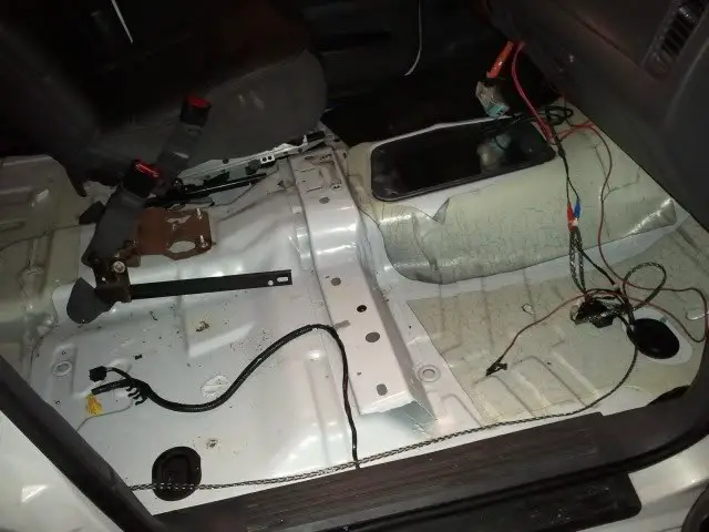

*WARNING WHAT YOU ARE ABOUT TO SEE IS DISCUSTING. IT IS ADVISED THAT THOSE WITH WEAK STOMACHS; OR IF YOU HAVE DIAL UP/DSL, CLICK THE "BACK" BUTTON ON YOUR COMPUTER'S BROWSER IMMEDIATELY!*
After :)
This is the only spot that I couldnt fully get out :(
Heres how shes sittin now
Sorry the bottom pictures are lower quality, the upper ones were with my phone (5MP), and the lowers were with my iPod, my phone was dead, and my cig lighter wont work!

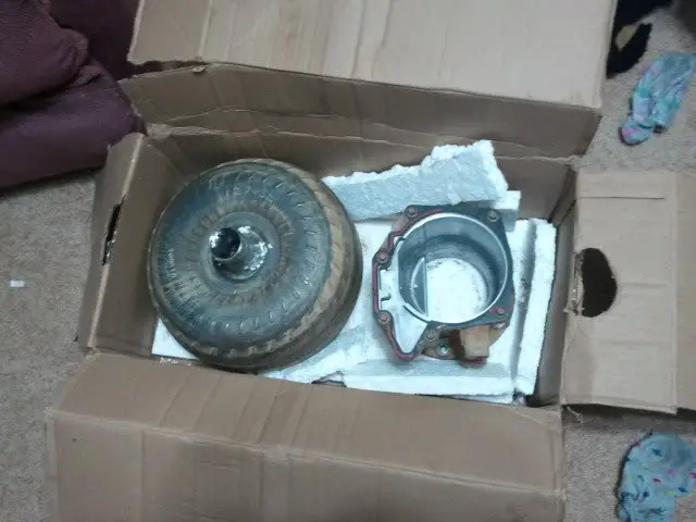

Got some goodies today :)
Good stuff mate!!! Did you get a good price on the freight?
Actually they UPS'ed it, it was 140 I think? Not too shabby :) now to find someone to install it for under 400...

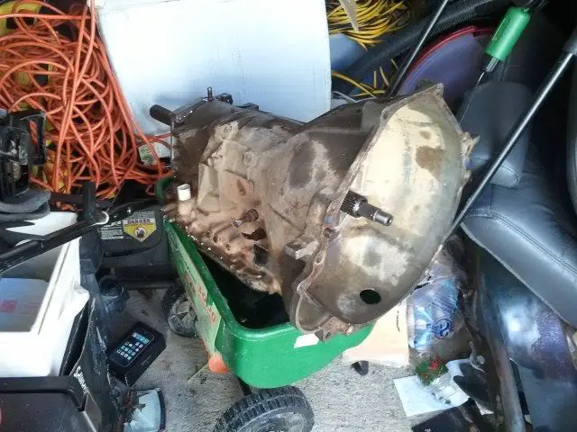

Im bummed though, the guy retracted his "250$" quote to swap my transmissions out, he wants 400$ now PLUS my fluid. (He claims that alot can break when removing/installing a trans so 400$ and everything is covered)
In my eyes: If you know what your doing, nothing should break/go wrong. Thats just one of those statements for the average person who thinks "OMG! Theyre totally right, no other shops told me that so ill definitely have you do it!"
Idk, im just in a stuck-boat about installing this. Theres no way in hell im gonna do it myself, this is just one thing I dont trust, plus I dont have the money to fix something if it does go wrong. I guess ill just wait it out a couple more weeks and see who else I can find.
Hell, if there were any members on here from MI or northern OH that would want todo the swap id pay 300$ (Plus bring my own fluid)
Im also wondering, if Amsoil/Royal Purple full synth. is almost 10$ a quart, its gonna be over 100$ for the fluid alone, what IF something went wrong and the trans had to be dropped; or the pan? Theres +100$ down the drain (Almost literally). Should I use conventional ATF for the first week or so to make sure everything is okay?
Add a drain plug to save the fluid....Why not do the vb upgrades to your trans and see if it solves your shifting issues. If it doesn't put the upgraded vb in the new trans.
I'd start with an inexpensive fluid first. Get it running and stable, and when you can then go back to do the VB etc, and swap fluids.
When you R&R the VB, that will get all of the fluid out except for what's left in the lines and TC. The TC has a plug in it so you can get that extra 2 quarts too.
The Walmart off brand fluid will work, though I don't like it. I bought a gallon of that when I had to put my Explorer's V6 5R55E pan etc, back together, to move it into my driveway. I sucked old fluid from my 4R70W to top off the V6 trans, and then filled the 4R trans with the cheap new Walmart fluid. It'll do for a while. I wouldn't use it for a weak trans or a long term keeper.
How easy is the TC to get to with the trans in though? I thought the trans pretty much hides the TC?

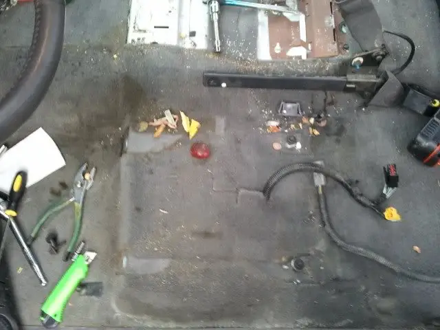

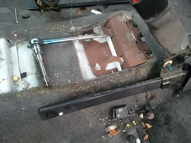

Anyways, does anyone know what this is for? Im not sure if theres one on the drivers side, but this is behind the passenger side seatbelt panel by the floor. Its not plugged into anything besides a dummy socket just to hold it...

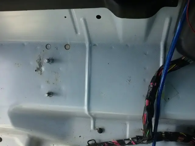

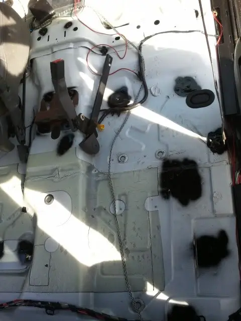

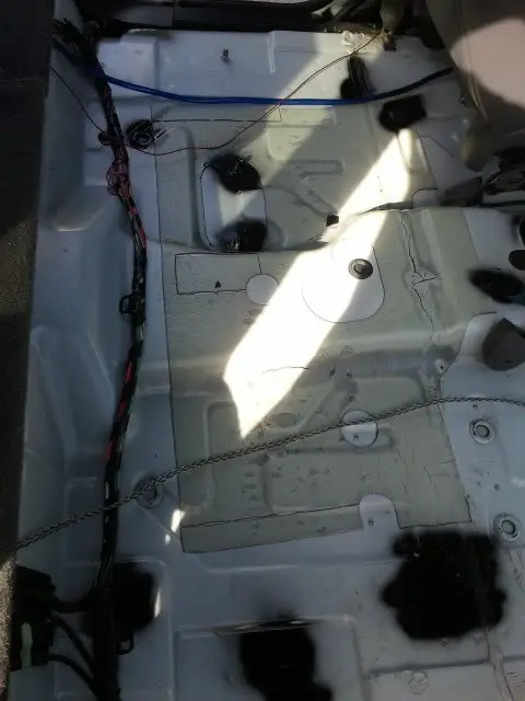

I cant believe how filthy the FLOOR was!
The left side is cleaned, the right side hadnt been yet:
Now it is:)
I also thought it would be a smart idea to maybe "rust proof" it down there too, or at least some preventative rust maintinence (Rustoleum)
I sprayed all the seat bolts, and bolt holes, and then all the seams.

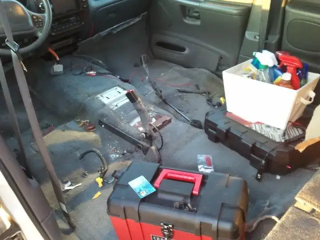

Im hoping to get some new (shorter) RCA's, and 0 gauge wiring by this weekend so I can run it under the carpet. 0 would literally be impossible to run along the trim, which is why I havent done it yet. I even have about 6' of 0 left for my alternator to my battery, and a couple long strands of 4 gauge for ground spots.
The 4R70W has a TC access hole/plug in the bottom of the bell housing. The TC plug will line up with that hole.
That looks like the side airbag connectors, but they are all yellow I thought. Is it empty in the plug, or are there metal terminals? It would be a resistor if it's for the airbags.
Have you decided where the best way is to run the RCA and power cables? I'm going to place my three amp under the back seats, so I was planning the RCA cables to go along the console.
Put some sound deadening down if you can.
I just ordered 25' of 0 gauge at DT (60$ for a really good flexible type he said the name but I cant remember. I really want todo dynamat but I don't wanna shell out another 140$ before I get the trans done that's top priority. I'm gonna run the RCAs more towards the passenger side, of the console and the poer wire along the drivers side but still keeping them away from eachother. I'm gonna keep the 4 gauge I have now too for later whenever I install a 4 channel amp. I tell you what, I want todo so much with the carpet out lol, run new amp wire, rcas, dynamat, now would also be the time to run new speaker wire and another set of rcas for the 4 channel amp even!

I can safely say thank you again, because I would have literally never just randomly thought of/tried that. I figured there'd be so much more involved to taking the carpet out.
