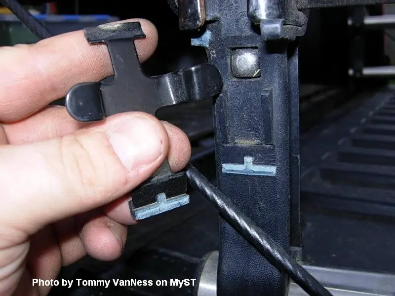

I bought an 05 Sport the first of July. Has both the factory tonneau and what was left of the bed extender. The pivot post and the end caps were missing, no locking pins either. Found one on Craigslist for 50 bucks, in good shape but it is missing one of the clips that attach it to the posts. Does anyone have an extra clip? I haven't found a part number for the clips on any of the Ford parts sites. Don't really want to purchase another end cap if I don't have to.

Bed Extender TSB with part numbers
1L5Z-99286B24-AA is the support with the spring clip.
W707381-S900 is the pivot pin that screws into the bed.

Steve,
Thanks for the photos, the part that Tommy is holding in his hand is what I need. Looking through the TSB, it says nothing of just replacing the clip. If no body has one I may have to buy a new support. I will check out other possibilities also. 05dakotatrac THANK YOU for serving this country.

Well the whole support is priced online @ around $25 so that's not too bad.
