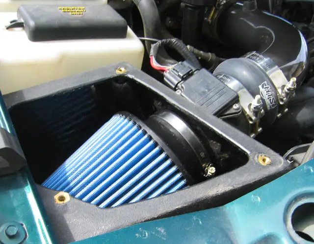

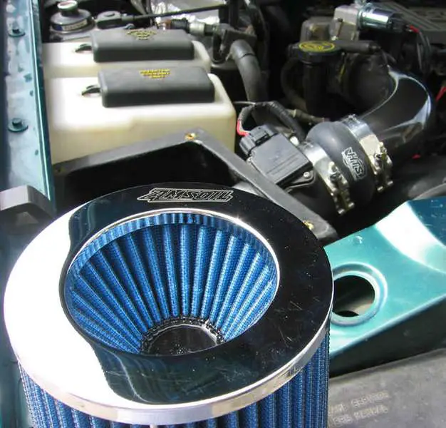

Use the materials you want, but I can't stress enough the importance of filters. I've used MAC, K&N, Green and the AFE filter that came with the Volant kit. By far my favourite (and current filter) are
Dead Link Removed. NO OIL! Just hit them with a shop vac from time to time.
Also, I find K&N to be very oily out of the box. Too much oil and you foul your MAF. The best "cloth and oil" filters I find are made by
Green, IMHO. Solid, well made and the optimal amount of oil out of the box.
