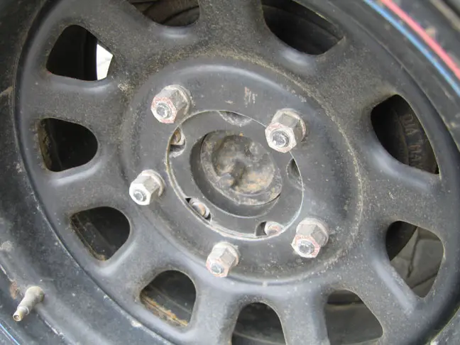

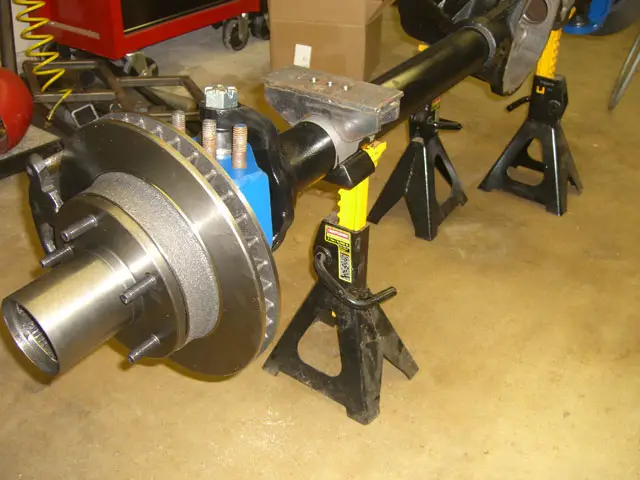

oh god, step away from the adapters. Ask spas about the hell she went through doing the same thing you are trying. She should of just listened to me in the first place, so let me save you the trouble. You have FSJ knuckles and outers now, which use the same bearing as ford does, and basically the same rotor minus the pattern. Get ford rotors, hubs and lockouts and put them on, now you're at 5 on 5.5 in the front. Get aftermarket shafts made for the 8.8 with a 5 on 5.5 pattern or get fullwidth 8.8 FSB/F-150 shafts and narrow them to explorer width. Redrill the drums, install and enjoy.
You now have one of the most popular rim patterns meaning rims will be cheaper and easier to find in styles you like and if you ever need a spare on the trail your much more likely to find a 5 on 5.5 one than 6 on 5.5
Dont believe me, heres the swap information for the front.
http://77cj.littlekeylime.com/flatop_knucles.html SCroll down about 3/4 the way to the section with Knuckles Out in red
