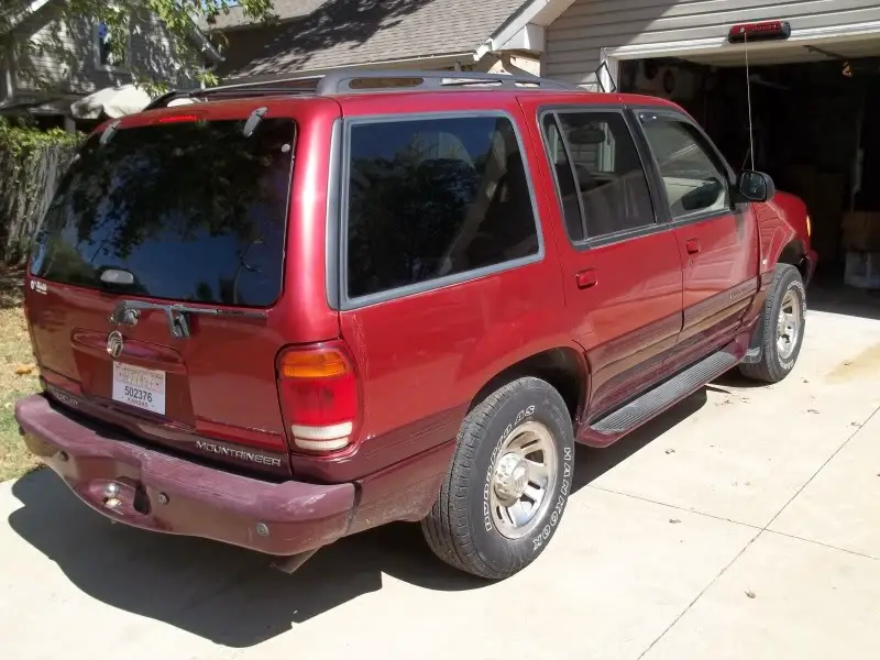

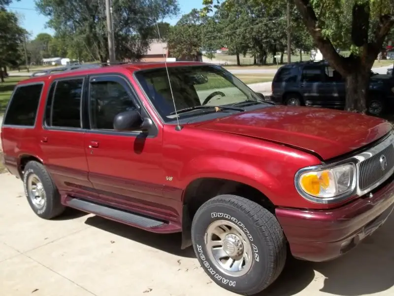

The new turd mobile. 2000 Mountaineer v8 awd.
The bad:

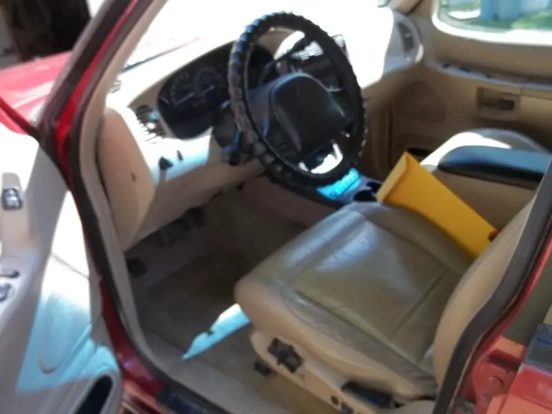

Was living it's prior life on a dusty road. Must tear out interior and deep clean.
Driver window off track "or something" and will not roll down. It tries but the rear part wants to stay up.
3 out of 4 door handles have issues. I have 4 new outer handles on order.
Cracked passenger side tail light housing. ( Ebay for some cool tail lights)
Compass-Thermometer thingy lit up and went out--idunno bout that yet
Door locks seem sticky, probably has to do with the handles.
It has a funky purple color trim with red metallic ( you'll have that every now and then) :(
The good
Gas tank was full

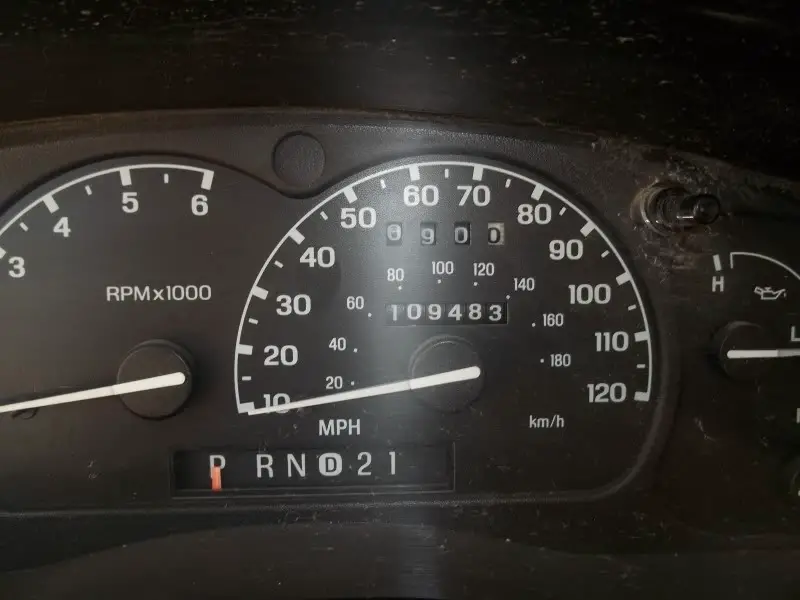

109k miles
I am the 2nd owner!!
Is from the local area, which means no salt!

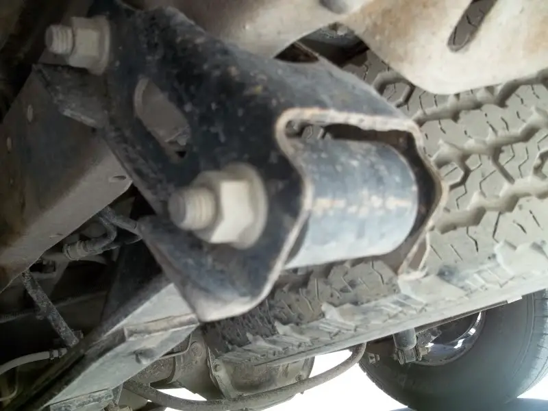

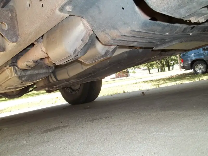

The undercarriage is fairly clean
No dents to underside panels
Good rubber
Camber shims already installed
Looks like good service records, all recalls were completed.
Clean carfax believe it or not.
The "maybe" bad
The original owner, told the dealership it had a bad "heater core" however I have run it for several cycles, over an hour each idling in the driveay and see no leaks.
However, there was evidence of a windshield leak or the like,I saw condensation on the inside of the windows this AM. The moisture smell is that of water only-no anti freeze smell. I am thinking it could also be a cowl drain which is clogged???? but she did say the passenger carpet got wet.
I tried to get heat, however it is an auto climate control. Being 90 degrees outside, I doubt it would have given me heat.The heater core hoses were hot, and the coolant bypass valve does operate. AC blows Ice cold.
Maybe she meant to say "heater door"???
Anyway--here are the pics.
My intent is to drive this and use it as a tow rig for a light weight off road toy. Mods will be minimal. Edit: This plan did not work out so on to plan "b"

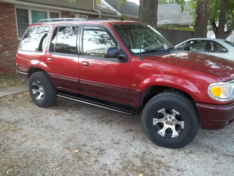

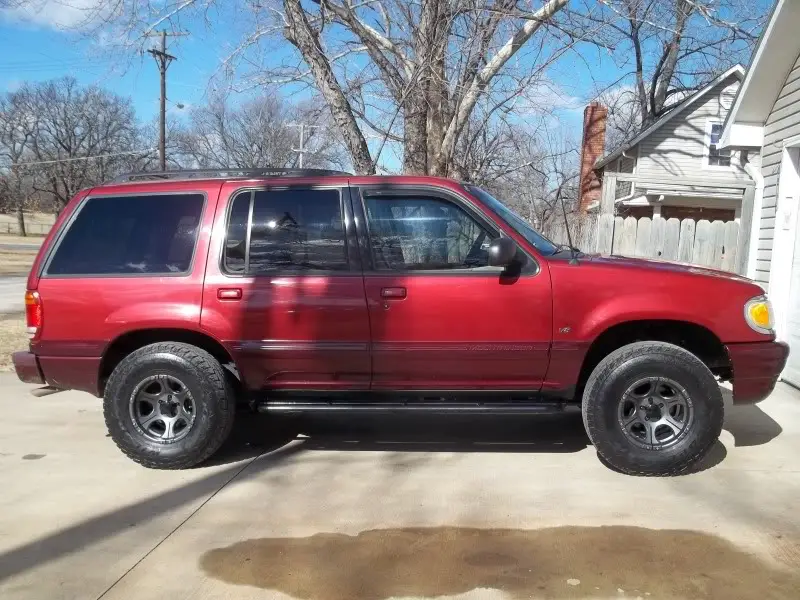

Current visual status
Progress pictures
Now, let's clean it up a little
Herculine'rd rocker panels. Rock sliders installed

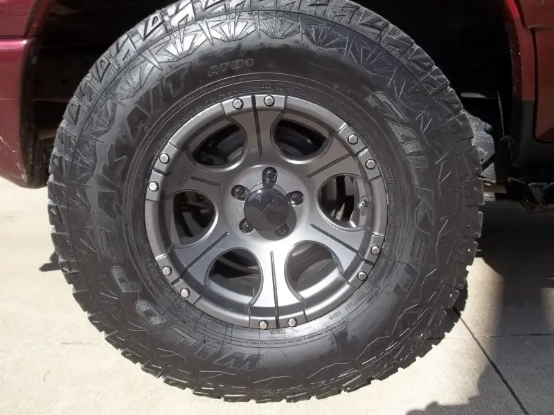

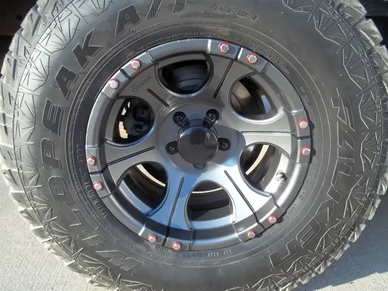

Changed "color scheme" of the Dick Cepek DC1 wheels. New Falken Wildpeak AT 31x1050x15
Then I decided Maroon washer on the wheels would look better

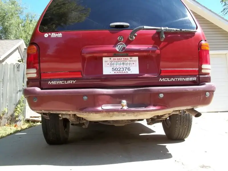

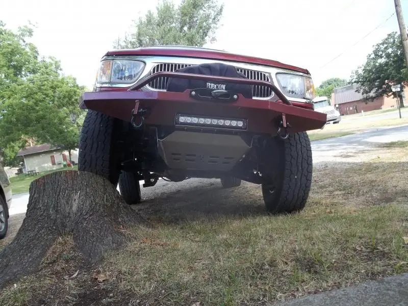

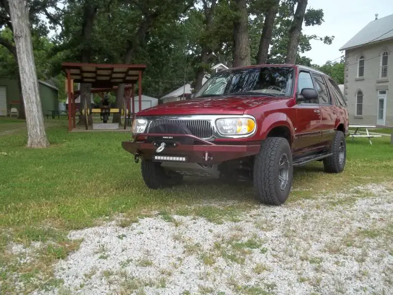

New bumpers, winch and Pro LED light . Front Bumper from RLC, Skid plate from RCI, rear bumper from Kert307

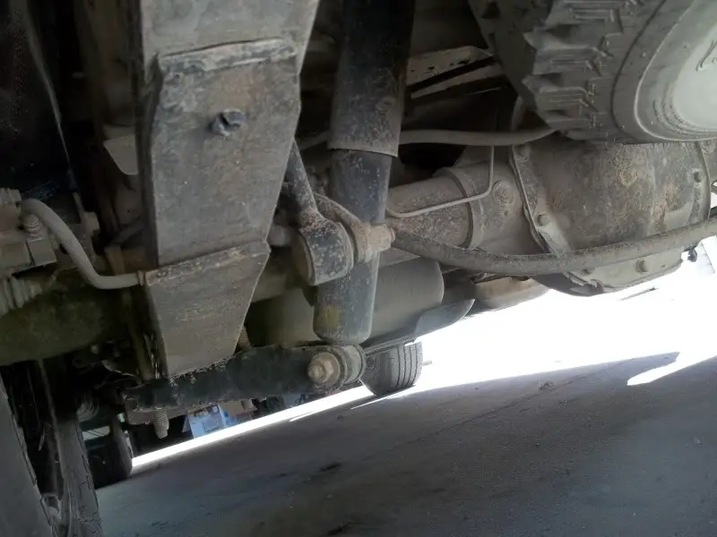

Rear anti sway disconnects

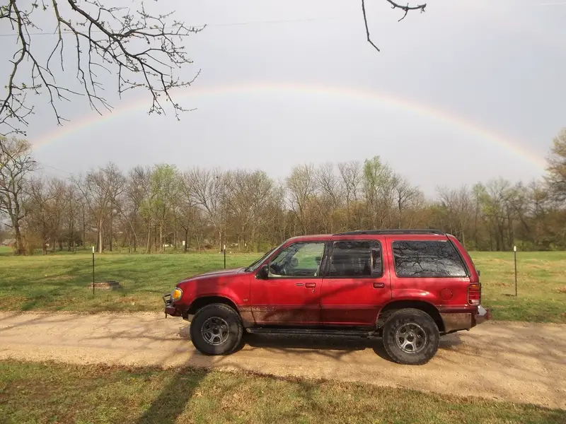

Found another rainbow in Kansas.

The rear bumper is already metal just has the backup sensors in it.

I think I am going to paint the front bumper, and the side trims with some gray tinted herculiner. I'll powdercoat the rear bumper and try to get a gray pad for it. I'll throw those smoked chrome mounty wheels on it and call it good.

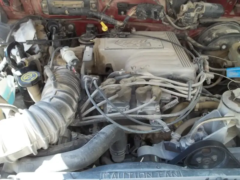

I removed a dirty K&N air filter, stuck a clean paper one back in. Threw some seafoam in the oil and gas tank, idled it for an hour then changed the oil and filter with some Quaker state. I will run this for a few days and change again with mobil 1 synthetic. I will change the spark plugs and Fuel filter tomorrow.
Still no coolant smell or leaks-the cat converters are not getting any drips either.
