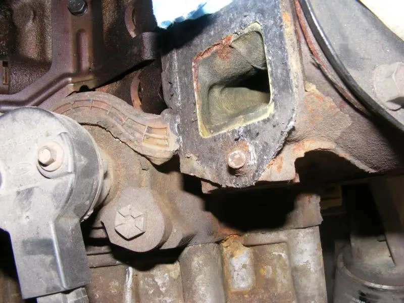

Did a few things to the replacement engine today. Pulled the old water pump, scraped some gaskets and encountered a broken intake bolt in the bank 2 cylinder head. I will attack it shortly. Not dead yet:D

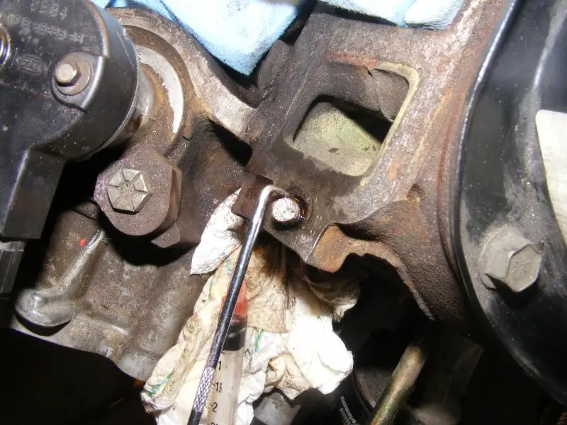

Let's attack this stupid broken intake manifold bolt.
I cleaned out the "hole" area with a wire brush and dentist pick
And am treating it with alternating heat to the surrounding head material, and drops of acetone mixed with trans fluid from a syringe

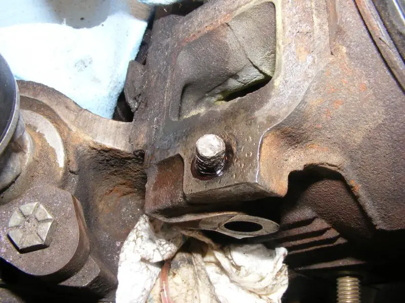

After a few of these cycles I think I am going to weld another bolt to the remaining stud

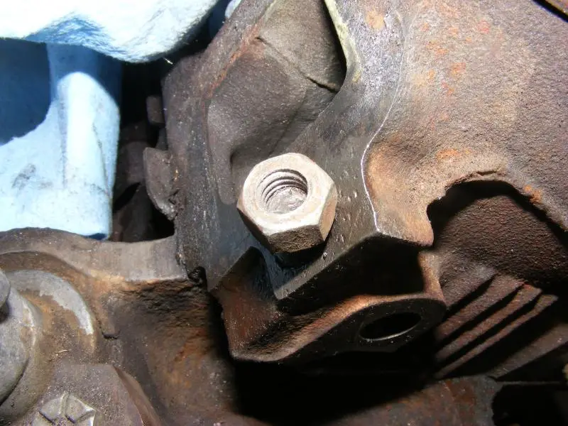

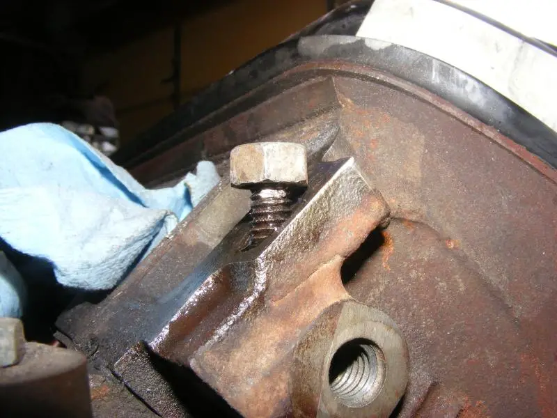

I tried dry fitting a nut on, however there doesn't appear to be enough stud for this to work. In order to get the nut down far enough it will run into the head when turned-as the surface has a steep angle.
Another thing I was told by a machinist, was I will have the best luck with a cold bolt and hot hole. Cold makes metal shrink, (bolt) heat makes metal expand (hole). So, after welding the bolt on, it should cool , then apply heat to the head material around the hole.

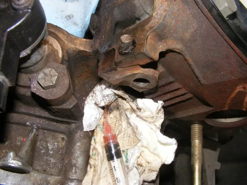

Oh, this hole does go all the way through so I applied some of the acetone mix from beneath also.

Do you suppose, if welding skills allow it, I can plug weld it from the top, then a small bead (1/3 around) from underneath the nut also?
I've welded nuts onto bolts that were broken flush and got them out. It took 4 tries on the flush broken bolt but I just welded it from the inside, built it up and made it one with the nut. I used my miller 135 gmaw with the hood taken off the tip set a max amperage (like I"d set it for 3/8 metal). The hardest part was getting the nut almost centered over the bolt. Since the head was Cast (was working on an Izuzu NPR) the weld didn't stick to the head, just the bolt and nut.
I've also done this on bolts sticking out and I did the the same way.. Weld only from the inside and try to melt the bolt/nut together all the way up.
Since I've only done it 3 times total (all within the last few years) It must not be that hard since I got it to work... Well it took 3+ times on each one, but I got it.
You can grind the bottom nut corners a bit and get the nut to go on at least one more thread, before the welding.
