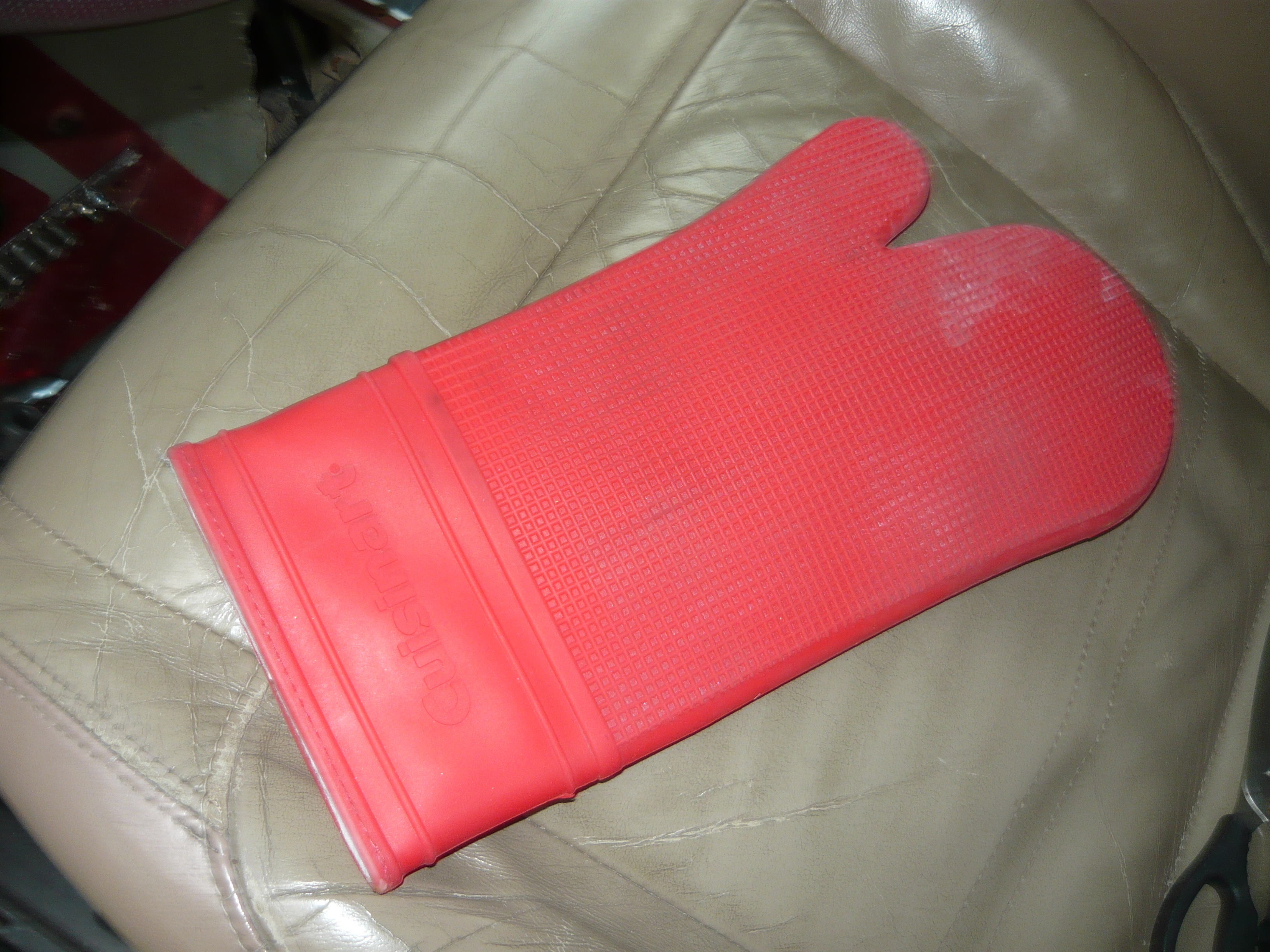

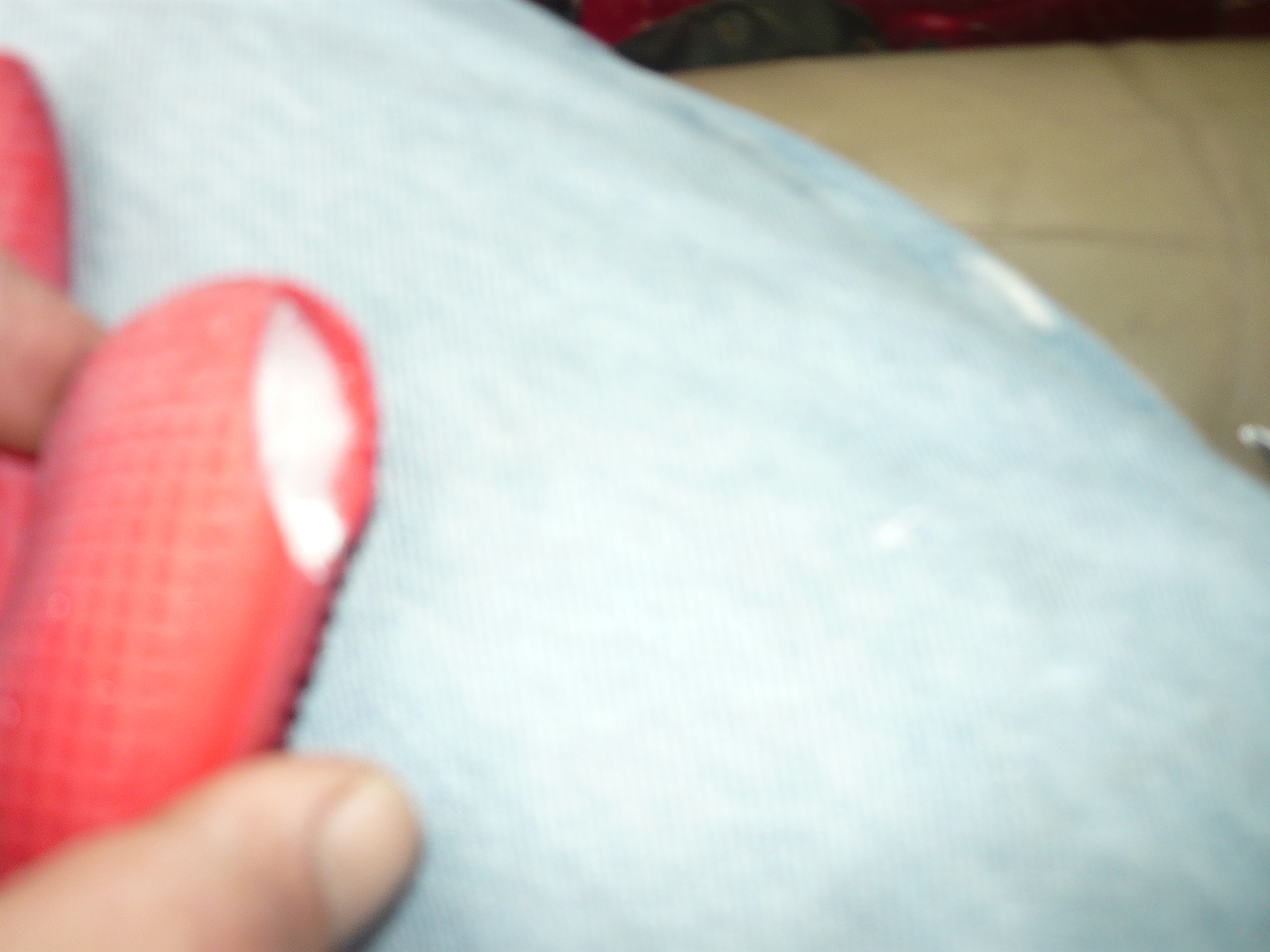

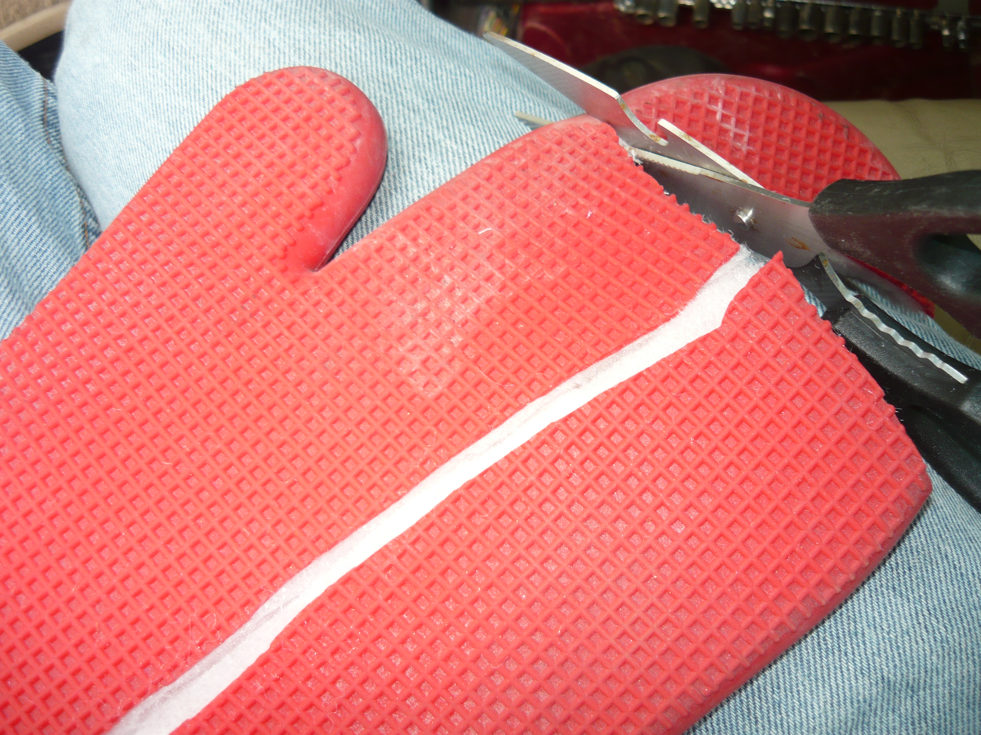

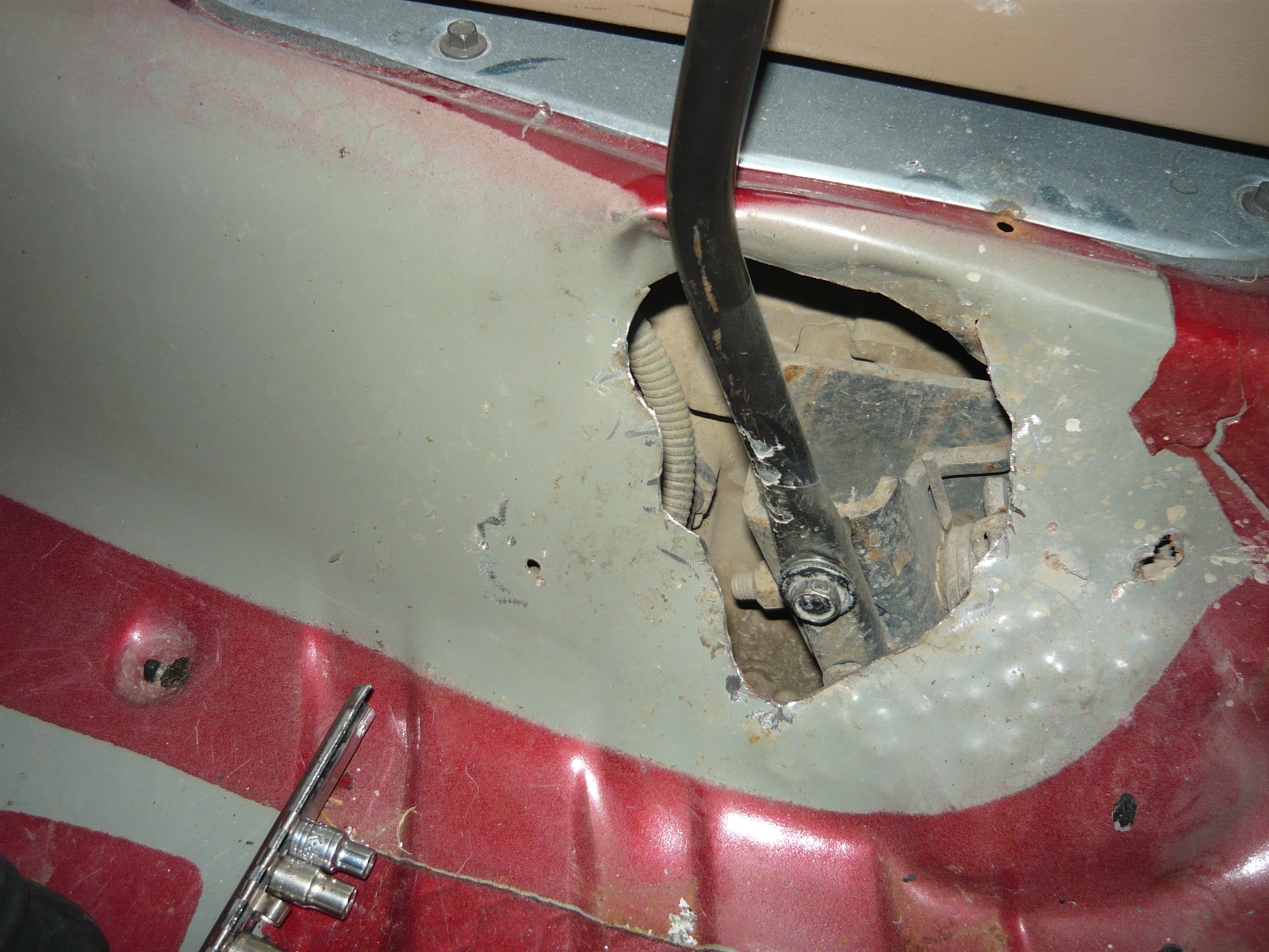

So I got this hole. sound and rodents can get in even with the carpet, bottom boot, and trim boot installed.

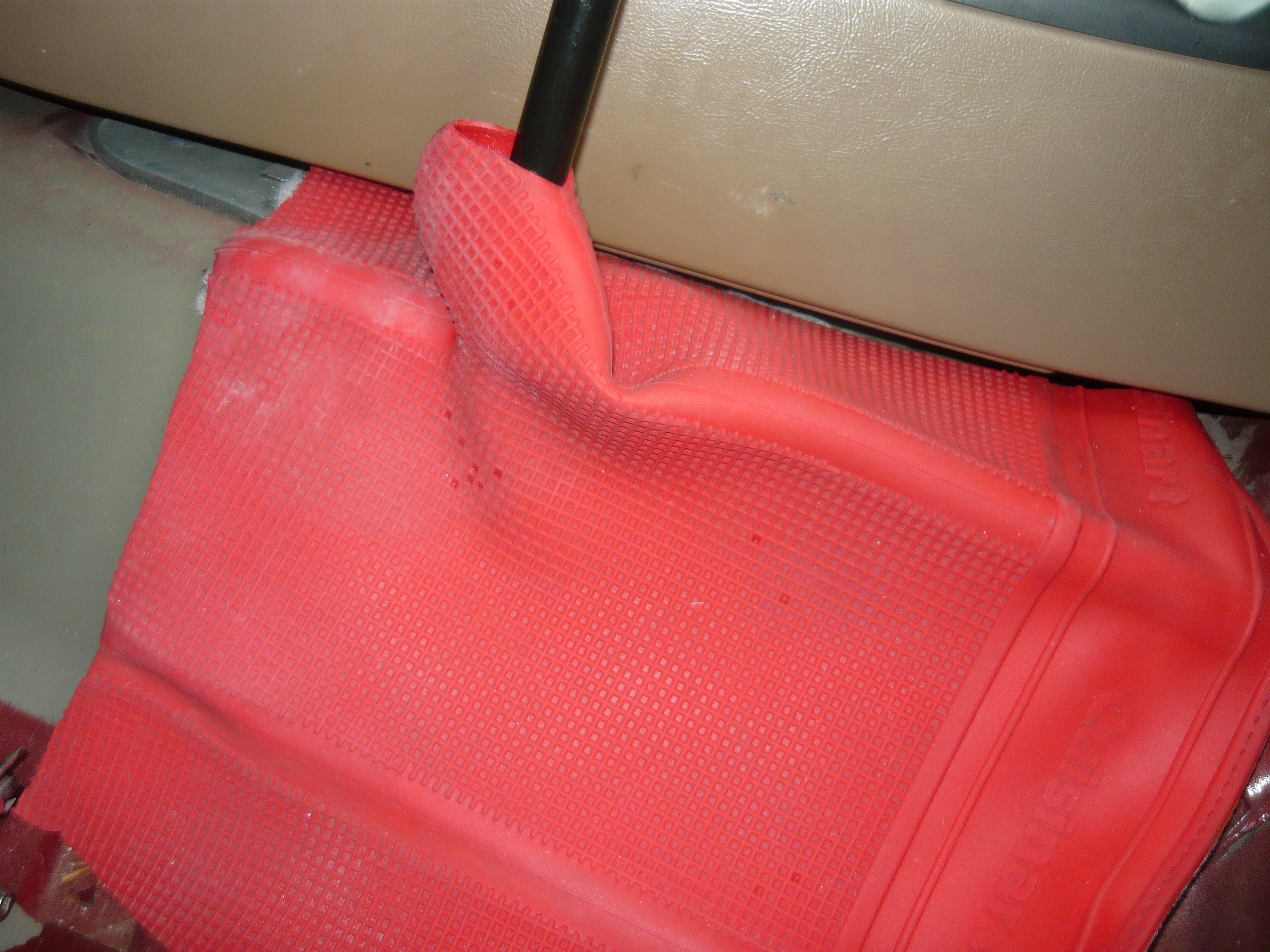

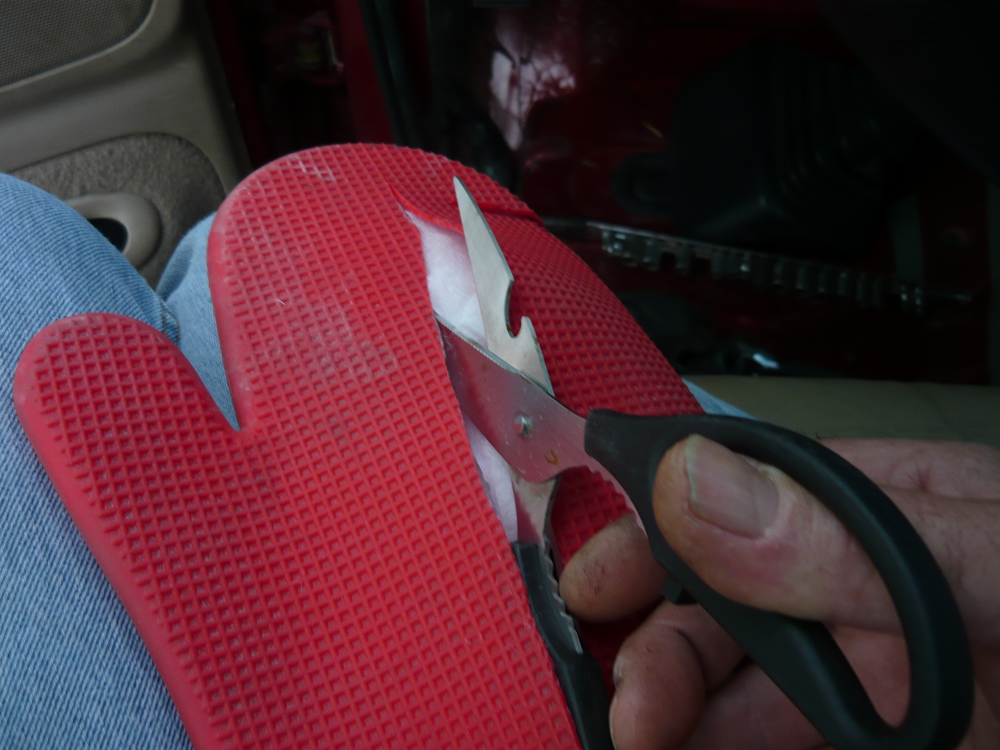

I also got a silicone oven mitt.
Hmmm.
Just need to screw or rivet it down, the lower boot and carpet will hold it also.
Hmmm.

If you have rodents coming in(mice I presume), they will keep going through there, until you erase their scent from the entire area, and have a very good barrier.
I'd find the best odor cleaning chemical, and spray/scrub that on thoroughly, around the hole underneath, and inside. The mice, like ants, trace their old paths by smell, which leads them back to the hole.
I think that kind of cover can work(help), but it may need to be doubled, placed on the underside as well. I'd try some leather or rubber also as an outer layer(with bigger holes than the glove material), plus the gloves inside.
Good luck, I've seen mice eat through cement sealant(fills holes in cement). We had mice coming in along an underground water pipe, sealing the hole around the pipe didn't stop them. Poison took care of it slowly, but they were not stopped from getting inside. Try to erase their scent trails.

I know what ya meant as you told me that story and your just prepping for future trips.
But... I stuff holes with sos pads before sealing them up. They chew it, and croak. Might not be a good deal on a rig, as it might promote rust, but for the home, yeah, works like a charm.

I have a 100% kevlar oven mitt which I also never use, I might lay it down first. Kevlar will challenge the little bastages.
Main goal is sound deadening. A lot of sound comes up through there.

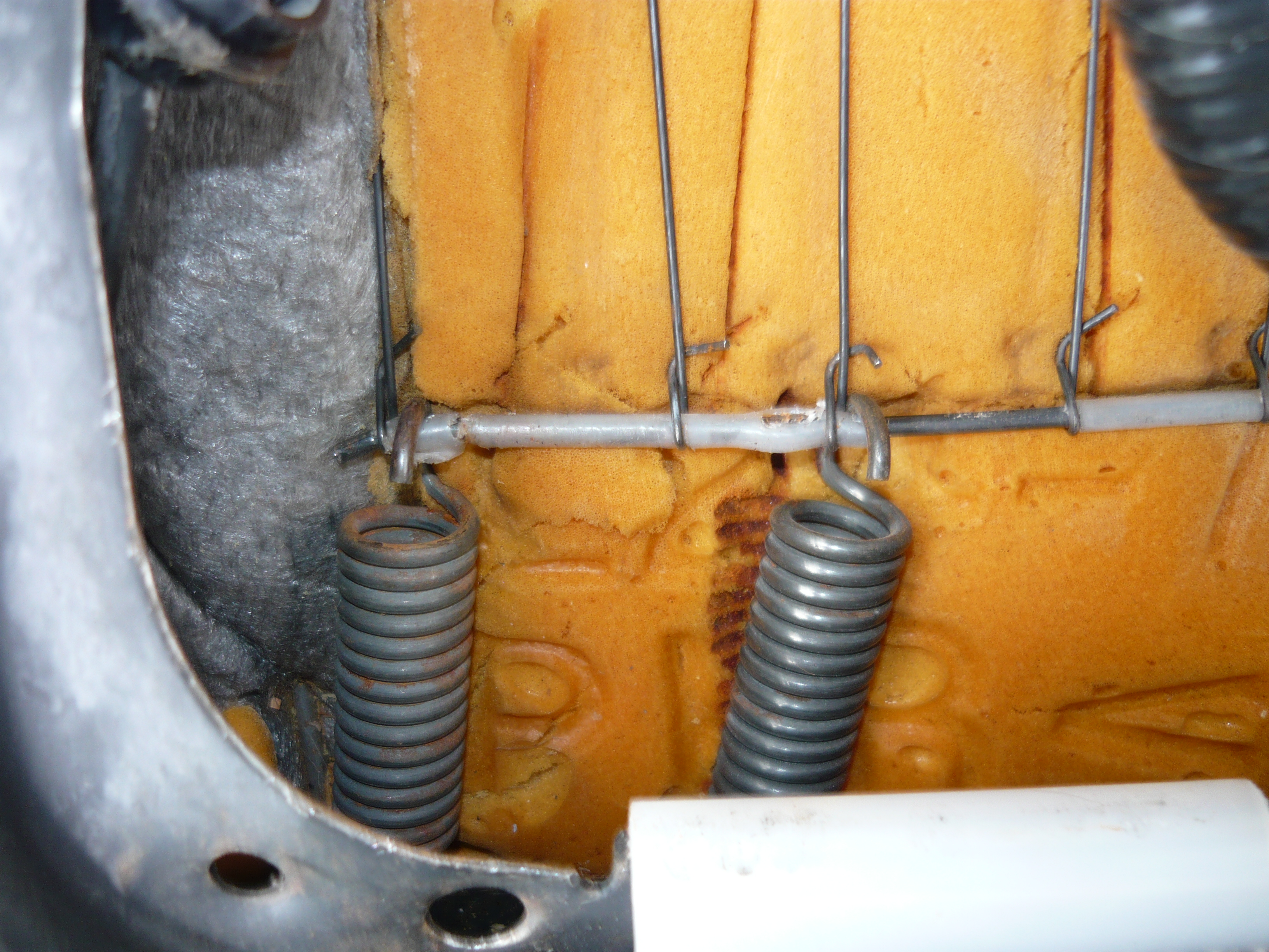

That being said, I think I found a good temporary fix to the sagging seat.
Betty let her load shift. Both front seat riders were riding in a shifted hip position. not noticable until you do it for a while and wonder why you can't walk for a while after getting out of the seats. I can go about 1-maybe 2 hours before i just have to get out and walk around for about 5 minutes. My spine is fubr with a d

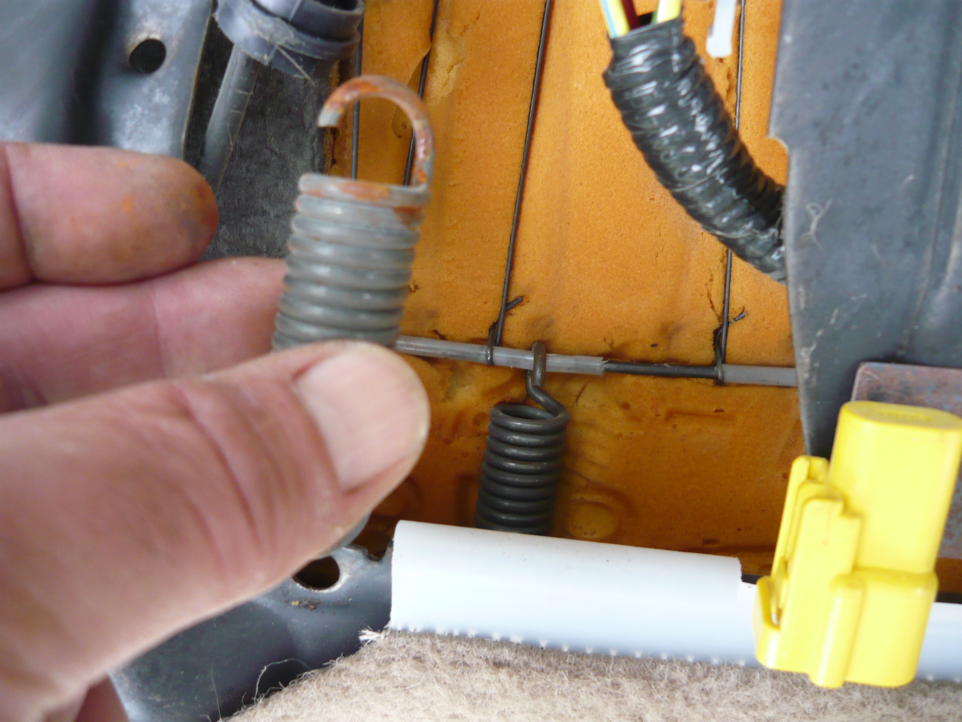

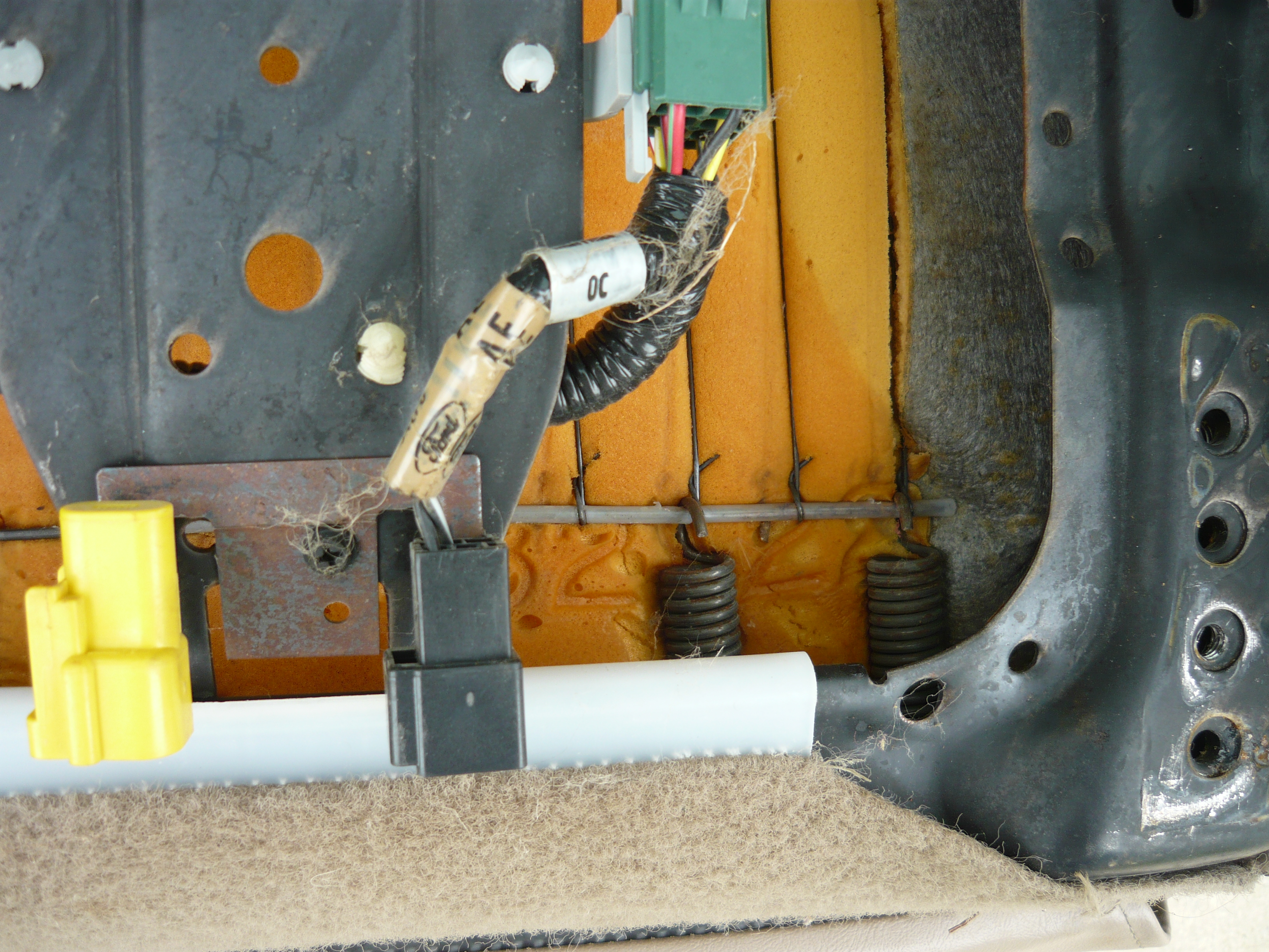

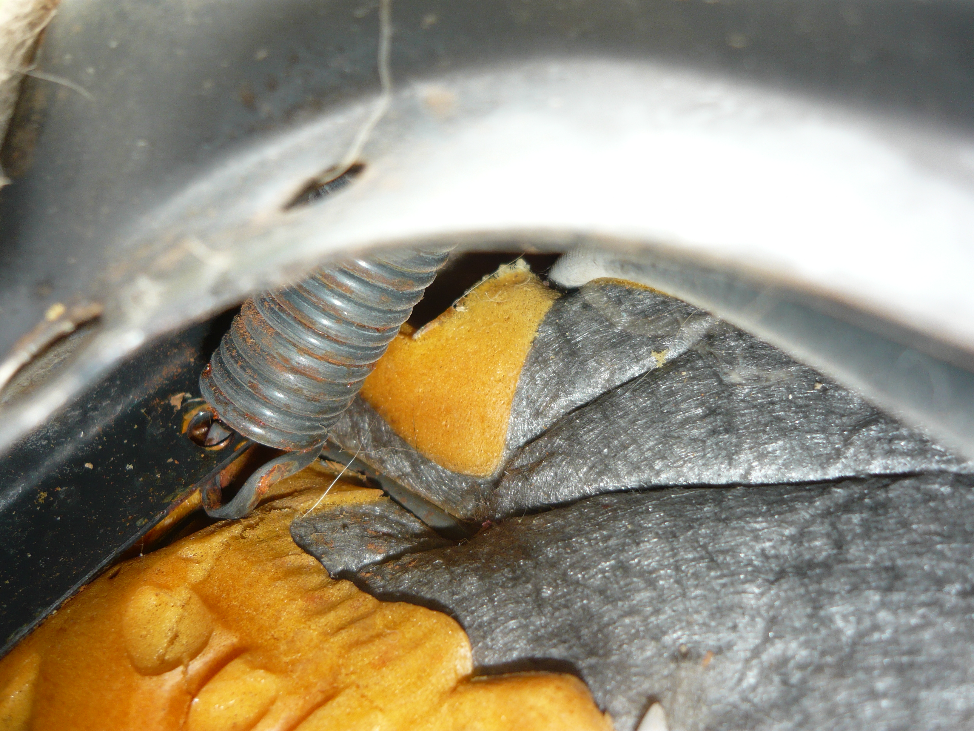

I am in the middle of putting the interior in so I distracted myself by removeing the driver seat base. Here is what I found

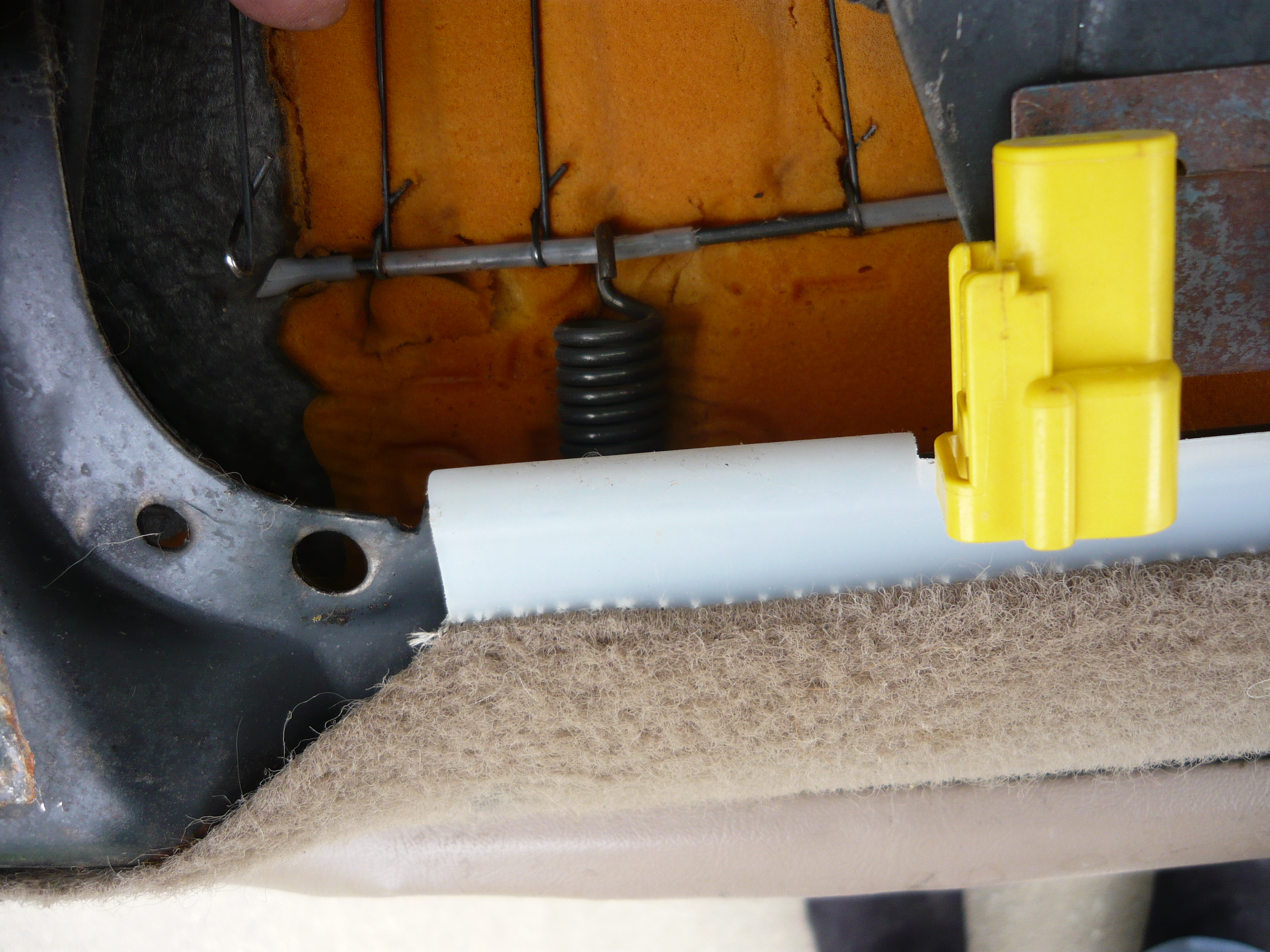

oopsie, one doesn't look like the other
A friggin slacker spring!
I put a tiny downward bend to the bolster rod so the wire would stay put and retain the spring ^^^^^
Then I ran a chunk of old rear floor mat under the wires, carpeted side toward foam, to keep them from cutting into the foam. Zip tie to put sideways tension on the wires as the rope was broken
Passenger seat was the same, so, I did the same to it. Hope it works for a while at least.
