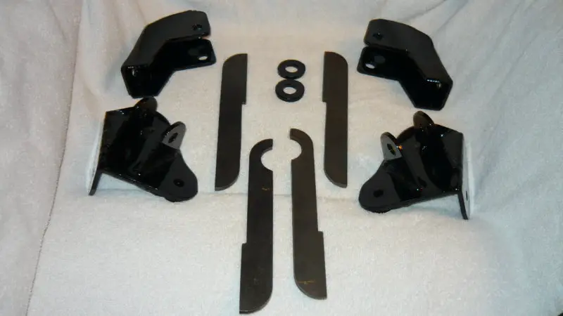

Today the ultra cool coilover conversion brackets made by @RockRanger finally made the trip through the blasting cabinet, then the dishwasher, then the oven for high temp pre heat and dry. Then, a trip through the dust bowl and back into the oven.
Powder Coated Mirror Black
Included were 2 spacers which I assume go into the shock tower center support. Also, some very nice support gussets. These have to stay bare for welding, then paint.

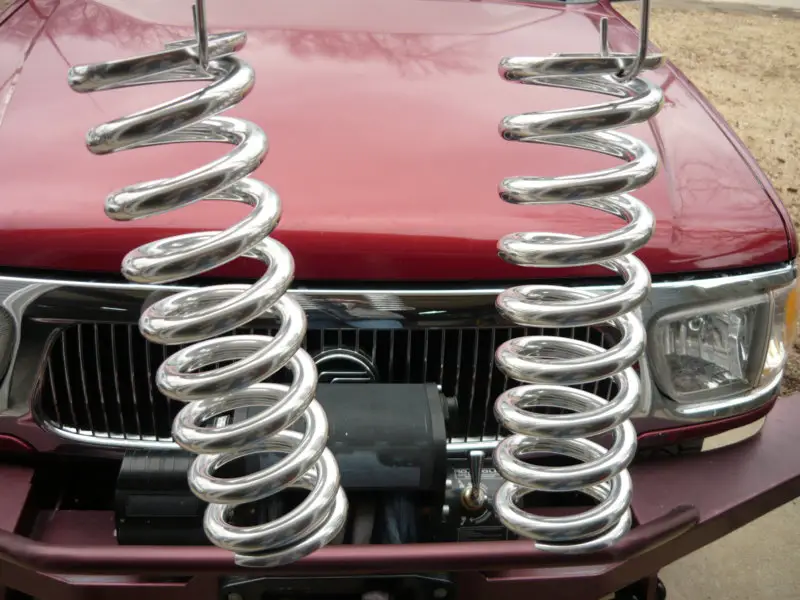

Then a base coat of chrome. Man, I wish I could leave these as is. They are cooling now for the top coat surprise.
I love that chrome finish. I have a hard time thinking of anything to finish in chrome, on the chassis or under hood. The old cars people went overboard with chrome ruined the look for me. I like it, but it must be tasteful and sparingly done. I prefer attractive colors, and the more modern special affect finishes etc(also done sparingly).
You're going to help me and a lot of people, with the pictures you post of your various chassis parts. I love that grey(with a tinge of black in it) you did my accessory brackets in. I see that working well for many chassis pieces, with plenty of black, and a tad of color here and there.
HEY! remember i was talking about getting the snout powdercoated flat black? that chrome is a very possibility as well!

I dig those tower gussets Matt made!

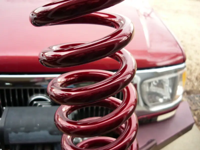

Anyway, since you said I had to coat them with the shaded cherry, well, here they are.
Tim, the chrome powder coat has to be cleared in some fashion, I do not think you would like the result of a plain clear.
Those look awesome!!
But, sorry, they are 650#.:(
I have only ever bought one set of 750#, and am using them now. The #'s stamped on them might have been worn, and hard to read.
Someone with a 4.0L might want to buy them, for that killer custom color finish.
