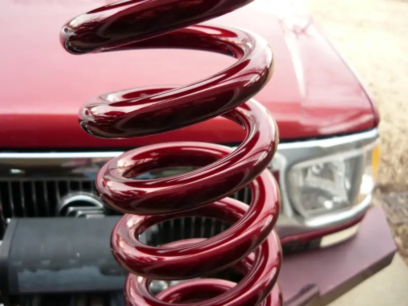

Anyway, since you said I had to coat them with the shaded cherry, well, here they are.
View attachment 166206 View attachment 166207
Tim, the chrome powder coat has to be cleared in some fashion, I do not think you would like the result of a plain clear.

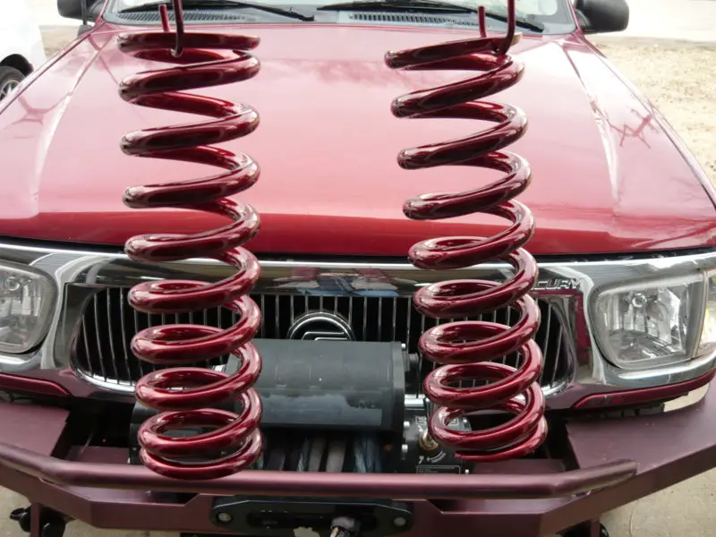

As for spring rate, as a reference, my Tacoma has 600 lb springs currently. I am going to swap to 700 lb when I install the winch and bumper.
My Ranger with the V8 is still running the original Rancho lift springs - I have no idea what their spring rate is.
Oh yes, love those, that color is awesome to me.
looks great, wish you were closer to me :) My green XLT has allot of parts that need finishing :)

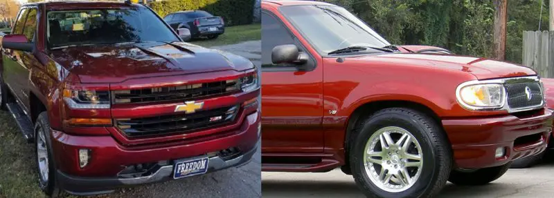

Oh yes, I realize how many variances there are in colors. I was browsing for a long time to decide on a combination of reds to replace the Toreador Red. I'm sure the powder coat choices are even much greater than typical paints.
That color you came up with I appreciate for the real pictures showing the true color result. Paint swatches in books or little pictures don't help nearly as much.
I still need to decide on a bottom color, the Dark Toreador Red seems like it has almost purple in it. The closest contrasting color I like is a GM dark red on 2016+ pickups. I'm not sure it will be dark enough, for that I just want an OEM base/clear paint to use. I still might have to mix the old base with the new color, but a stock simple base color would be best.

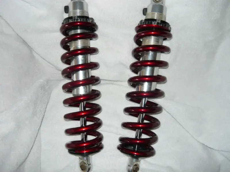

Those look fabulous! You know if you have coils and Gman has coils you know who's surely to follow!
Those springs came out great :thumbsup:
Makes me want to redo my TRD springs, but who knows if I'll ever reuse them since I have TEIN coilovers :dunno:
