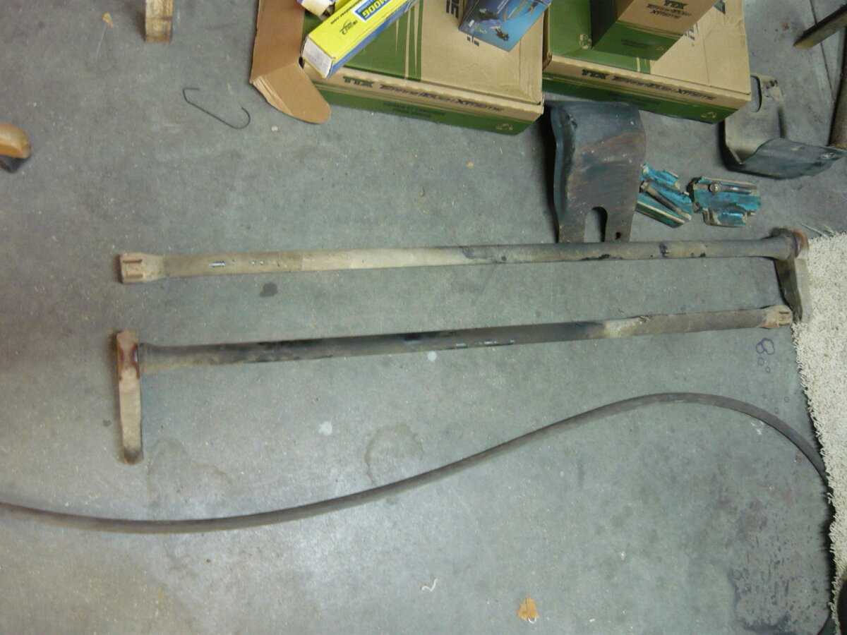

So, back at that Moab place I hit the cowguard dealio too fast going off it , and wiped the torsion bracket skid plates, bent one of the adjuster bolts, and also the crossmember
I hope that isn't too much of an issue because it's been that way for quite a while.
oh yeah, bars off

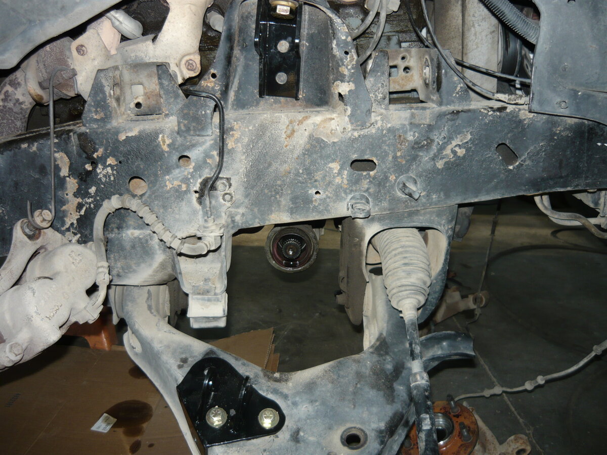

IFS goals VS IFS reality
no t bars, shocks or swaybar to limit travel. passenger side full droop , driver side arm on bottle jack with fully compressed bump stop. (need bigger tires to droop or stuff will drag)

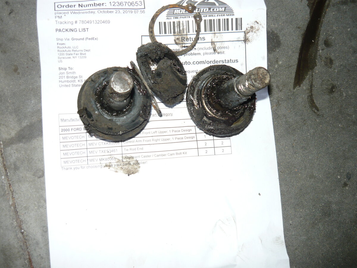

I have the spindles on the floor, lower ball joints pressed out. Moving so sloooowww
old passenger side upper. Still hanging in there but making a mess due to the need for excess greasing
Put a bigass Channel lock pliers on TRE's, and squeeze them gently to see if they move/compress at all. New or good TRE's will be very tight and not compress.
My sister's 2007 Jeep Unlimited had a death wobble for a year or so, and the two places she went to couldn't keep it from coming back. I got at it and slowly replaced parts. The other places missed four bad BJ's, and the new track bar installed at the beginning was the new problem(it wore out within a year). I did the TRE's and BJ's first, then bolts and the steering pitman arm. After that I realized the new TRE's were bad(the two outers very much), and did the track bar again with new CA bushings. The track bar was evidently not tight enough with the OEM metric bolts(factory holes too big). New aftermarket bolt kits solve that, but new damage you have to find again and replace etc.
My sister's issue wasn't the TRE's, but the new ones were wiped out quickly with the DW at normal speeds. They didn't feel really bad by hand, but they deflected(crushed) easily with a minor force of the Channel locks.
With a lot of age and miles, TRE's are suspect for sure. I used the TTX type of TRE's on my trucks, they were not bad from Rock Auto, and they seem tougher than OEM.
