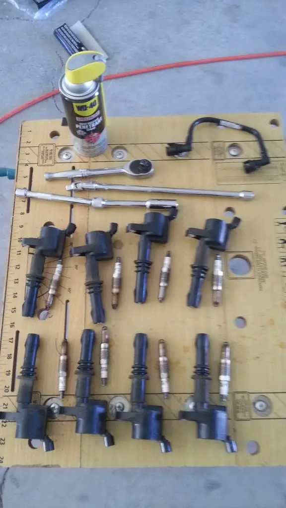

So I am half way Thor gh the plug change and I swear I'm gonna have a heart attack! Never in my life have I been nervous about changing spark plugs! LOL. So far have 1, 3, 8 & 6 out. Others are being stubbord so I'm letting them soak a little. I did notice the dealer changed the plug on 6 with the updated version. They neber pulled 1 / 3 which they said were bad. Wonder how they determined that? I'm wondering why they changed the plug on 6 still since they claim "plugs not covered".?? Wish me further luck!

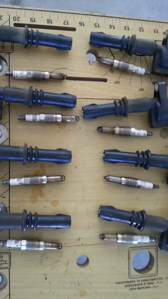

Success! All 8 out, none broke!! Geez what a nightmare! Not a drop of antiseez on any of the plugs except 6 which the dealer swapped. I can't believe how bad these plugs look! That's after wiping them off! Looks like every 20k i'm changing them.
So I checked and the fuel filter was done @ 60K. I have to say I probably should have changedthe plugs 20K miles ago! This thing runs like a race car now!
Here are some pics of what I pulled out. Just glad its done. Time for a beer!
Congrats! And, thanks for the updates, which seem sort of rare around here.
I know exactly what you mean about the heart attack. When I had one come out without the porcelain, my heart stopped! Stomach started churning, with visions of pulling a head in the back of my mind. You're right, it never should have to be that way. And, thank GOD for the Lisle Broken Plug Remover!
GREAT!!!! i cant tell you how many i have had to fix for customers. i work at a ford dealer here in virginia. the best way I have found to do the plugs is to run the car just long enough to heat the plugs but not make it to hot to work on. and run down one side with a 3/8 impact gun to remove them. put it back together and them do the same thing on the other side. i can recall only breaking one plug in the dozens of these 3v motors i have done this way. but not everyone likes this way :D
Congrats! I broke 5 of 8 when doing mine following the TSB, but all easily removed with the Lisle Tool (greatest tool ever). Can probably do these in my sleep now! You'll appreciate the better, smoother running of the motor now. I ended up getting MSD COPs from Summit. I trust MSD for ignition parts way more than most OEM and definitely more than Motorcraft... and a little cheaper, too!
