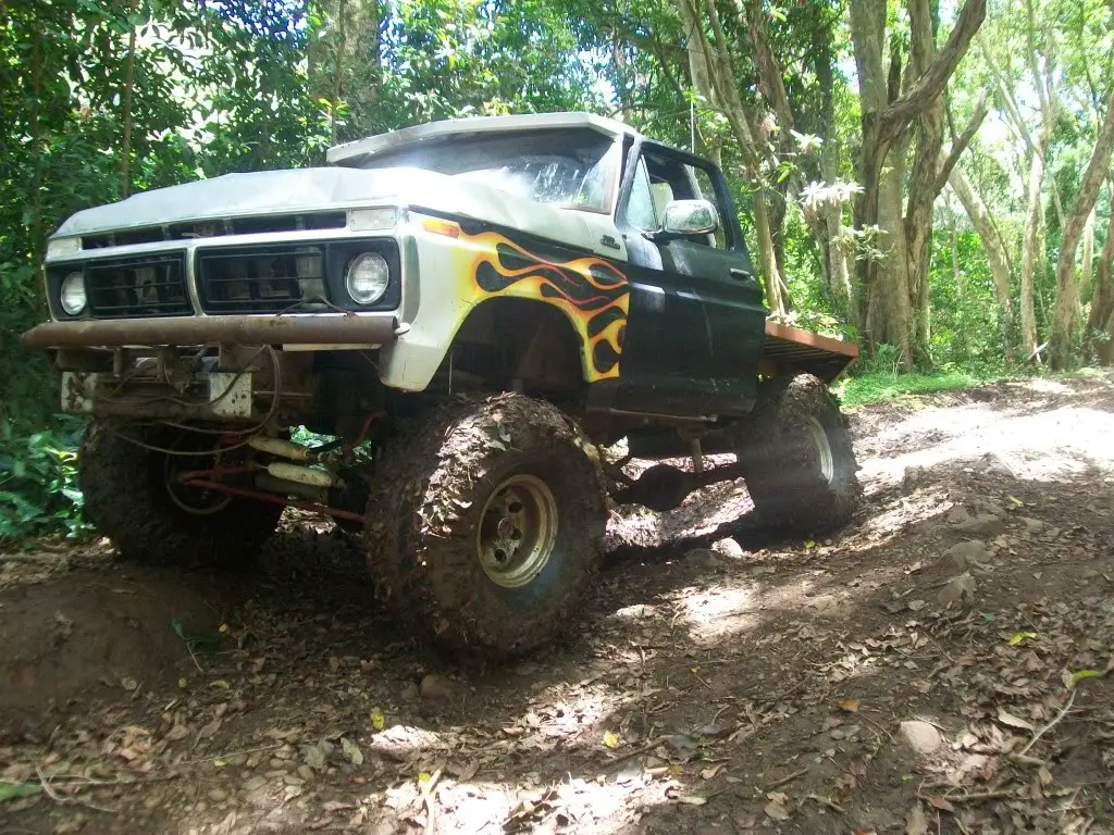

ok now I sold the cab of the truck do to an offer i couldnt turn down
the truck has
a dyno'd 600hp big block 460
c6 auto with level 2 shift kit
np205 transfer case
9inch rear with 4:11 gears and a yukon chromoly spool
danna 44 front with 4:11 gears and yukon chromoly axle shafts
38.5x16x15 mt claws
15x10n mt alcoas

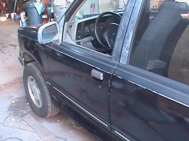

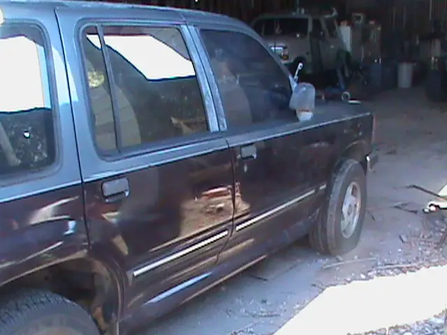

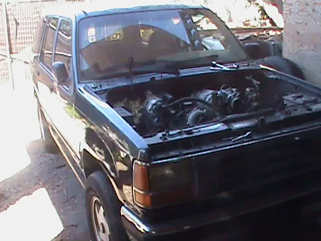

UP FIRST was finding a body how about a bone stock 93 explorer for 300
the explorer hadnt been regesterd in 7 years

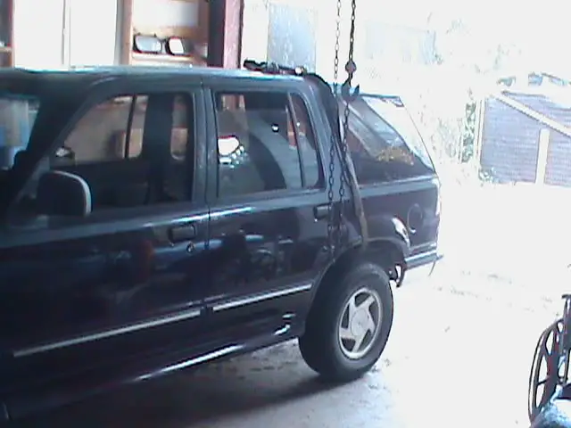

ok so now do i transfer every thing over nah cab swap

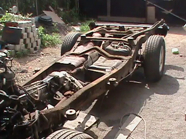

ok the 79 frame is longer but the wheel base is the same
here are some pics of the 1st day
some more from day one
as you can c the fram is longer

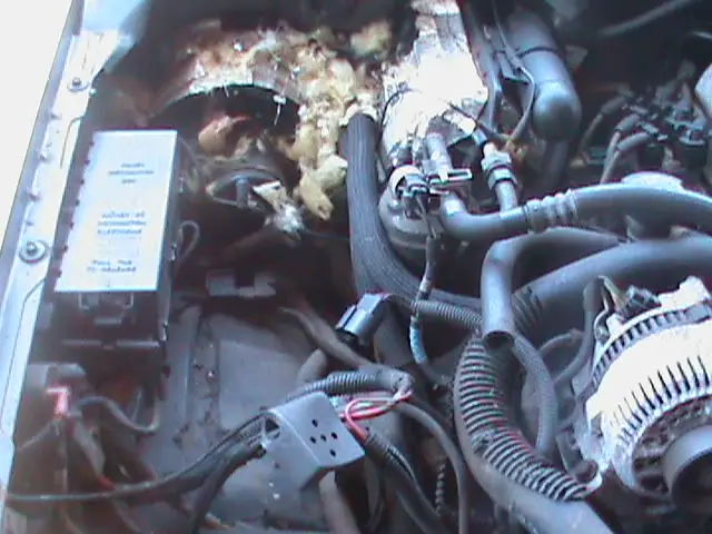

the biggest problem i found ws the frames are opposit. the explorer is higher in the front than the 79 f150

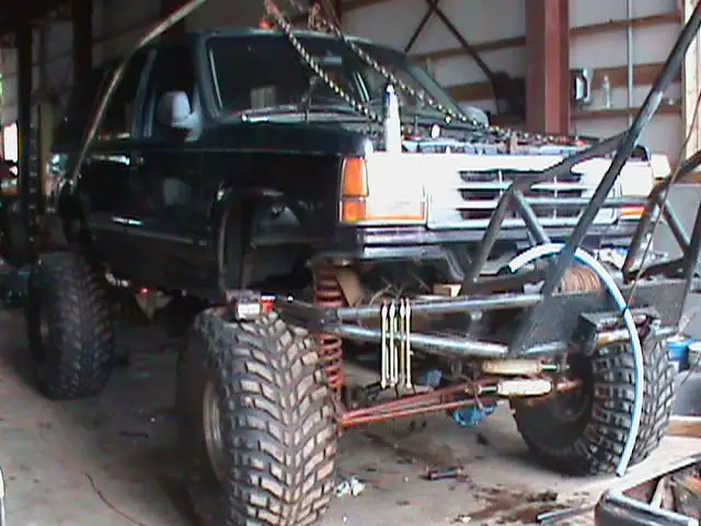

day two
shorten frame

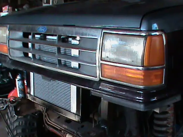

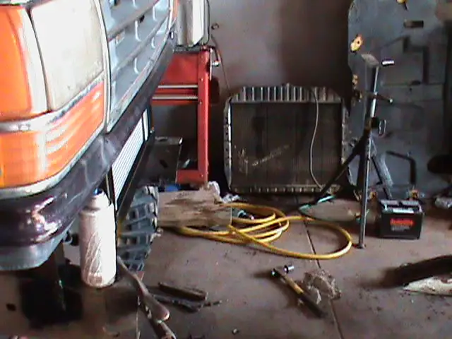

figur out radiator
figur out body mounts

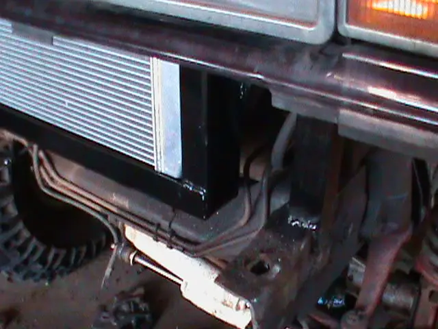

i cut off the front and back
then cut out the bottum of the core suport for the new griffen radiator
end of day two

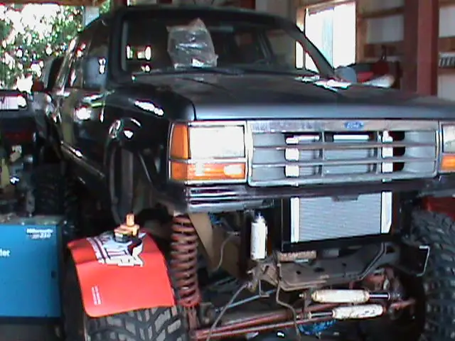

6 of 10 body mounts done
radiator in frame shortend
hood back on

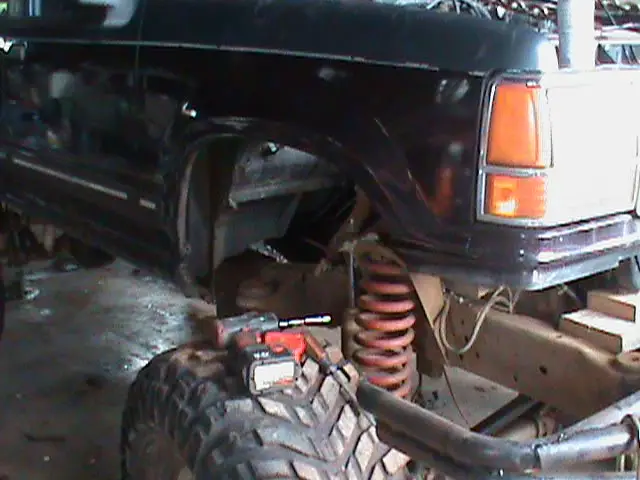

custom fender exit headers and new exhaust
you can put filler plates in between the front radiator frame and the front body mount extention to help brace it.

time for a recap and some build plans
1993 ford ecplorer xlt 4 door
600hp 460 big block
c6 trans levil 2 shift kit
np205
ford 9inch with spool
danna 44 welded diff chromoly shafts
4:11 gears
griffin radiator
the plans
finish body mounts
build 2inch custom fender well exit headers
build custom long arms front and back
convert ear to coil
put iner fender wells back in

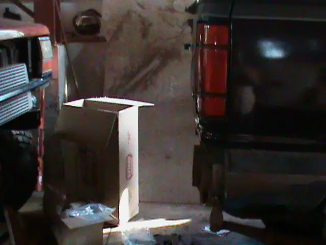

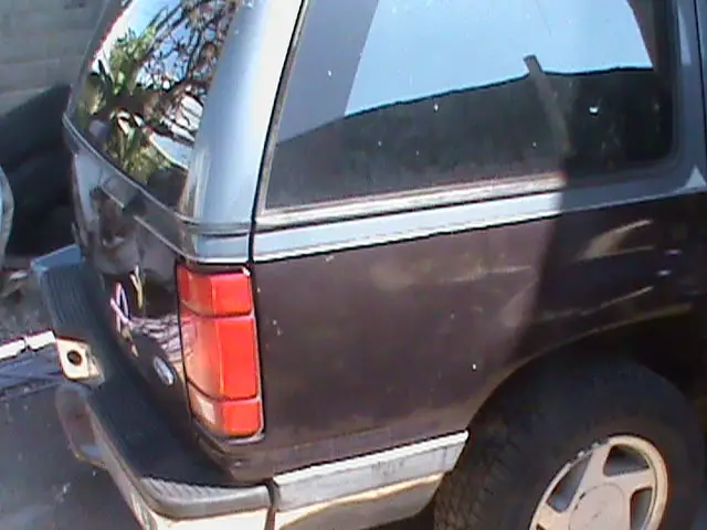

cut off the back and wall it in
mount the 24000 pound ramsey winch back on the front with custom bumper
mount 8000 pount waen on back with custom bumper
the radiator is ahead of the mounts but i was ganna figur out somethin

also has any one cut the back off one of these and walled it i would like to see some photos before i wack into mine.I'v seen it done to the b2 a million times, I plan'd on using the back of a ranger cab
