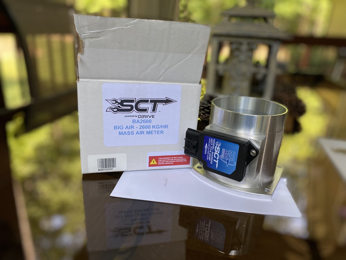

SCT BA-2600 90mm MAF Meter with Aluminum Housing

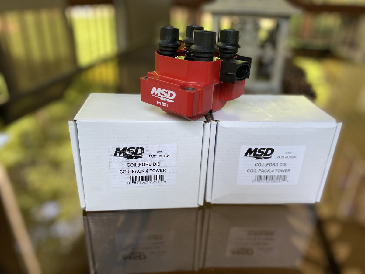

FYI, I would say avoid the Accel coil packs. I had two new ones on my Mercury and developed a miss a year later. The coils were the last thing I got to checking, and it turned out one was bad. I only had about 6000 miles on them, and they were under two years old. I put the OEM coils back on and they were fine. So I've put Accel on my black list, that was expensive for poor quality parts. I would now prefer OEM, MSD, or Screamin Demon if they still make them. They are the same coils as all modular engine coils.

Noted about the Accel. I'll run this by who I am working with on the install.

Ok - changed the coils to (x2)
MSD Ford DIS 4 Tower Coil Pack
Part #8241
Thanks for the heads up Don!

Lasoda had me put the factory coils back on said they were the best
The $$ are on the shelf
Sucks but....

Lasoda is my tuner
No problems just his rules
I confirmed with him he likes factory ford coils idk why
You're v8 application may be different

The OEM coils are very good, there isn't much to gain any longer with aftermarket coils like 30+ years ago. I was changing mine for simple age and maintenance, that didn't work.

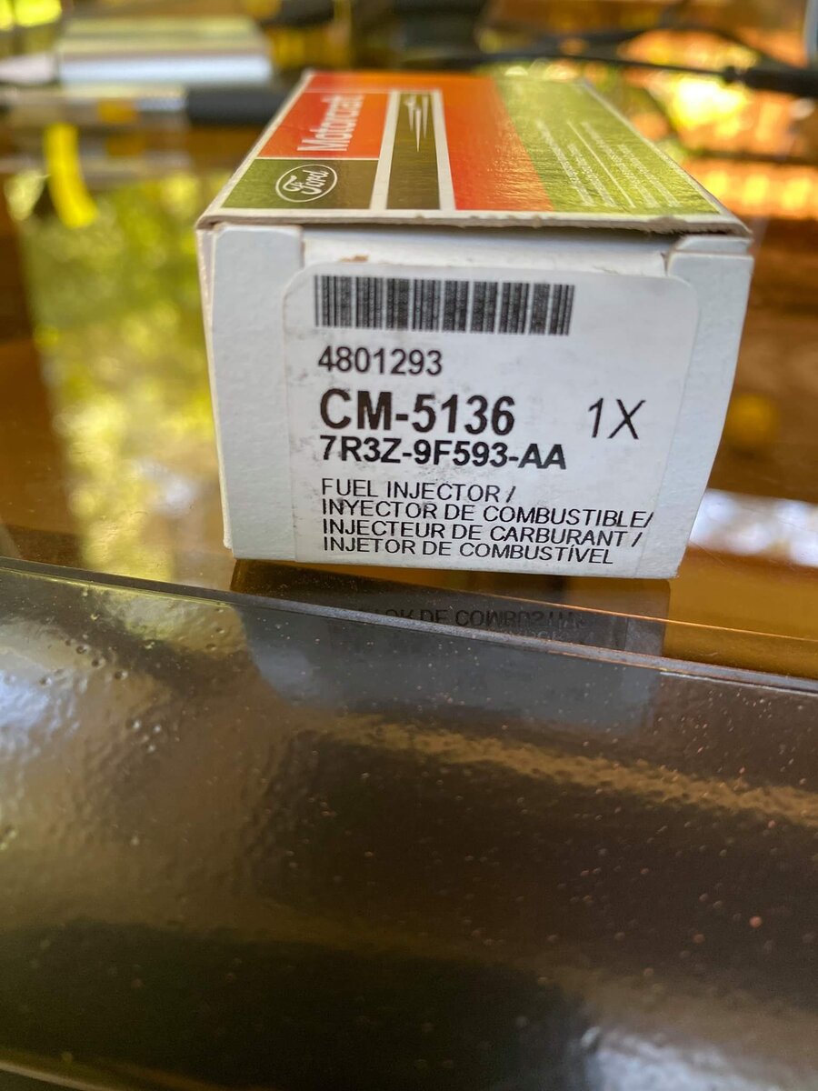

So received injectors (8x) today. Apparently they are the same used in the 2007 - 2010 GT500
CM-5136 7R3Z-9F593-AA (Motorcraft)

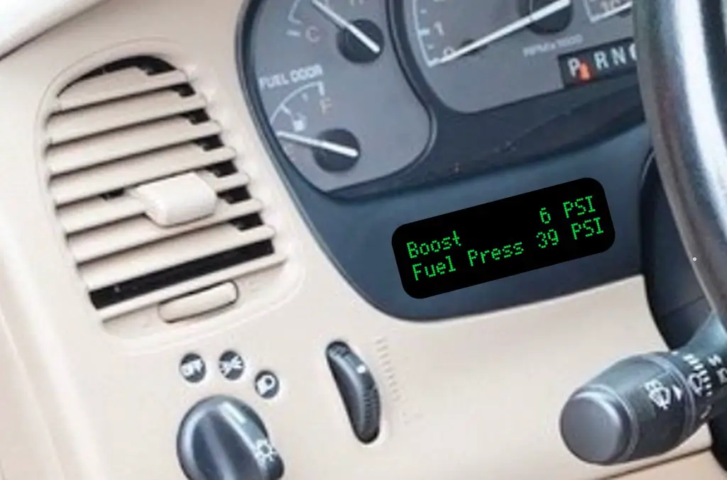

Here is a very rough markup what the new LCD gauge display should look like. This display will match exactly all of the other LCD displays from the factory in my Limited (Center Console Message Center, Overhead Console and AC Control) plus it will dim on the same dimming circuit as the other displays.
What do you all think? Boost and Fuel Pressure or something different? Many options available. I decided on the 2 X 16 Character display which would fit nicely in the area in my mockup. They also have a larger display but it would be a taller and wider and I think not as OEM looking but would fit on the panel but not within the factory black area

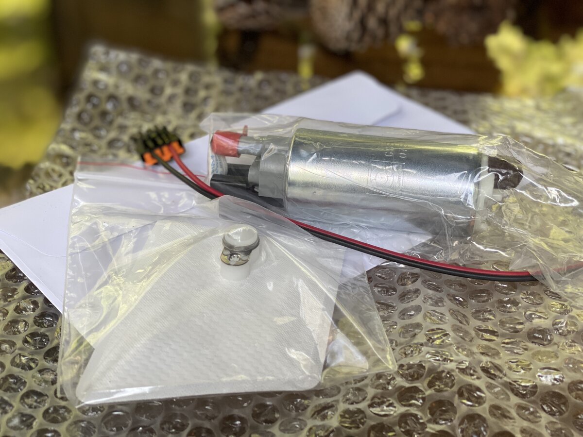

Please replace the two little sections of rubber high pressure fuel line when you do this, they are likely as old as the vehicle.
I did mine twice as the pump I ordered was a kit and they gave me low pressure line which blew-out...............................................
Wow. Thanks for the good tip. Added it to my list. Thank You!!

I had one of those create a lean condition in my 99 SOHC truck, the code 0174 I think it was. One of the short hoses had a split in it. Most pumps include new rubber line, which needs to be high pressure of course.
