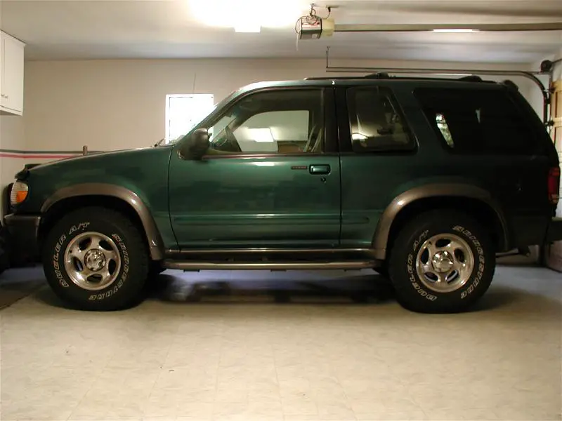

I put 265/75/16's on my 98 Sport. It's tight, but they only required a tiny bit of trimming on the front to avoid rubbing for street use. That was before shackles and TT. After shackles and TT they barely rub when off road.
This is how it looks after shackles and TT:
