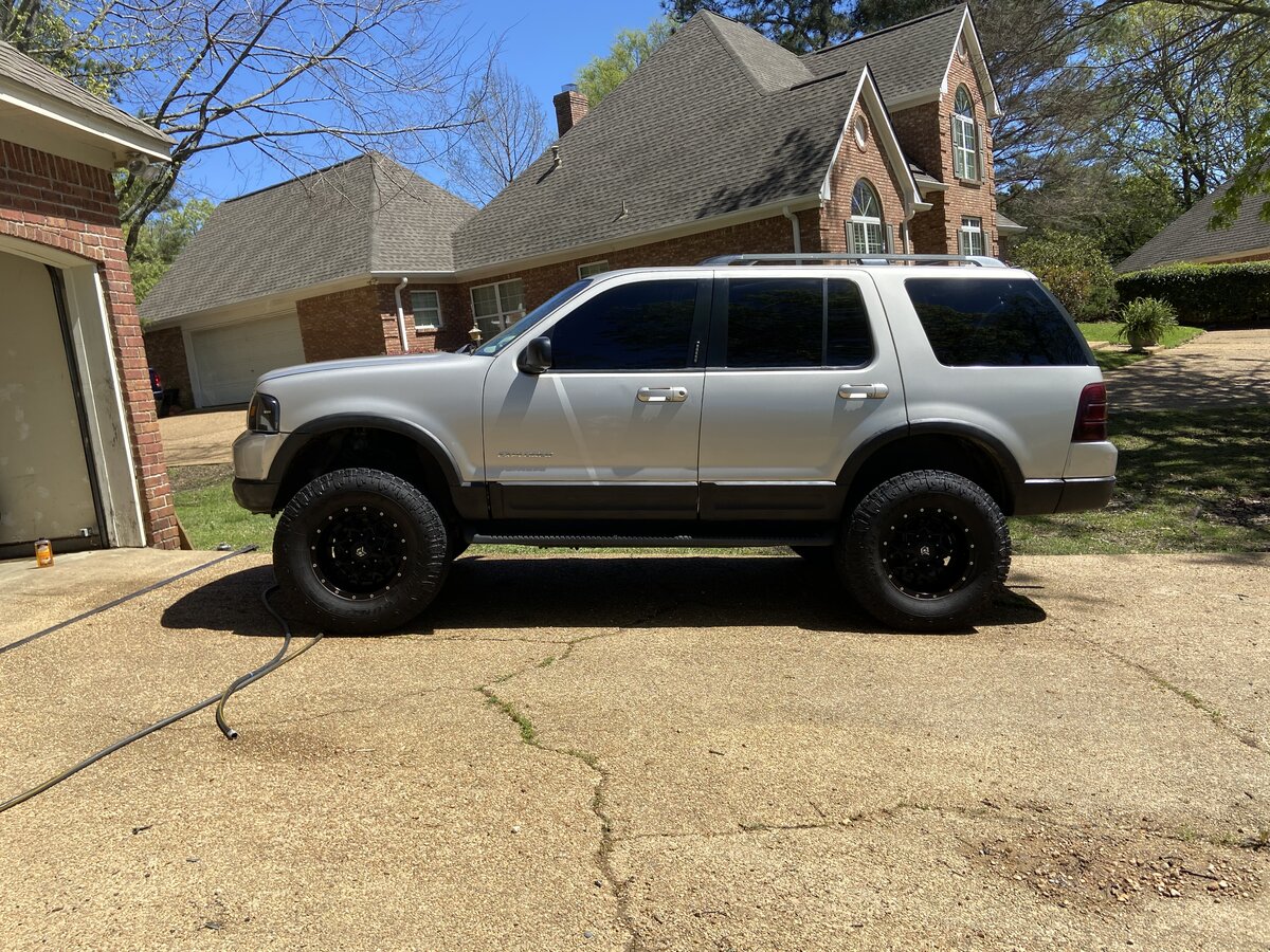

good morning, I've been having trouble searching for the biggest tires that the cv axles can handle. I want to run 35x10.5 or 12.5 with a mostly stock engine. thanks,
I haven’t ever had any problems with my axles, I’m running 35x12.5s
