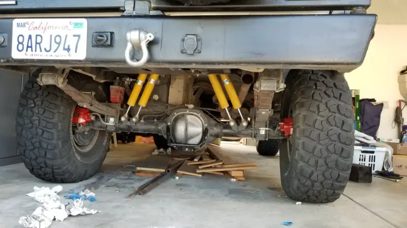

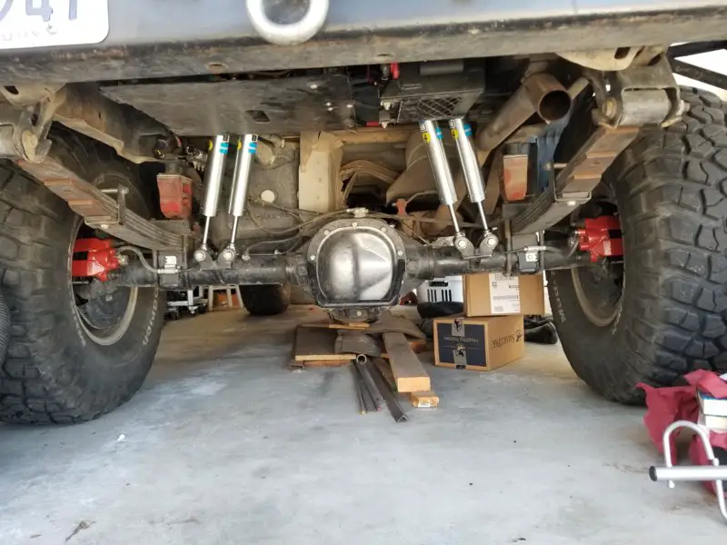

This is old age, and a little luck. I replaced the rear shocks a few days ago. I had some very old Bilstein's that were a little too long for the way I wanted the shocks to mount (would bottom out when loaded for expedition type camping trips), and they had way too much rebound. The way I have them angled in didn't help with body roll and I wanted to move the upper mounts out (I have two different configurations for the upper shock mounts). I ordered four 5125 Bilstein's with 8.25" travel, thinking my old shocks were 9.25" travel shocks. When I pulled the old shocks off, I realized they are exactly the same travel shock (old age part). Luckily, the new shocks body is 1.5" shorter than the old shock body. I bolted them in and ended up with the extra shaft length I wanted. I went for a short drive around the neighborhood and body roll is greatly improved and the shocks are not nearly as harsh as the old shocks. great improvement.

Old shocks
New shocks

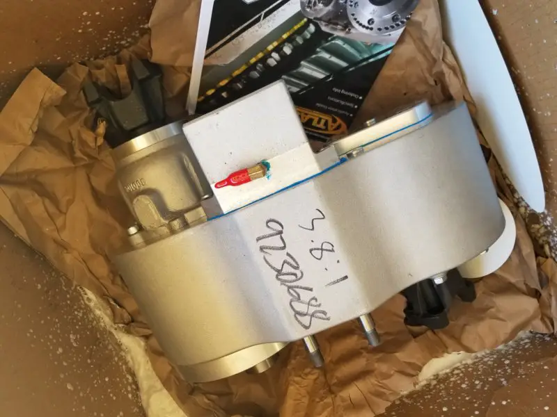

UPS guy showed up today with some boxes, and one BIG, HEAVY box.
It came with the oil, so now I have four extra quarts.
Taaaa-Daaaaa!!

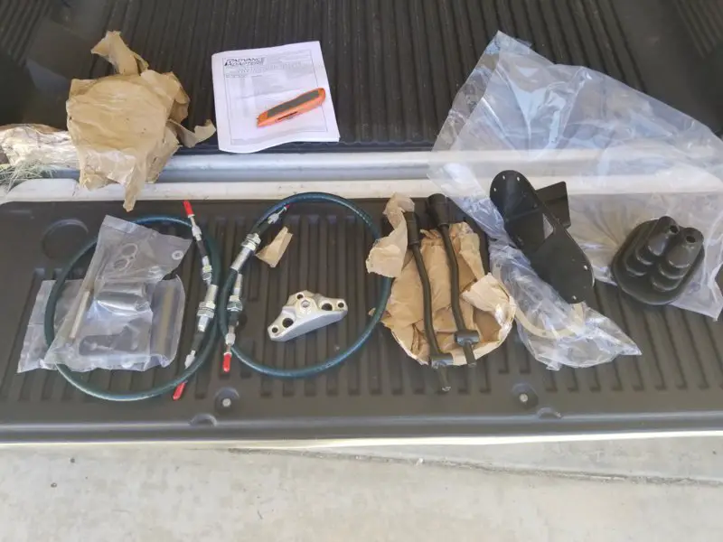

Universal Shifter comes in about 100 pieces. Its very sturdy.
The shifter mount is only about 3/4" wider than the single shifter I have now. It appears that it will fit flat on the trans hump next to the center console. Not sure about how much bend I can get out of those cables because they are very stiff. I will start the tear down probably next week. I am hoping the transfer case itself will bolt right up without anything in the way, but its huge. I think I have the first Explorer with a 700R4 adapted to a NP231 trans to an Atlas II so its uncharted territory.
Now the fun begins :D
holy crap balls I have dreamed of owning one of those for so many years!! Nice!!
Atlas 3.8:1 takes your truck from "pretty capable" to "holy crap its still climbing" kind of capable
