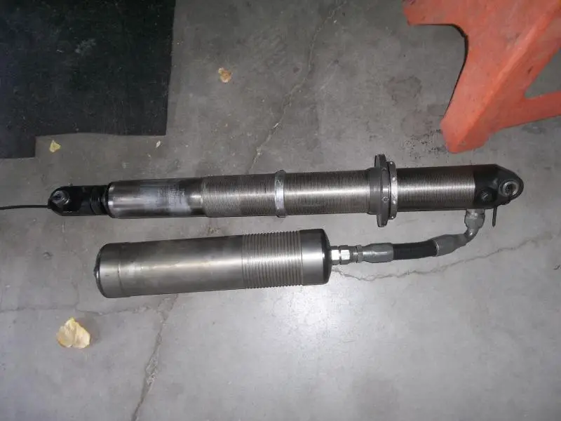

Time will tell if they actually hold up. While putting those new reservoirs together, I could see that someone went through them before sending them out. Which, is something they should be doing with all of their products. Funny part was, when I pulled them out of the box, one of the reservoir bodies had not been brushed and was plain, shiny aluminum. Five minutes with a scotch pad and it looked like the other one, but still...
sirhk was right about the valving not effecting the rock crawling, it still allows all the shock travel to be used at slow speeds. No sway, no rocking, very stable. This SAS project went very well, all things considered. I am very happy with the way it drives on all roadway conditions. Just the way it moves over the rocks without leaning or lifting tires gives me confidence I did not have with the TTB.
Matt (Rock Ranger) mentioned before that I would end up trying more difficult stuff after the SAS. It is already proving true; the stuff I did on Thursday would have caused some serious body damage with the old suspension and I would have never attempted it on a solo mission. Besides some brush pinstriping that will wash off, I got away with nothing but a few scratches on the wheels (totally expected which is why I went cheap on them).

I just got back from a socal road trip. Picking up these was one of my stops, they may be a bit ugly looking but internally they're 100% brand new. FYI, the shock on the tire will be the front coilover mounted behind the bypass where the solid rod is. It's a 2.5" shock for comparison. The two sitting on the ground will be my rear shocks, the red sway a way will be my coilover. Again, the red shock is a 2.5" shock, probably same size as your FOA's... Just for a reality check of how BIG the bypasses on this truck that I'm building are! LOL
BTW, the front coilovers have an external compression adjuster also!!! You can see the knob at the top on the black cap...
Glad to hear it's working good for you now!!!
