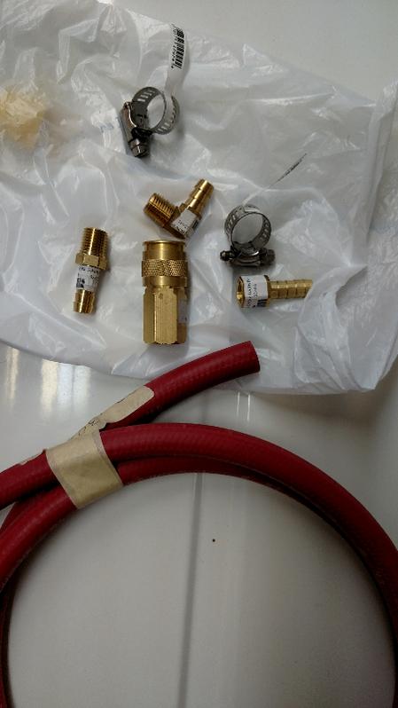

I think I found a location for the coupler on the rear bumper, much like Brian1's, nearly a carbon copy actually. I purchased the material but ran out of time to mock it up. I will probably mount the coupler on the passenger side though, just in case I ever need to use the compressor on the side of the road.

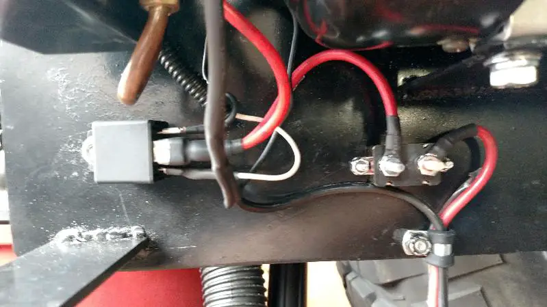

I also don't know why I got it in my head that an in line 30 amp fuse would work with a compressor that draws 30 amps, but it now has a 40 amp auto reset breaker.
