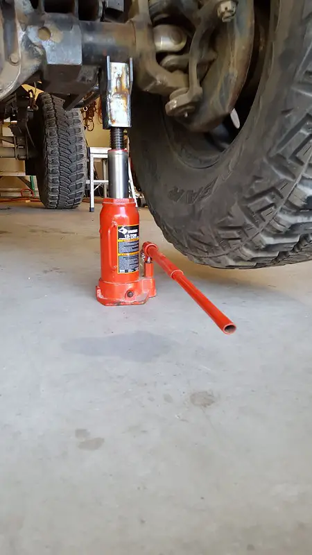

I never liked the idea of using a Hi-Lift jack, and the factory jack is useless (too short). I have been eyeing the HF 4-Ton bottle jack for awhile now because it has a full 15" extension. Mostly due to a screw out extension on the head. This weekend I got a coupon for $12.99 and could not pass it up. It lifts the Explorer with very little effort as is, but just barely off the ground. Also don't like the 1" diameter head, doesn't seem that safe.
I fabbed up an extension with a "V" for the axle tubes to make is safer and more usable in off-road settings. I wanted to keep it as small as possible to be easy to store. After a little trial and error, I figured out the longest extension I could get under both axles was 4". I dug around in my metal pile and found some .120 wall DOM tubing that has an inside diameter of 1", fitting snugly over the jack screw extension head. I sleeved the inside with some 1" OD thick walled tubing to act as a stop. It stops the extension upon slight contact with the shoulder of the jack. I Sleeved the outside of the bottom portion of the extension so there would be no chance of it flaring out and getting stuck onto the jack's shoulder if for some reason the screw out extension was not fully extended prior to using the jack. It doesn't seem to have much wobble, is very strong, and should do the job.
It also fits where the original jack was stored.
I also don't like the cheap, wobbly handle that comes with the jack. Looking through the metal pile now for a new one.
I also carry a hydraulic jack, I need to copy your extension. Nice project:chug:
Could not find a piece of tube in the metal pile to fit well into the jack. Found a nice sturdy piece of thick walled, 3/4" OD tube that almost fit into the original handle tube. Split a section of the original handle lengthwise and hammered it onto the 3/4" tube. It widened out the original handle tube so it fits better into the jack. Hammered the other end down until if fit nicely onto the jack release knob. Its about 4" longer than the original two-piece, piece of you know what, doesn't hit the ground while pumping, is solid and fits next to the jack in the original jack location.

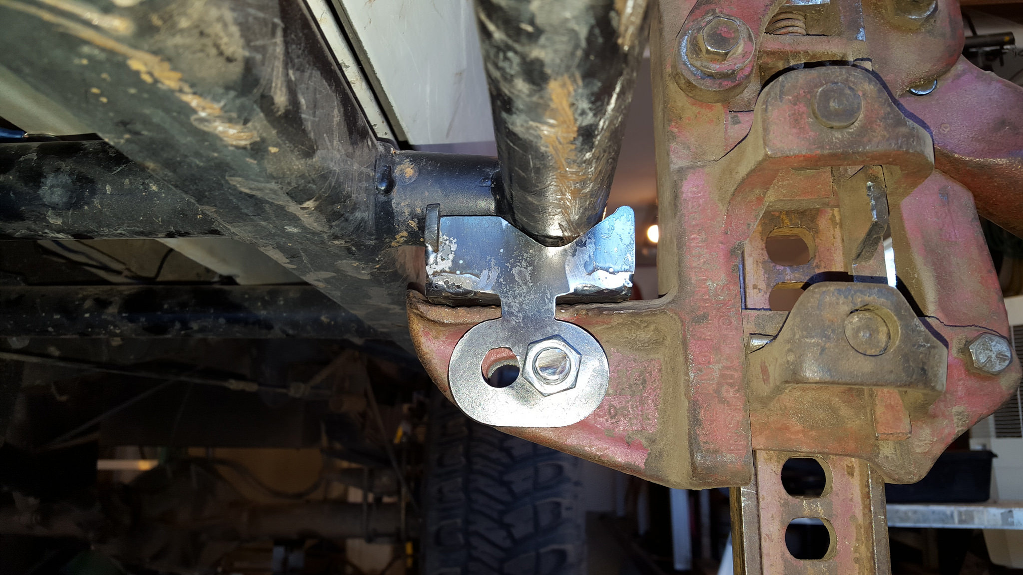

Found a piece of the 1" ID DOM and the other side of the 1/4" thick 2x2" square tube that I used for the extension I made yesterday, and a 1/4" thick 1" diameter plug I had in my "metal that I might need someday junk box". Fabbed up a new stabilizer for the jack that I can use if I get a flat, or on vehicles not blessed with 18" of ground clearance under the axle tubes...

You guys and your bottle jacks! I agree there is a place for one and they can be handy if for trail repairs, but I have to have my high lift. It has saved my butt so many times.
Like this time:
That is a come along on the front and a high lift on the back. Even with a winch I would have needed something on the back.
Or the many times I have jacked it up and kicked it off the jack to get over an obstacle I am high centered on.
Or a clamp. It's great for wrapping a tire with a chain and aiding air to seat a bead.
Or for breaking a bead.
I think I have developed a save lifting method with it- or maybe I am just familiar enough with when it is going to kill me and I need to get out of the way.
Anyway, I hope you are still hauling the old highlift.
I made one of those too, and I have a Hi-Lift mounted on my roof rack. Just don't like using it unless I have too.
