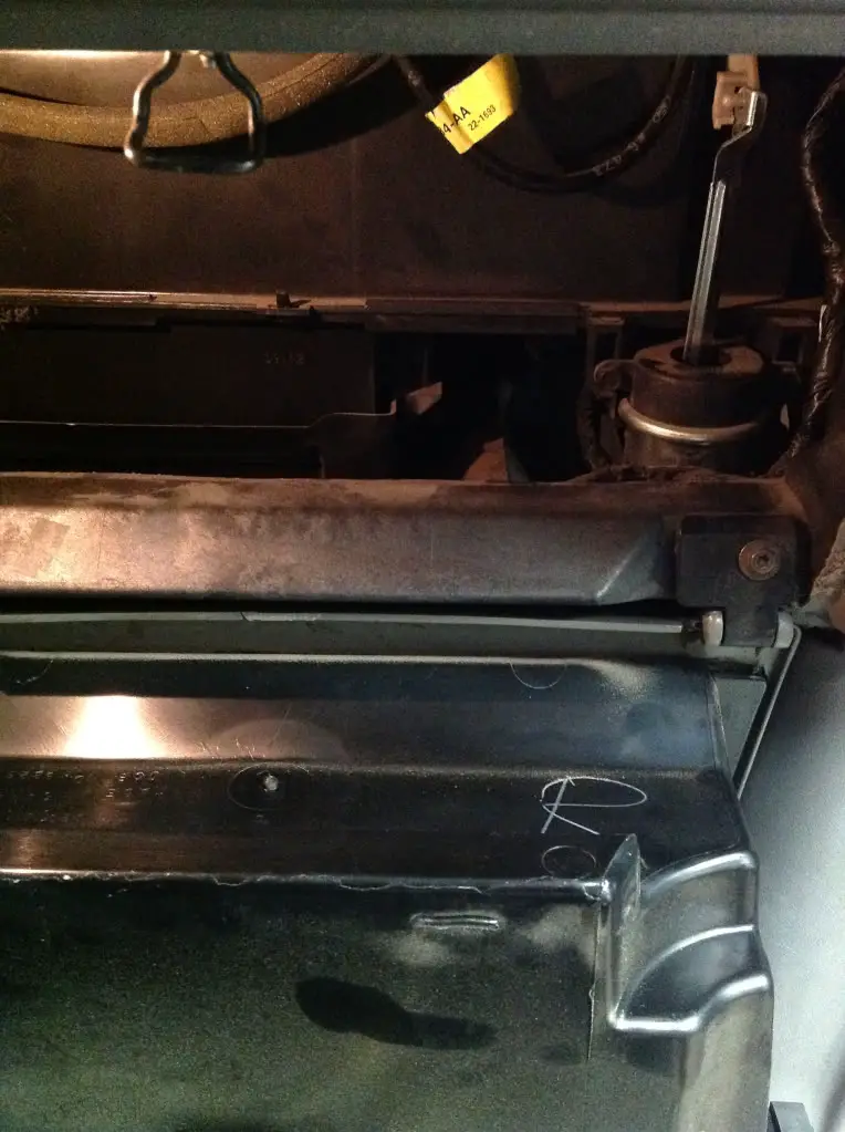

(92 XLT) Like many, my blend door cable broke off the plastic tab of the controller. (it was like that when I bought it but in the cool position) When I made an attempt to re-connect it (which failed) I had to pull out the cable which caused the blend door to open. With the motor running I could manually work the cable and feel the temp difference (hot n cool, but not cold). However the blend door won't shut completely causing the A/C air temp to be around 80! From reading other threads I learned it was located behind the glove box. I found this to be true but the cable routes between the dash and the plenum box where my fat hand cannot get to. I coupled the heater core hoses and capped off the core inlet/outlet in the mean time to get the colder air.
My question is... Can I manually close the blend door without pulling the dash out?
