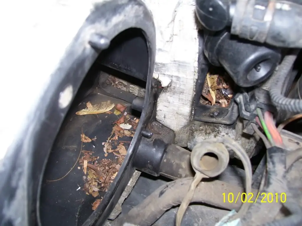

Also Check out the Blower motor fire thread to ensure the blower doesn't have debris stuck inside.
