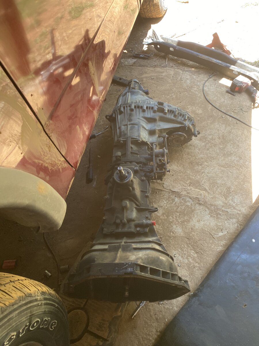

so you found a shop in North Carolina that will convert your truck to a 8? WOW!!!!!!!!!
How much are they charging you?
How long will it take?
Be sure to post pics of your donor F150, the explorer and your truck :)
The guy up the street from me said he will do it for 4k and I can’t seem to find the other posts about this conversion Im not doing the swap my self but would like to learn more,if anyone knows what else I will need to take from the f150 please let me know other than the trans and t case also the donar trucks dash was already out and I don’t see any wiring coming from the firewall but the engine harness is all there with the computer would I have to go to the junk yards and grab some parts of the wiring or would the mechanic be able to use what’s in my truck 99 4.0
D696F421-8E6D-4FB4-8BC9-1974A39DF8C1.jpeg AAB7679A-484B-4330-8891-655CFB128206.jpeg 011167F2-D52C-4506-8D20-A08EEFA47112.jpeg 912D8003-D402-472D-B8AC-6F005273F56D.jpeg C262BD7C-403C-4366-9071-2573D6A1C876.jpeg

I think it’s hyrdolocked as well because every other time I start the truck it will click like it’s locked up and then after a bump start it will start up or after sitting over night but I don’t know for sure all I know is the motor is coming out tommorow😀
not to doubt you but under the console if you pull it seems the trans bolts are not hard to access. imo its easier to pull it seperately, but here we can agree to disagree :)
i do agree on removing the rad and imo the "dressing" stuff to make it essier to pull.
the vroomzoomboom thread i showed you has all the info you would need to do the convrrsion whats the dame what not
