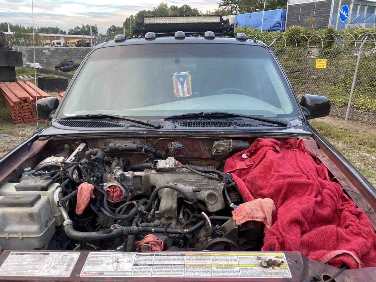

I have been there. Your Head Gaskets, one or maybe BOTH of them are BLOWN. It will NOT fix itself. If you OVERHEAT like I did, the 4.0 Liter Engine is NOT rebuildable. Once it warps it's toast. (Cannot be "milled".) Been there Done that and now have a 2010 G2. Had to call the salvage yard to haul away my beloved 2005 G1 at 230,000 miles. If you have not yet OVERHEATED you may still have some options.Hey guys I got off of work today and drove home when I got home I was adding windshield washer fluid and noticed my coolant resavoir was completely full and had over flowed everywhere,I checked the radiator and it was empty so I added coolant and started it back up.I noticed a cloud of white smoke that smelt sweet took the truck for a drive and at idle it putts and feels like it’s misfiring when I got home I turned it off and tryed to restart it and got a click so I pop started it and it started idling again but putting is my motor blown?and what should I do next I have about 10k into this truck already(1999 4.0 ohv 5speed 4x4 4door)
You hydraulically locked the engine. A cylinder filled with coolant. Pop starting likely destroyed a piston & rod on the hydrolocked cylinder.It starts after pop starting but runs like garbage thank you for all the help
Not sure you can work a forum . Read the threadYou hydraulically locked the engine. A cylinder filled with coolant. Pop starting likely destroyed a piston & rod on the hydrolocked cylinder.
The engine is junk.

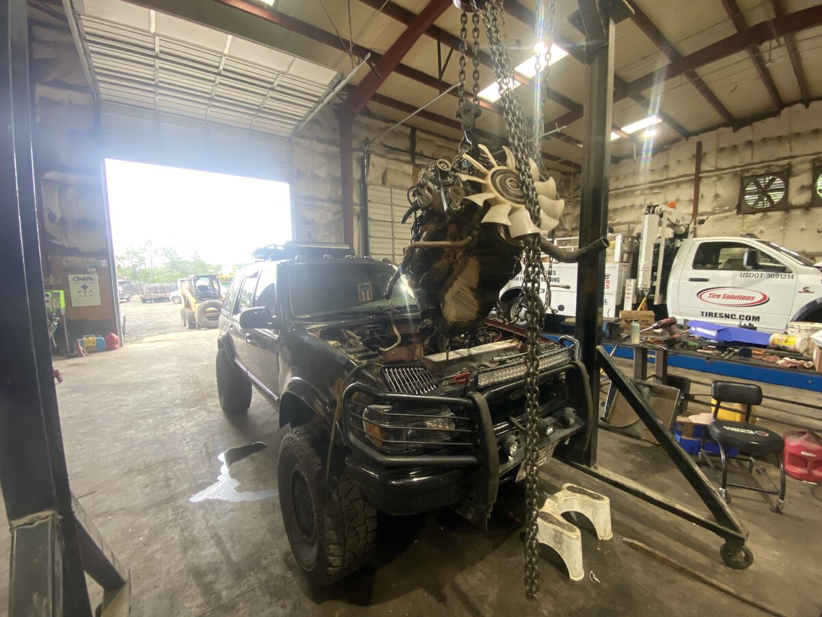

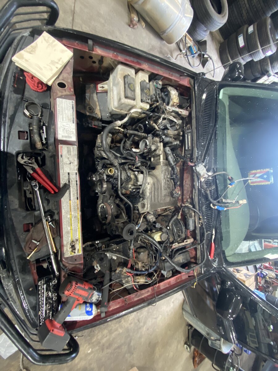

Hey everyone I haven’t posted in here in awhile so I thought I would update everyone.I got the 5.0 motor in and very close to getting it started.I ordered a computer off of eBay with pats and manual trans deleted for the 5.0 so I lucked out with that.the engine bay is almost complete I’m just waiting on a radiator and a fan and some small stuff like oil and oil filter.I got almost all the parts for the trans,I’m thinking I’m going to have to go to the dealer and get some fly wheel bolts and exaust manifold bolts because I can’t find them anywhere.I just wanted to thank all of you for showing support because almost everyone I know just keeps saying why are you fixing that pos,it’s an exploder,it’s not worth it but I keep pushing through because I know when it’s done it’s going to be bad ass and way better than a squated Tahoe.I do have a question tho,does anyone have a vacuum line diagram or know a way to rought just like the essential vacuum line to get it idle and run good,and ac/heat.my goal is to finish it by Halloween,it’s pretty close im.thank you guys ….ps if I dident post it on here my job was nice enuf to let me use there mechanic garage after work and on the weekends so it makes everything so much eaisierOh how I love a 5.0+M5R2+4x4 swap!
