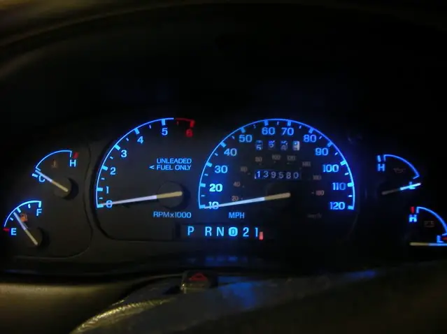

Use white LEDs in the early gauges
Ok, so I have a '03 Sport Trac and have wanted to do the blue lights and black cluster like pictured. What are the differences in the clusters and what owuld I need to do?
