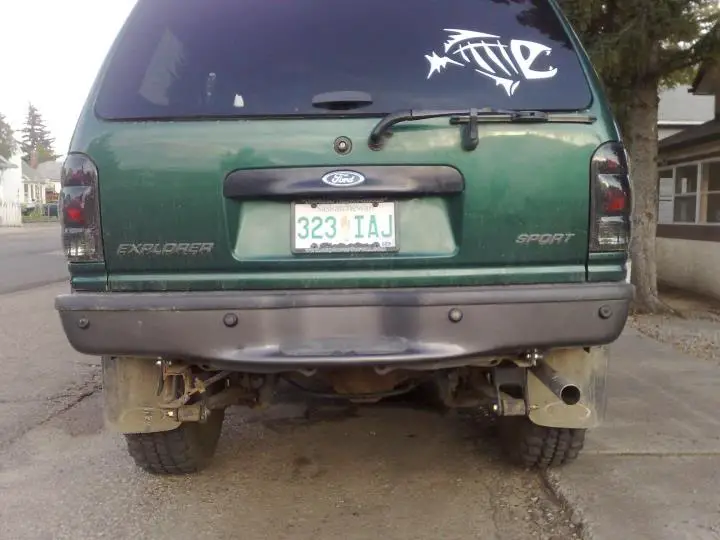

I changed my mind and bought some "V8" badges off ebay, $5 shipped.... sanded them down and took the chrome off them, then used the leftover paint I had to paint the rear bumper...
They're slightly wonky.. but it's ok...
Si
You need to dewonky the passenger side. Use a piece of tape below the emblem as a guide.

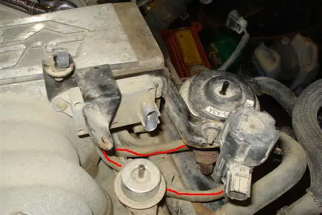

check the hose's coming off your EGR Pressure Feedback Sensor going to the manifold. i noticed when i was taking evils 5L apart, one of the hoses had rubbed threw in one spot, and it to had a high idle. hey, worth a shot, right?
had to look threw your thread again for two reasons. one, for a refresher on your swap, and two, just how far you have come, with the little cash that you have had with pickle. congrats once again.
Do you have pictures Tim? funny you should mention the EGR, I got a code the other day from the EGR... insufficient or something..
Anyway, if you can let me know what I'm looking for, I'll have a look when I put my winter rubber on...
Si
the ones that i highlighted in red. IIR, one of them rubbed threw on either the fuel rail or harness. run your finger down both of them, or even unbolt the sensor and take a look at the lines.
let me know if that solves the problem, that way i know that i have also found the high idle in mine (cause, well i havent put the motor in yet, waiting on TMH :D).

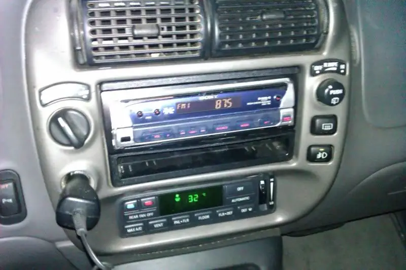

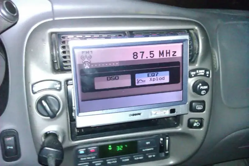

I bought a new stereo for her... Same as the one in Betty, I love this set up, I love everything about it, so I got another one...
Sony XAV-7W head unit, XM ready, if that's what you're into...
I'm just waiting on my parents sending me over the dvd changer from Betty, so I can have some film watching capability!!
