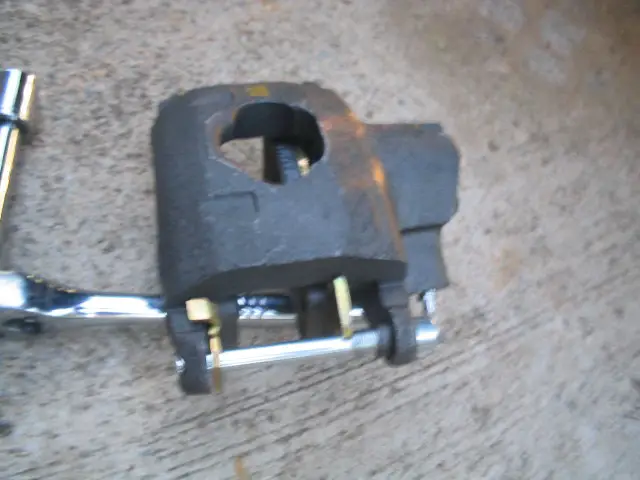

Here's the pics I promised last week. :confused:
I ground out the caliper brackets and now they sit perfectly. I also got the rest of it setup so I just need to bend the brake lines to fit right. These rear brakes are huge...and everything ended up fitting perfectly! I'm glad I went with 16" wheels because I'm not sure that I could of fit 15s. Before I ground down the bracket (the caliper sat up 1/2" too high) I couldn't fit on a 15" wheel. I'm gonna try again tomorrow, just to see. For anyone wondering what I used for the disc conversion, I updated the first post with all the parts used. The hard work/hours of research was well worth it, cause I saved about 350 dollars instead of buying the disc brake conversion kits, which usually make you buy your own calipers anyways, (so you have the option of e-brake or not). Anyways, my neighbor is back now, so he's probably gonna weld everything for the back tomorrow afternight, hopefully some for the front too. BTW, I cut my bumper and cleaned up the cuts so it looks much better. It'll be good for now, until I finish up the winch bumper.

Bryan what brake calipers and rotors are you using? They do look big.

im not sure if i missed this or not(i tryed to follow yours) but what did u do for rear springs?
