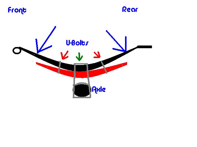

The guy said my boat on that trailer is maxing it out. So I put on the leaves or leafs springs which is it, anyone? I painted the axle and cleaned every thing up. And got to thinking I have new springs and a older weaker set. So what is stopping me from cleaning up the old springs cut them down some to make a set a ghetto leaf packs???
I would put the cut down spring under the new one. The cut spring would have a 1/4 hole drilled 1/8 deep because the there is a locater/hold the leaf in place pin on the bottom of the springs. I would also clamp with u-bolts the springs together.
Is this a bad idea?
Will it kill me?
I kind of see it as an add a leaf, don't see how it could hurt anything.
I made a MS Paint Illustration.
Note the:
Green arrow is the longer axle u-bolts,
Red arrows are the new spring pack u-bolts.
Black is the new spring,
Red is the older spring.
The blue arrows are the only problem I can really think of. Which is that the springs are stiffer in the center, so where ever the help spring stops the new spring may bend there at the tips where it is thin weak and not designed to bend. But other then that I think I am good.

update, I looked at the older trailer's springs (3pack) and the smallest leave will work.
