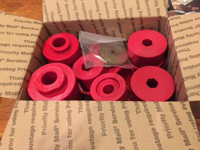

I just gotten these in today, I am getting very excited now waiting on my new bolts to come in Wednesday and maybe Thursday I will start. I need to make more room in the barn, I am thinking it will take me a couple of days. My wife said she would help me, I am going to see how tis works out. LMBO!
