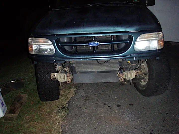

So, years later, I'm finally ready to reposition my stock bumpers. With a new son, I'm not buying cool tubular bumpers any time soon. Nor do I have the time or equipment to make my own.
So anyway. After years of procrastination, I got out the box for the PA853 body lift and looked at the directions and brackets. I was told origianally that kit 853 would have the proper front brackets, but I'd have to fab some rear ones. Upon further observation, I've realized that the front brackets from the kit seem like they will work on my rear bumper. The other brackets seem useless. So, I had my front bumper off ready to use the brackets from the kit, but was out of luck. BUT I was looking at the way that front bumper is mounted and it looked like I could play with what is there and make it work. Well, I'm almost ready to put the bumper back on, but am exhausted so I'll try and get to it tomorrow. But it does seem like it's gonna work. I had to notch part of the mount that is attached to the frame, and drill new higher holes but I think it may work! I don't think I'll get it the full 3" height that i need, but it'll be pretty close. I'll get some pics up asap.
