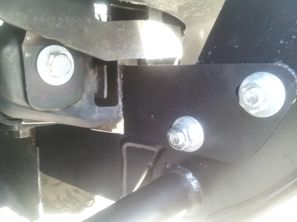

Here's one that I had on my photobucket. If you look, he basically measured to see where he needed to slice the whole bracket in two, in order to clear the frame end, then - added another piece of same gauge plate to weld it back together (the little triangle piece) . Fits good, imo.
I guess those pictures I sent you showed you how much to cut off of the bumper and cover? Glad to see it's all done now.
Yeah I only had one little spot but the damn thing was still crooked. I ended up cutting heavy duty washers in half and put them on the top sides of the brackets and then sunk 4 screws though the end of the bumper cover into the metal on the wheel wells. Thanks a million - couldn't have finished without your pointers along they way.
Luke - Thanks for the pic of the bracket. Helps me understand a little better what I need myself
Also offtrac thanks for the trimming help. Your write-ups saved me a lot of time and pain. I only had to cut a little extra once or twice instead of 1000 times.
