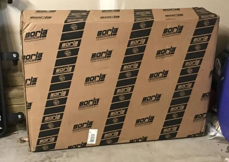

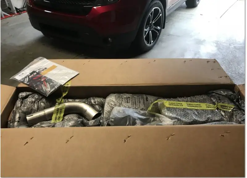

The big box of noisy fun:
Opening the box, it was all packed nice and securely with a ton of expanding foam packing material.

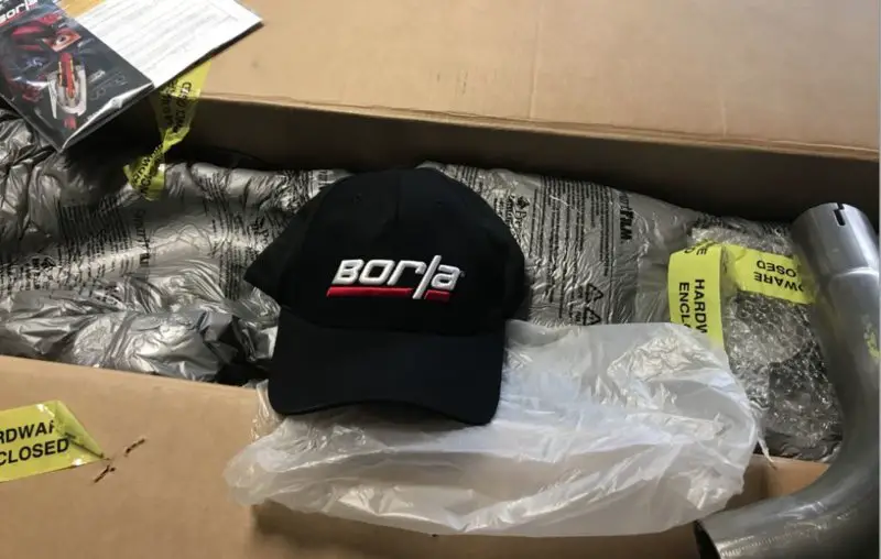

Bonus! A hat!

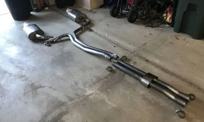

My first step was to unpack it all, lay it out carefully on my garage floor, and verify that I had all the parts. I didn't want to pull the stock exhaust off then find I'm missing a clamp or pipe. Here it is, layed out on the floor.

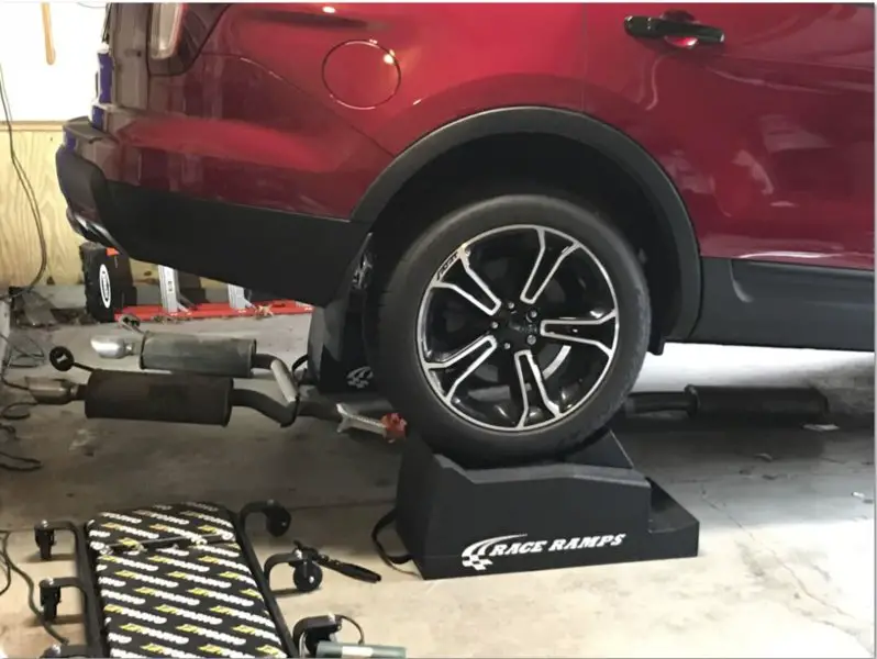

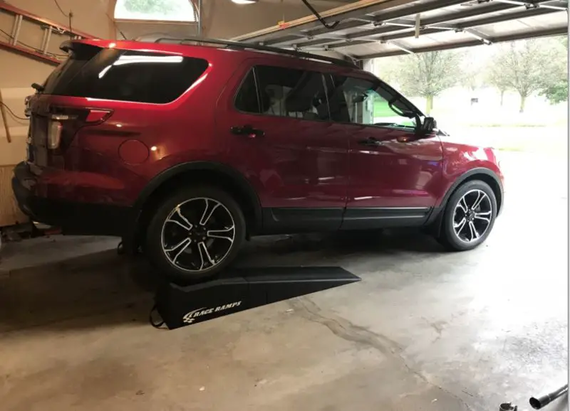

Time to get the Explorer up on the ramps. These RaceRamps are expensive, but very nice. Nice shallow angle to drive up, I never feel like I have to give it so much gas that I'm going to overshoot.

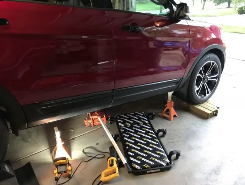

I wanted a bit more room toward the front, where the pipes need to be cut, so I jacked up the front passenger side and put some 4x4's underneath. In this picture I've also moved the floor jack under the car, lightly supporting the stock exhaust so that it won't try to move downward and pinch the sawzall blade as I cut.

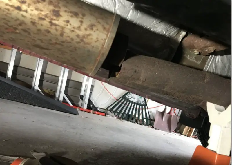

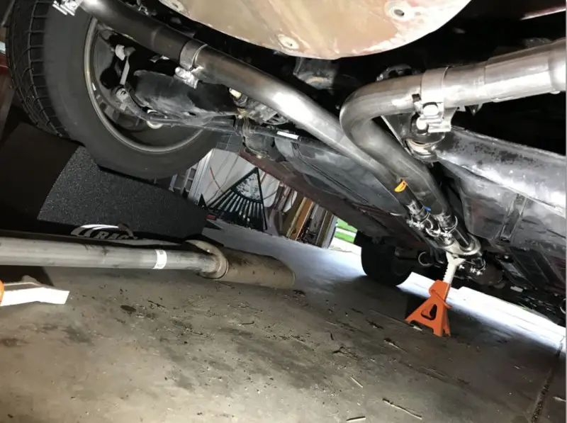

Under the Explorer there's a large muffler. You cut the two pipes right in front of that muffler, on the side toward the front of the car. The Borla instructions show it nicely. Make sure you have a good blade, and keep in mind that the two pipes are relatively close, so be careful that when you're cutting one pipe, you aren't just bashing the front of the sawzall blade into the side of the other pipe. There's plenty of room with no cables or hoses near here.
The cut pipes. Note that I have a jack stand supporting the forward portion that goes to a catalytic converter and the downpipes.

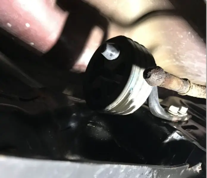

At this point, the only thing holding on the stock exhaust are exhaust hangers. No bolts, just hangers. If you aren't familiar with these (and I wasn't at all until I started researching 2-3 weeks ago), these are large rubber grommets that hang from hangers on the car. The exhaust has hangers welded onto it that go into the other end of the rubber hanger. Here's one from my car - you can see how the exhaust hanger has a ton of surface rust, while the hanger mounted to the car is corrosion-free.

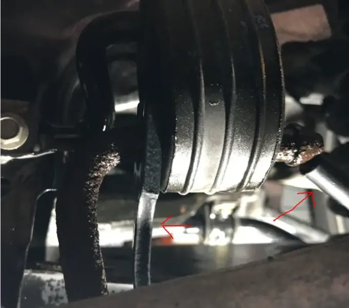

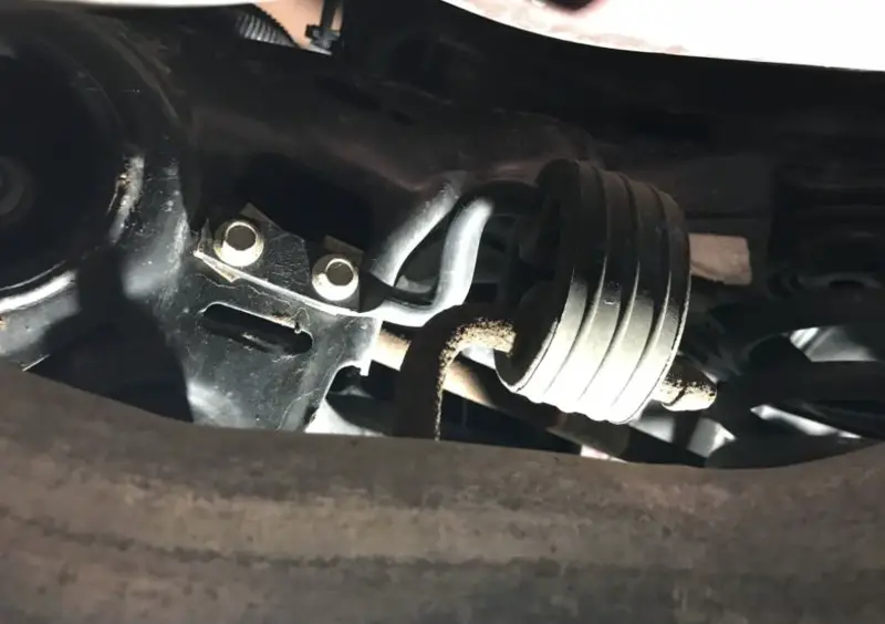

Now the job was to get the exhaust hangers out of those rubber hanger pieces. They do NOT want to slide out of there- the rubber is pretty stuck to the exhaust hanger, and the rust certainly makes it hard to slide them off. The solution here is to spray some silicone spray on the hanger and rubber piece. Don't use oil, it will degrade the rubber over time. Also, there is a special tool just for getting these off, made by Lisle. It's $18 on Amazon and I don't recommend trying this without that tool!
Here you see that same rubber hanger after I sprayed some silicone spray on it, and I have the Lisle tool in place. The red arrows point to the two sides of the tool - it's basically a specialized set of pliers to push the end through the rubber hanger.
And here it is after the exhaust hanger is out. The large rubber hanger should stay on the car.
I worked my way back removing these hangers - there's 5 of them. The last two, directly above the exhaust tips were the hardest, as it was impossible to get the tool positioned. For those, I just sprayed silicon on the vehicle side of the hanger (non corroded upper hanger), and managed to slide the entire rubber piece off the car. At this point the stock exhaust can fall down so make sure you have it supported. Here it is, on the floor after I pulled it down off the jack stand. You can see the rubber hangers still connected to it, right above the tips.
Now it was easy to use the Lisle tool to remove those, and then I just slid them back onto the hangers on the Explorer.

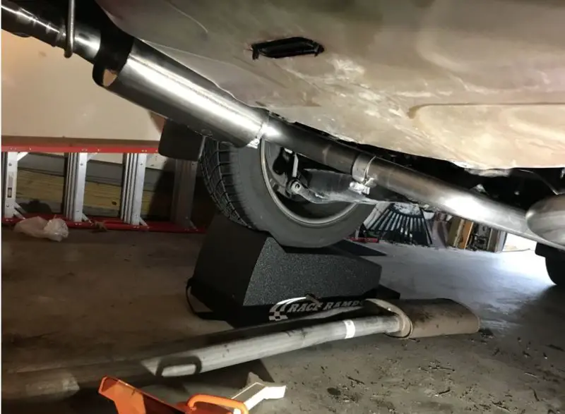

OK! Now the stock exhaust was off. The hardest part is done! I think I had that done in about an hour. Putting the Borla system on is a piece of cake, since it's all in sections. Borla tells you to start from the front where you cut the pipes, and install piece by piece. Make sure you slide clamps over the connections before you slide the pipes on, but do not tighten them at all yet. Pro tip I learned the hard way - think about the orientation of the nuts, I didn't and that caused me to have a few clamps a bit harder to position. As you go along, you'll be sliding sections on and hanging them on the hangers - they'll go into the rubber hangers easily as it's nice clean stainless steel. A squirt of silicone spray helps as well. No tool needed, I could slide them on by hand. Unfortunately I didn't take any pictures along the way here, but it's very easy and the Borla instructions were fine.

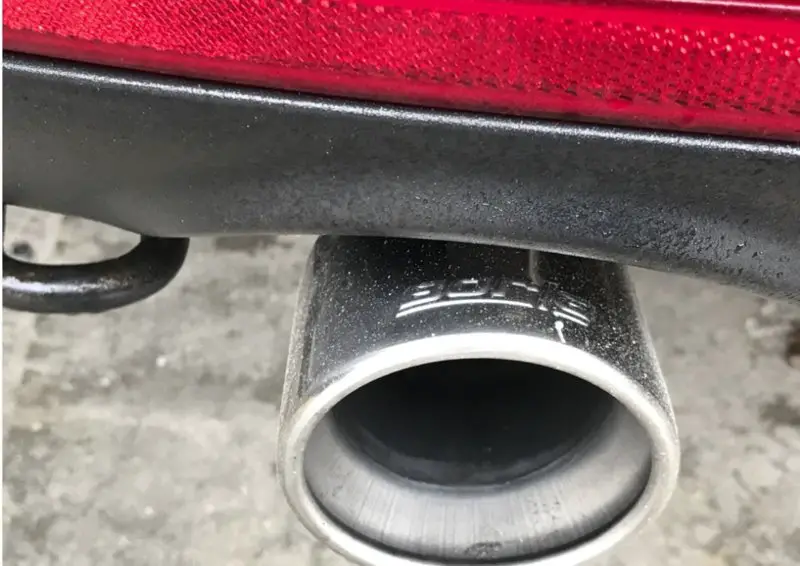

Once it's all on, it's time to play with the exhaust tips. Get them set where you want them, centered and so that both are sticking out the same distance. Then, working from the back to the front, tighten the clamps. I only lightly tightened them at first - tight enough so that the pipes couldn't slide, but not torqued down yet. Keep checking to make sure the exhaust tips are still positioned correctly. I used a cordless impact wrench to lightly do this. Here's the exhaust on my car, some of these may be before I tightened the clamps. When I tightened them, I tried to position the bolts as much to the side as possible. In some areas that wasn't possible, or I was concerned the clamp bolt would be too close to the underbody and might rub/rattle.
After that, I went back with a torque wrench and tightened them down to the Borla torque recommendation.
You're done! Borla recommends you fire it up and use soapy water with a spray bottle to check the connections for exhaust leaks - I didn't find any.

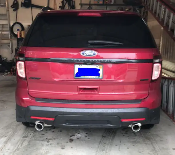

I took it out for a test run (in the rain, unfortunately) - it's just the sound I wanted. Deep, throaty growl when you start or any time you hit the gas. When just cruising, it sounds nearly identical to the stock exhaust. I can't wait to drive it some more today!
Yep, drove it in the rain and now the tips are no longer spotless.
