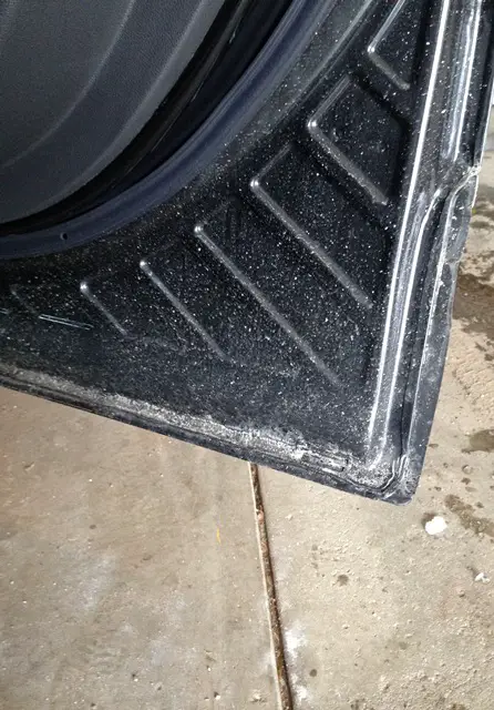

Salt spray and road grime are obvious culprits for speeding car rust. I've noticed that significant amounts of salt, small rocks, sand and other debris have been collecting on lower portion inside the doors. This happens to most cars, but the Explorer's design seems a bit more severe, as the bottom portion of the doors curve in towards the car, effectively holding onto the debris. See photo. (Sorry if it doesn't work, first time with pics in the forum.)
IMG_0596 by thatch1234, on Flickr
Any cold/snowy/salty weather 2011/2012/2013 owners out there notice rust in these spots yet?
Come warmer weather, I'll flush the doors well and apply wax to help prolong the life. Any thoughts on long-lasting products?
iThkpS

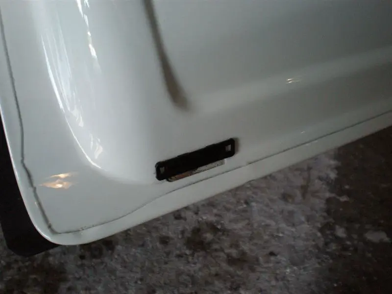

I was wiping down my door edges and bottoms after a car wash last weekend, and since the wax is green/blue I sort of stumbled upon this in the bottom door fold.

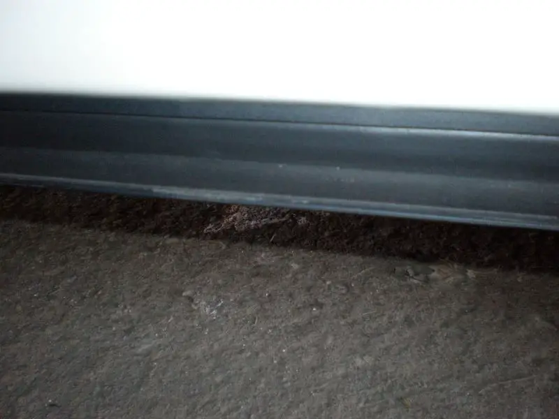

Also - pic 2 - the large rubber seal under all the doors hold water and have drain holes on the bottom of the seal-these all drain against the side of the door and run down into the gap and sit in there.
See the edge facing you in the pic? Thats not flash-door edge is encrusted with road gunk and paint is chipped. Touch up will cover it but come winter doors are a gonner...
The overall door sill/rocker panel seam design probably is not doing a good job of keeping fluid out under any conditions from the outside, and have fluid draining on the door sill all the time from rain/wash, etc. from the inside.
Cant win...

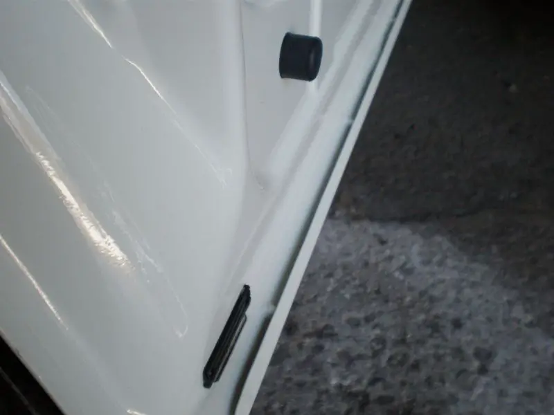

Here's a question, what are the main functions of the two slit holes in the front and back of those doors which have the tabs covering them?
I was planning on blocking them off but im sure there is a reason for them.
I wouldn't block the 2 long slits, these drain water that is inside of the door panel.
Its hard to see that they do anything physical except act as pads when the door is closed on the rocker.
I think they are a breather valve for water evap in that door channel.

They are drain holes. The covers are called a Door Access Plugs and are $4.10 each. I'm guessing that the opening would also allow a certain amount of air circulation. Unless you want a door full of water, you best keep them open.
Since Ford refers to the opening as Door Access, I wonder if the that bottom channel where the out skin is folded over the inner skin is also used for a certain amount of drainage?
