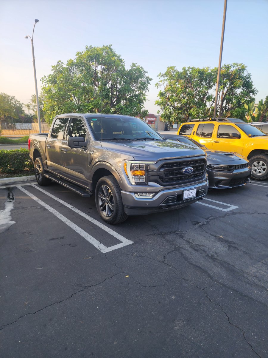

Well bought a new Truck yesterday. We're keeping the Ranger to tow behind the RV until the end of next summer. We will be doing some testing with this new truck at work as well. Found this still on a lot new, and got a killer deal.
2023 F-150 XLT FX4
3.5L w/ max tow package.
It's basically a lariat w/ cloth seats.
Soon as we get a leveling kit on it, we'll throw some 35's on it.

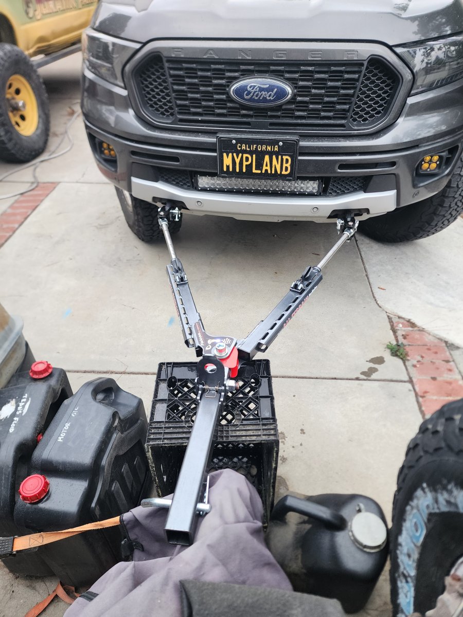

Can the Ranger be flat towed or do you use a dolly?
Flat tow. This is in Savannah, GA. CA to FL. and back. Dragged her 6k miles. We'll do it again next summer to NY.
Works perfect. Technically the F-150 can be flat towed as well....but that's ask a bit much of V10 in the RV.

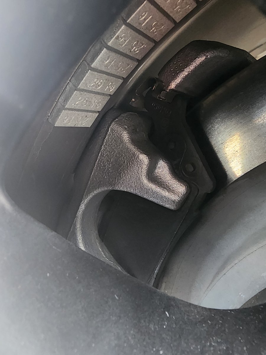

First mod coming in...
Raptor beadlocks and will do some new BFG KO3's in a 315/70R17.
Supposedly you can't run 17's on my truck. This has to do with the Max Tow package, as they have larger brakes. The caliper hits the wheel. 😕
But that's not going to stop us. With a little help from the washer drawer, we discover just spacing the wheel out a 1/4", she fits. So I'll just order some 1/4" wheel spacers.

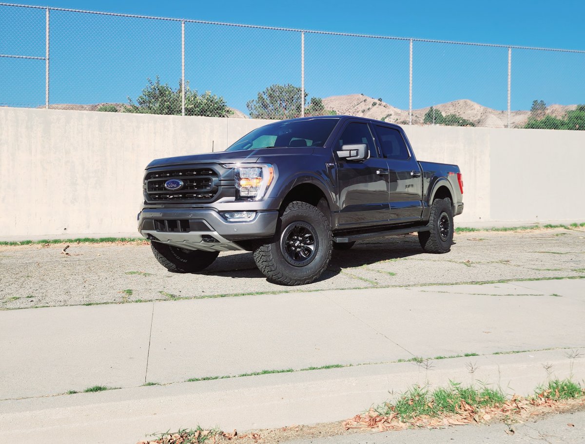

KO3'S to go on the F-150

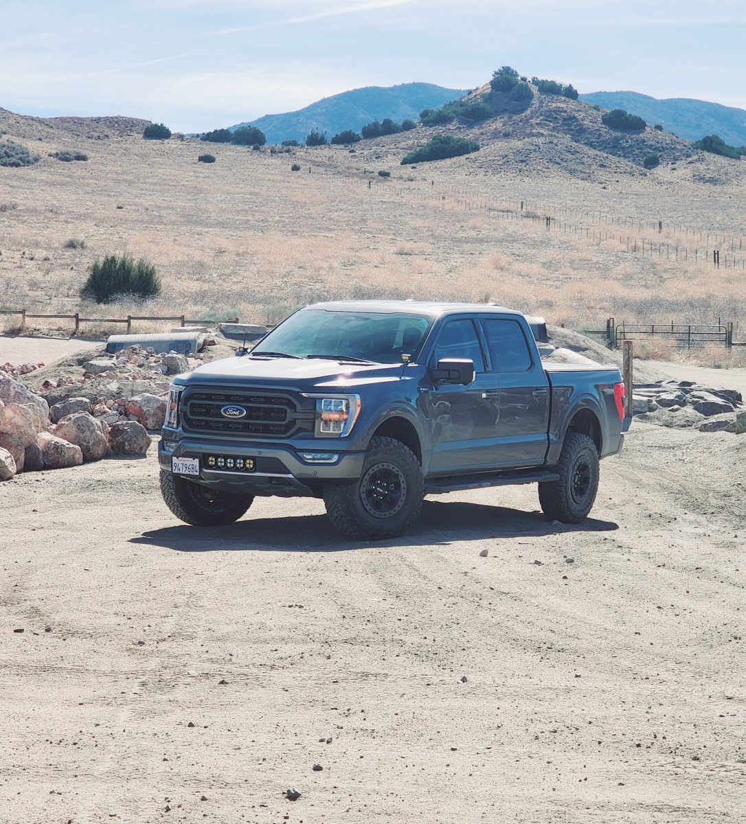

Leveled...

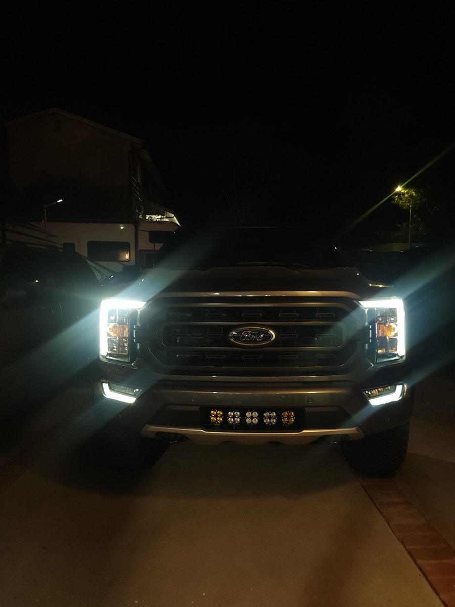

And just finished the lower light mount. Had to build it from scratch.
Was out doing some base line testing for work a week or so ago. Should be finally getting a upgrade to the suspension next week.
Gorman! I only got a chance to go last month since it reopened. Have they opened more trails since or just generally the west end of the park?
Same as before I believe. We just went out for the day to test. We got some pretty cool footage. Stay Tuned
