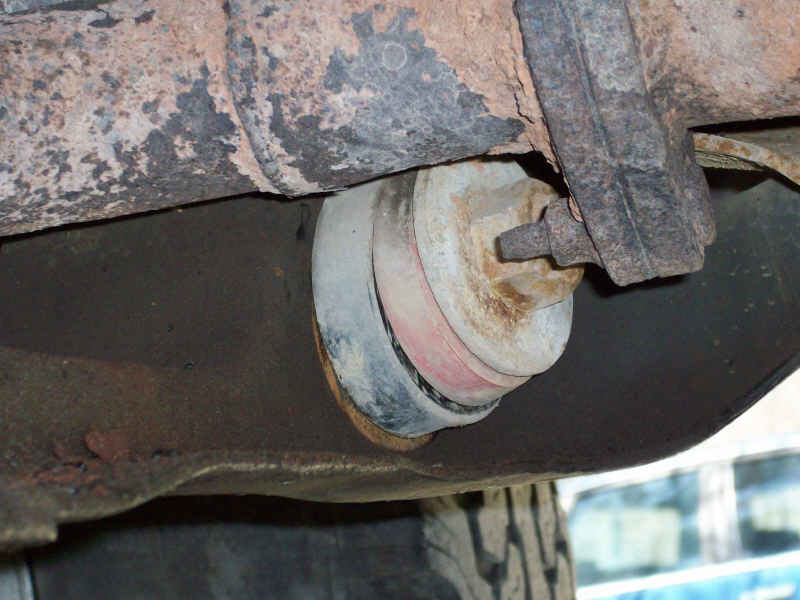

here are some pics of my truck after leveling springs so you can see what im talking about
