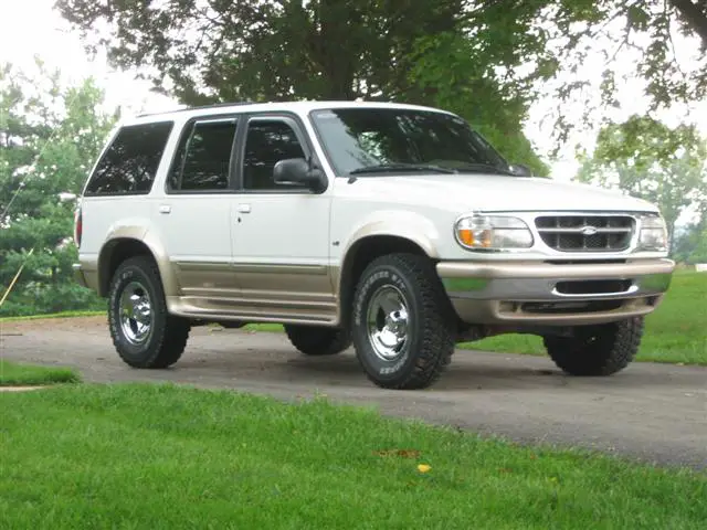

After excrutiating headaches with the transmission in my Dead Link Removed I decided to get a new Explod... uh, Explorer. So here's what I got:
1998 Eddie Bauer 5.0L V8 4x4 128k:
Aftermarket Stuff:
Hidden Hitch Round Tube Class III Reciever
Ventvisors
Tinted front windows (15%), Windshield (50%), Cargo Windows (5%)
Mobil 1 Synthetic Oil/Transmission/Transfer-Case/Diff oil
Flowmaster 50 series with 3" Turndown after Muffler
"EXPLORER" 3rd Brake Light Cover
Explorer Express Rear Sway Bar
Lund Windjammer
Vector 700W 110V power inverter mounted in rear jack area
TYC Gunmetal Altezza Tail Lights
Crimestopper 2-way FM remote start
75 sq. ft. Brown Bread Sound Deadener
Aimco Extreme Slotted/Drilled Front Rotors
Optima Yellow Top Battery
265/75-16 Cooper Discoverer S/T
Warrior Shackles
Torsion Twist
Gabriel (VST) Front Shocks, Gabriel Load Carrier Shocks in Rear (have helper coils on them, damn sagging leaves)
Infinity 10VQ Sub powered by a JBL P180.2 Amp and Pioneer HU
Stainless Steel Billet Grill
Crystal Clear Headlights and Corners

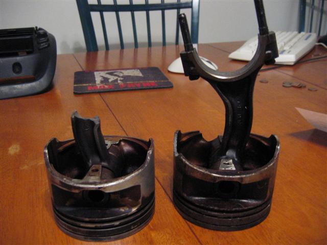

Motor:
Blew up the stock motor, sucked a little (ok, a lot) of water in and broke a rod (literally snapped it, pics below) so I decided to rebuild myself since I had some free time before starting my new job. Ended up with a 347 just because. Still needs to be tuned and finshed up, but it sounds badass!
347 Stroker
Eagle Cast 3.400" Crank and 5.4" I-Beam Rods
KB Flat Top Pistons (Approx. 10:1 compression)
Comp Cams Cam 35-514-8 with Comp Cams Dual Springs.
1" FMS Intake Heat Spacer
1.6 FMS Roller Rockers
Torque Monster Headers
255lph TRE Performance Fuel Pump
Taylor 8.2mm Wires
Granatelli 75mm MAS (Probably will switch to 80mm Lightning)
MAC Cold Air Intake
OEM Mustang Aluminum Valve Covers
Stock GT40P and intakes for now (all torque, no top end)
Sniper Special Forces Tuning Software (need wideband O2 first)
Rebuilt and un/reinstalled by me, machine and balancing work by others.
