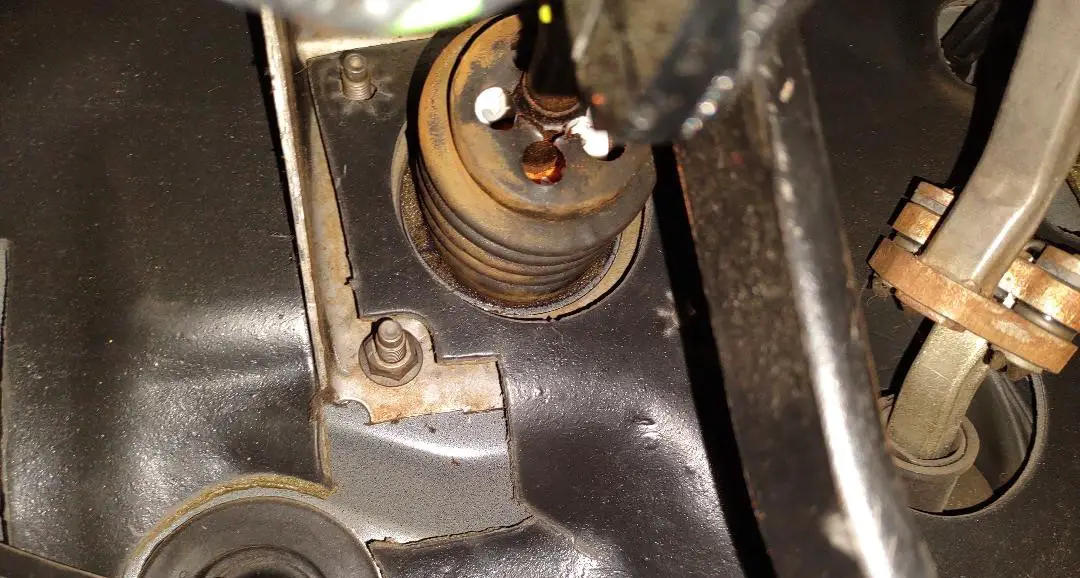

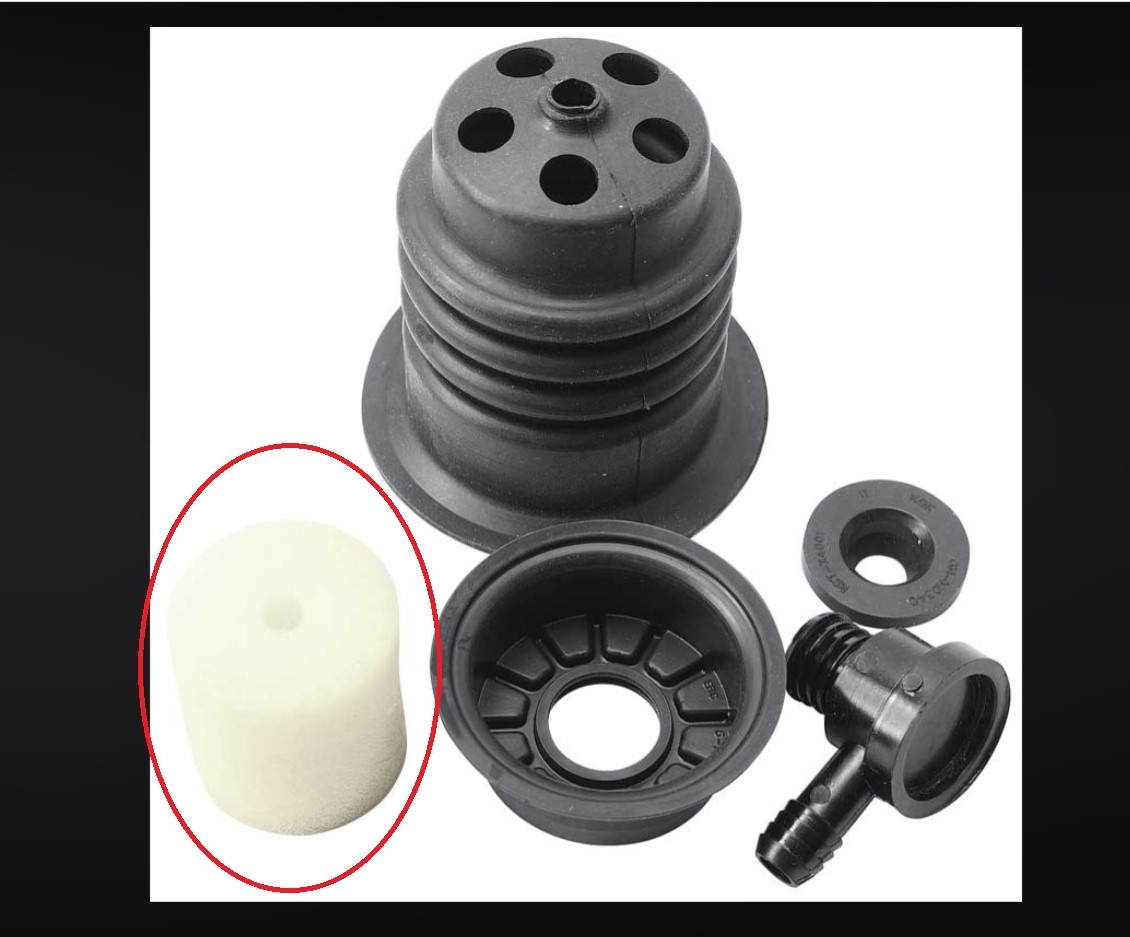

A hiss/swoosh sound occurs when applying brakes. Inside the rubber boot, where the brake pedal rod goes through, a foam silencer is suppose to be there. My 1999 Explorer foam silencer has disintegrated and needs to be replaced. Is their a source to buy a new boot with foam silencer? If not, maybe a trip to the craft store to buy some foam to make one...
Thanks!
btw - the attached pic is not an Explorer Boot.

Thats ok. Any suggestions appreciated. I was thinking of trying to find a boot that would fit over this one but hard to find any boots... Or just stuffing some foam inside but the boot is ripped/torn on the end and will not hold anything inside very well. May be stuff foam inside, then zip tie a plastic washer on the end, pressing the plastic washer against the rubber boot. dunno...
