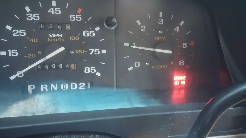

Pics please, both my 94 trucks do not. I've only seen it on a few second gens.
My 94 sport has a dash light that illuminates when the parking brake is on, I use the parking brake all the time
E-brake ON:
E-brake OFF:
I hope this helps some! I have an LED in mine, so it's nice and bright too! And it should last longer than the truck will... Maybe ;)
Oh yeah, the problem could also be the switch on the E-brake. Mine didn't work. I have no clue why, it should have been making perfect contact to work but it wouldn't. I replaced the switch and now it works flawless.
Interesting. In the pic above, that's the older dash with only 5 digits on the odometer. I've never seen the light on mine but it could very well be burned out.
