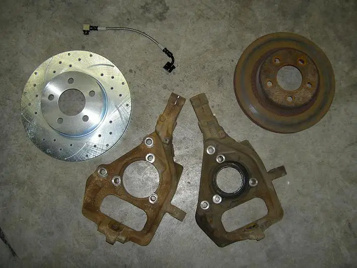

I have a 99 Explorer that I used to deliver mail before 2012ish when the trans went out; that one I swapped Sport Trac spindles onto, plus new 12" rotors. That has the original calipers, thus it uses the stock 1995-2001 pads on it. I liked that also, and with SS brake lines it did great, but the extra rotor size didn't really show an advantage. But they are better, that extra inch or rotor is better heat capacity and transfer.

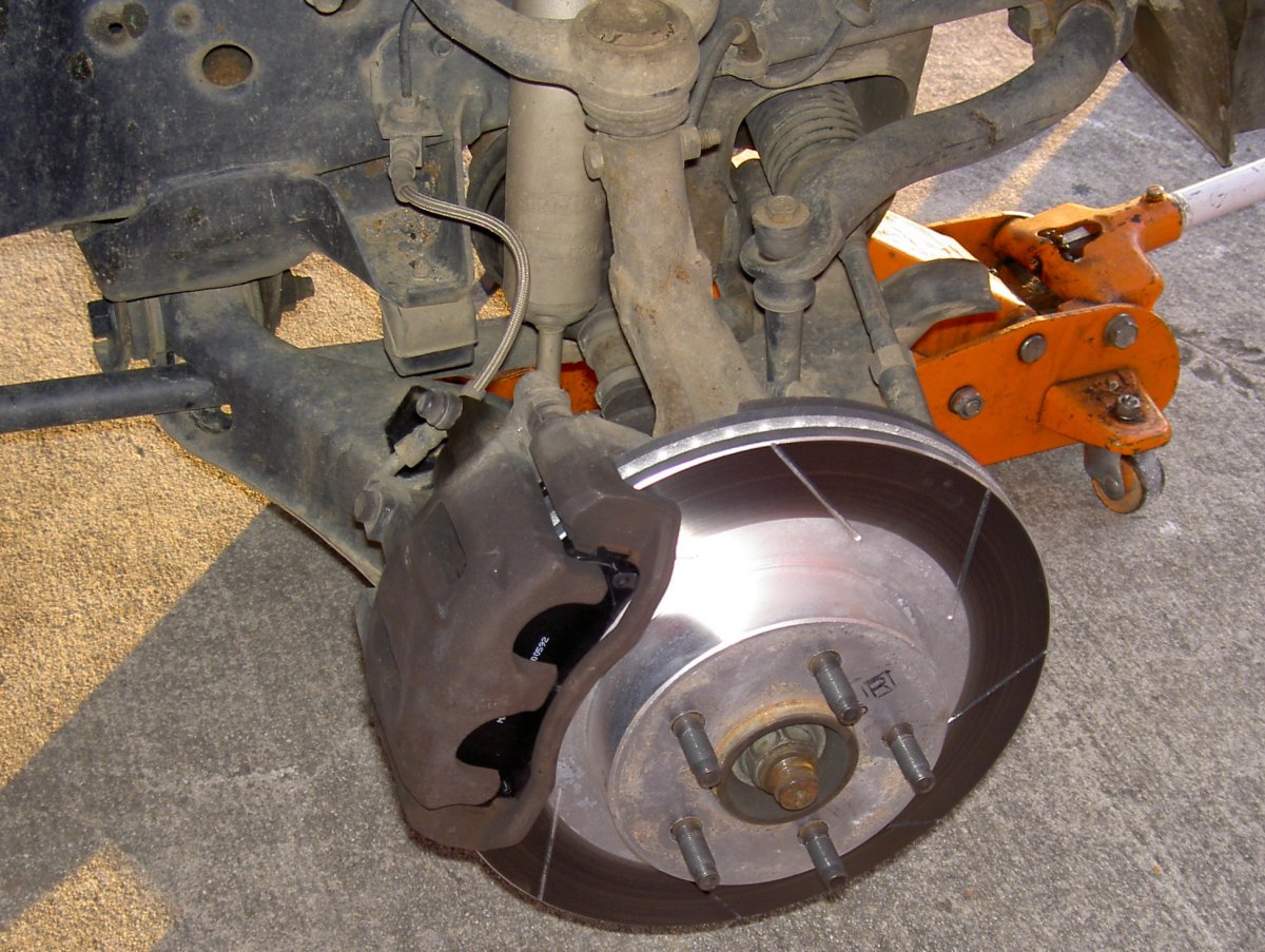

Here's the 12" front Sport Trac rotors on my 99, with the SS lines I had made locally. The drilled rotors I put on first, and the slotted rotors were Cryo treated, the 2nd set, with EBC pads. I later discovered the SD Motorcraft pads were acceptable for my mail truck.

You don't need the larger 2001 12" rotors unless you will be braking more seriously than me, delivering mail. I have the 12" rotors on one 99, they aren't enough of an upgrade for me to do it again for my last two 98's. I will have custom brakes on my 98 project truck, I still have my 2nd version of those on my Mountaineer. Those 12.75" rotors are much better, but the pads were the bigger issue. I used an SSBC caliper and didn't look hard enough at the pads they built them around. A 1998 Mitsubishi 2000 is too small to be adapting pads into a performance caliper. SSBC did that, and I went through about three sets of pads in ten years, 15 months on my mail route. The big rotors survived fine, the pads were eaten up in under a year. The small pads are not good for serious braking, so I'll get rid of those in my last custom brakes. I have Wilwood calipers to use with six pistons, and the pads are about 3/4" thick.

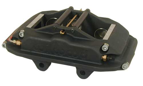

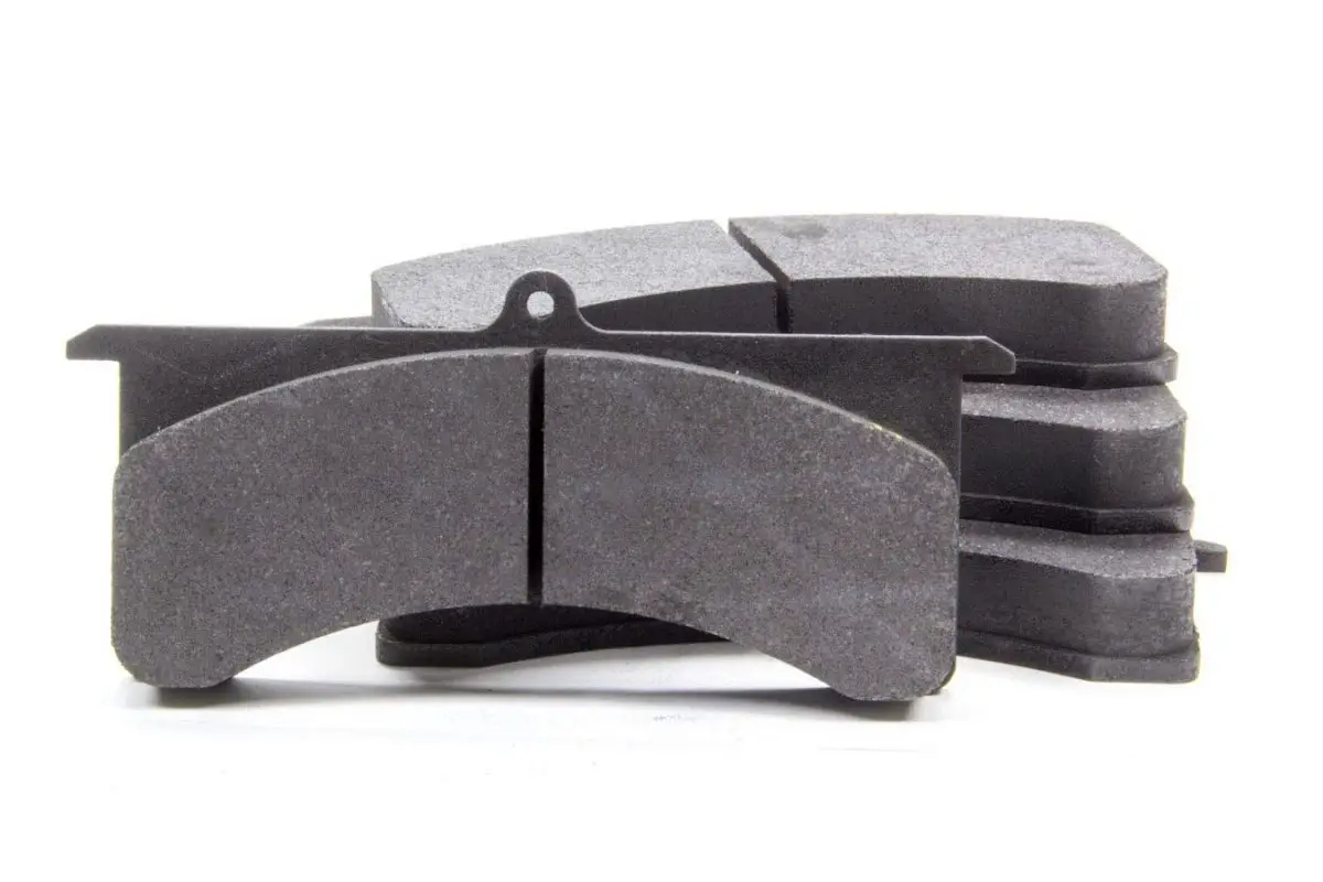

This is a solid caliper, and 7520 pads;

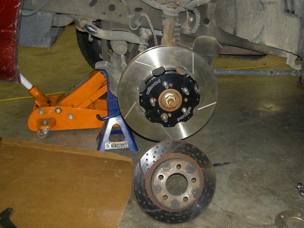

Here's the very first rotor I had made in about 2006, with the EBC 11" rotors I was taking off. That was almost a 2" difference.
