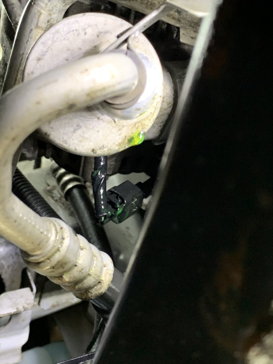

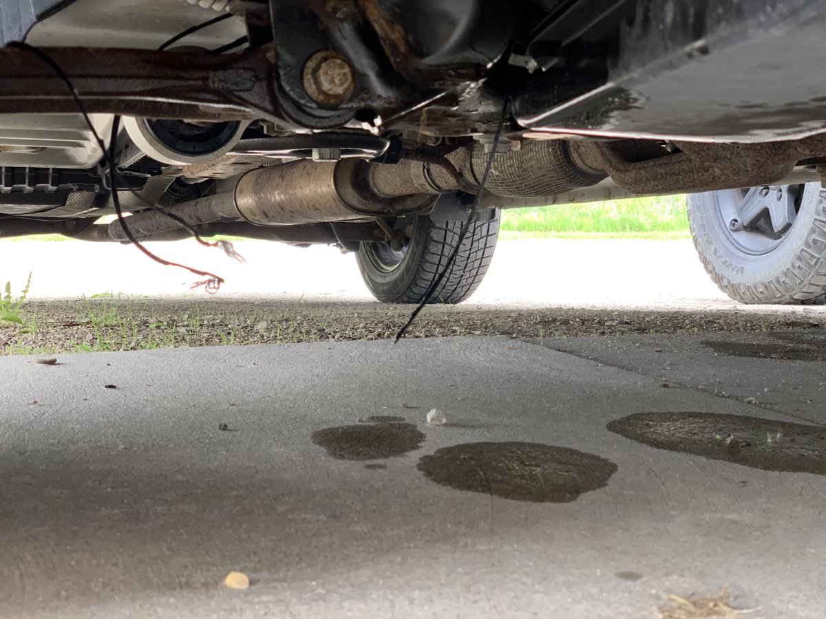

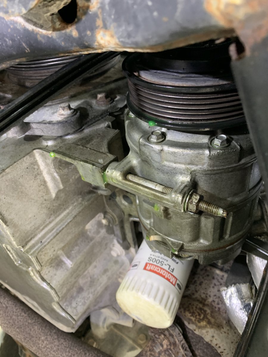

The accessory drive belt broke and now there’s some coolant leaking. It was driven like this for an estimated 5-10 miles. Any ideas as to where the coolant is coming from? I don’t see an obvious source. Hopefully not the water pump... Any help is appreciated. Thanks!

Did you happen to notice if the temperature gauge rose into the 'upper zone'? That would have indicated an overheating condition was happening.
I don't know if that would explain the coolant everywhere. Have you checked the coolant level to see how much it has dropped? It could be the water pump itself that is leaking but I don't see that causing the amount of fluid that seems to be all over. In any case, I suggest checking the oil on the dipstick to see if it look like it may be contaminated. There are several threads on water pump issues. Water pump replacement - who can do?
A leaking water pump, which is inside the engine, could ruin the engine. Water pump failure leads to dead engine
The most important thing right now is to try and locate the source.

Unfortunately, my wife was driving and she wasn’t watching the temp gauge. At least it didn’t overheat to the point of smoking. the coolant level in the reservoir bottle doesn’t seem to have dropped
the oil looks good, so there doesn’t appear to be any mixing.

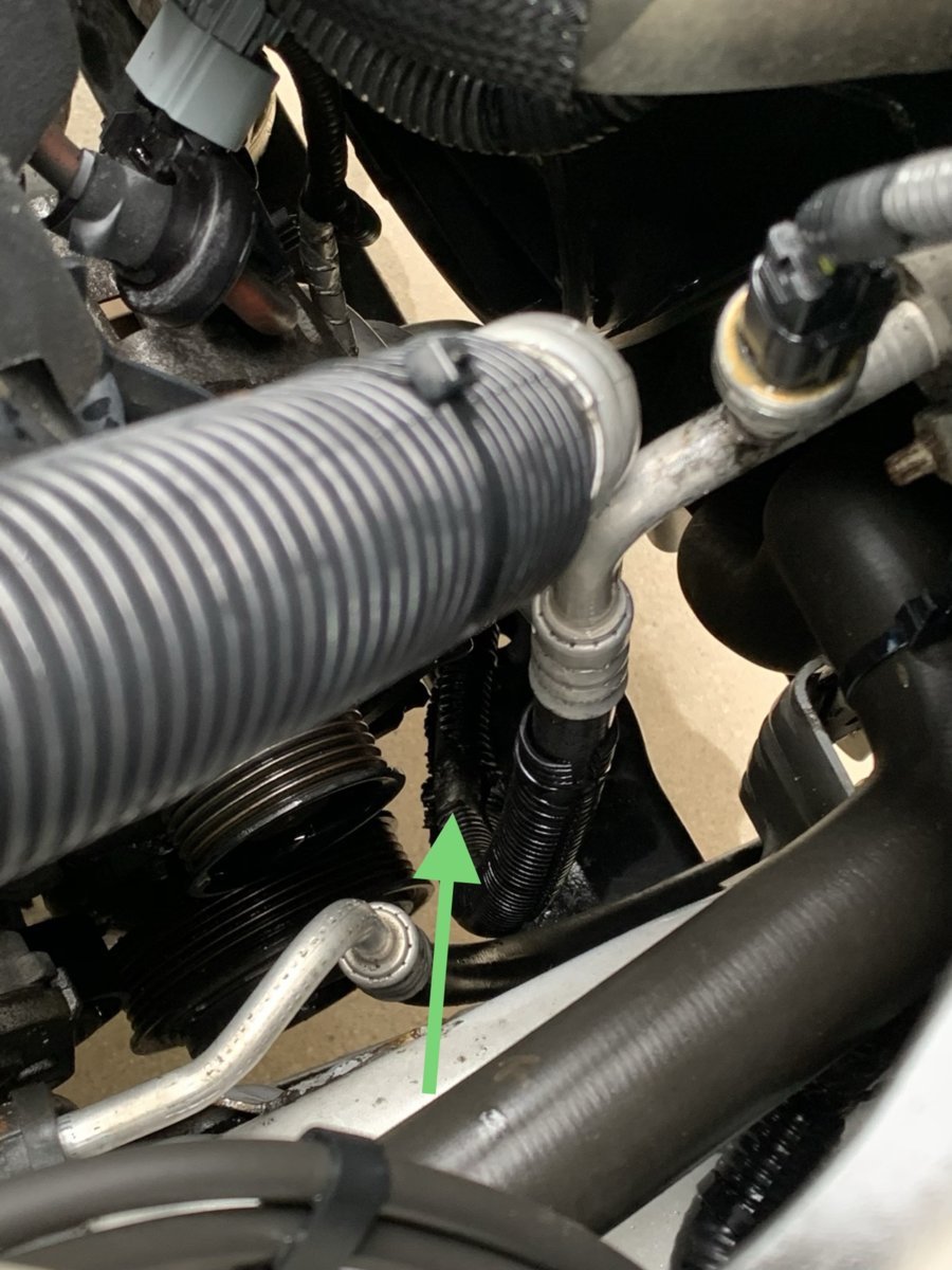

so far I just see one slightly damaged line, but it’s The A/C compressor-to-condenser discharge line so that’s not the source

could that be oil from the AC system/compressor? Does your AC work properly?
That sure looks like standard Prestone coolant to me.... but, anyway, what's concerning to me is that you have some sort of liquid dripping off of the very same spot that I first discovered my own Orange coolant leaving a sticky trail (on my 2018 3.5L V6), just underneath the AC compressor... a common sign that coolant could be seeping out of the water pump's weep hole. (I was also seeing a very slow drop in the degas bottle, over time...).
When I took it to the dealership, they diagnosed that my water pump seal was slowly failing, causing fluid loss out of the weep hole, but fortunately, it had not yet started introducing coolant into the oiling system... which will cause a rapid engine failure. They tore apart the engine and replaced the water pump, while also totally replacing both the engine oil and the coolant... just to eliminate any concerns about cross-contamination.
Anyway, that was my experience; keep an eye on your situation, as the results could possibly mean real trouble.
Sorry I forgot to update this thread. I was way wrong about my assumption! It wasn't coolant, it was just the A/C. I'd never serviced an A/C system before and I didn't know refrigerant oil has a UV dye that makes it appear like engine coolant. When the belt broke, it nicked the A/C compressor-to-condenser discharge line (what the green arrow is pointing to in an above post) and allowed the refrigerant to escape. I got a new line from the dealer (part # BB5Z-19972-C) for $60, and two 20oz. A/C Pro recharge bottles. An hour or so later, I had ice cold A/C again!
