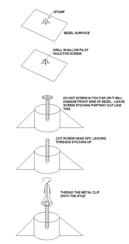

The tip you linked to sounds like a real good idea. What they're describing is basically making a stud out of a screw. I used to do this on custom RC car projects and it worked well.
Usually when the metal clips break off, they leave a roughly cylindrical stump behind on the bezel's backside. The stumps usually have reinforcing gussets molded on 4 sides. Find a small screw that threads into the metal clip properly. Personally I'd suggest a self tapping thread for greater hold. Then take that screw and drill a pilot hole for it in the plastic stump, and screw it in so that the screw is still sticking out, but enough threads are bit into the stump to be holding strong. Cut the head off the screw. Then thread the metal clip down onto the screw.

Cool, glad you figured it out. Check out the drawing I made in MS Paint of it. Not all parts drawn to scale but you get the idea. :)

Wow, that's a mighty good drawing for MS Paint!! Quickly done too! Thanks!!
