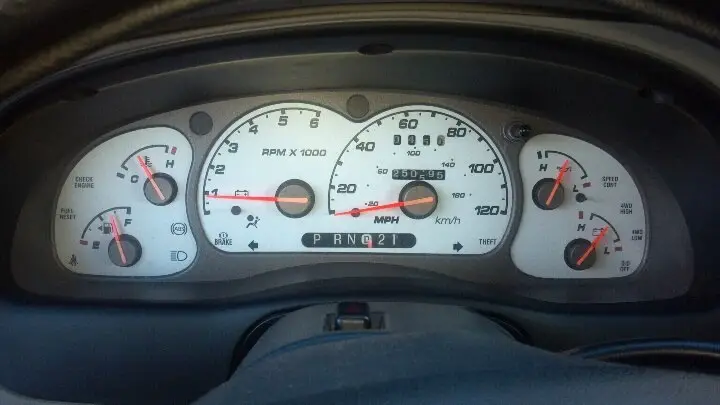

as promised............ this is my white guage swap, def easy to do, both guages used the same plugs, do your best to try and find a guage with similar miles, other wise youll have to change i by hand or swap your odometer and speed needle.
What's the white gauges out of?

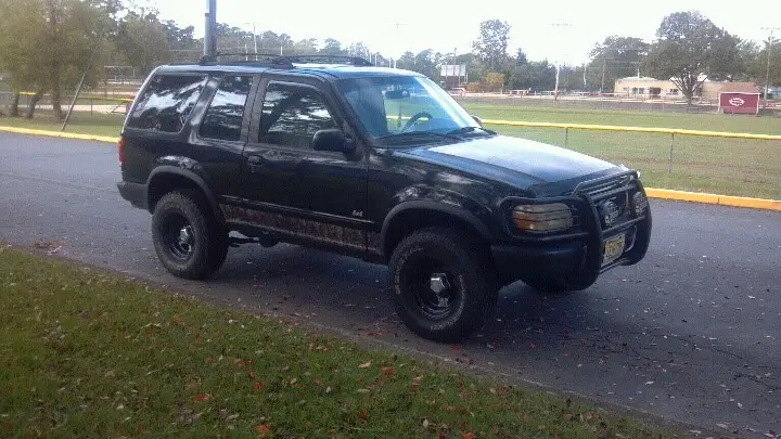

Truck looks great the camo is what I want to do to my pick up
Defiantly a nice lookin ride

thanks man its been a work in progress for a while now, the guage cluster came out of a 2001-2002 explorer sport. not sure the exact year but im sure any of the years from 01-03 sport will work. your truck being a 2000 i would bet anything the plugs are the same, hell mine was and its a 99. seeing how your truck is 4x4 youll want to get a white cluster that is out of a 4x4 that way youll keep your auto 4x4 lights. the camo was actually my wifes idea i got it from autozone for i believe 50-70 bucks sorry cant remember exactly how much its been on there for about a year and half. it was real easy to put on also, just been a water spray bottle and alot of patients*. the roll gve me enough to do both sides of the X as well as the top near the door, and still had a little left over.

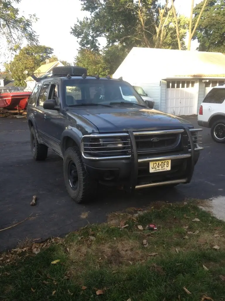

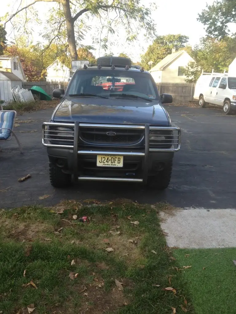

how far does that brush guard stick out on both sides, from the pictures it looks likeyou have a few inches on both sides. on mine i can barely squeeze a finger between the fender and guard.
I really don't know since its just resting on my bumper it seems like ill have a decent space by the way the arms are longer I'm still trying to figure out how I'm going to make the damn brackets it looks odd unless I just drill into the frame and add the brackets there
they may be your best bet, i only asked becaue i h a brush guard for a expedition that a guy told me it was for a explorer, and seeing how it sits on your truck it reminded me of it, id say a few good drill bits and some flat stock anything is possible lol
That's what I'm just gonna have to do ill weld it all together too for good measure

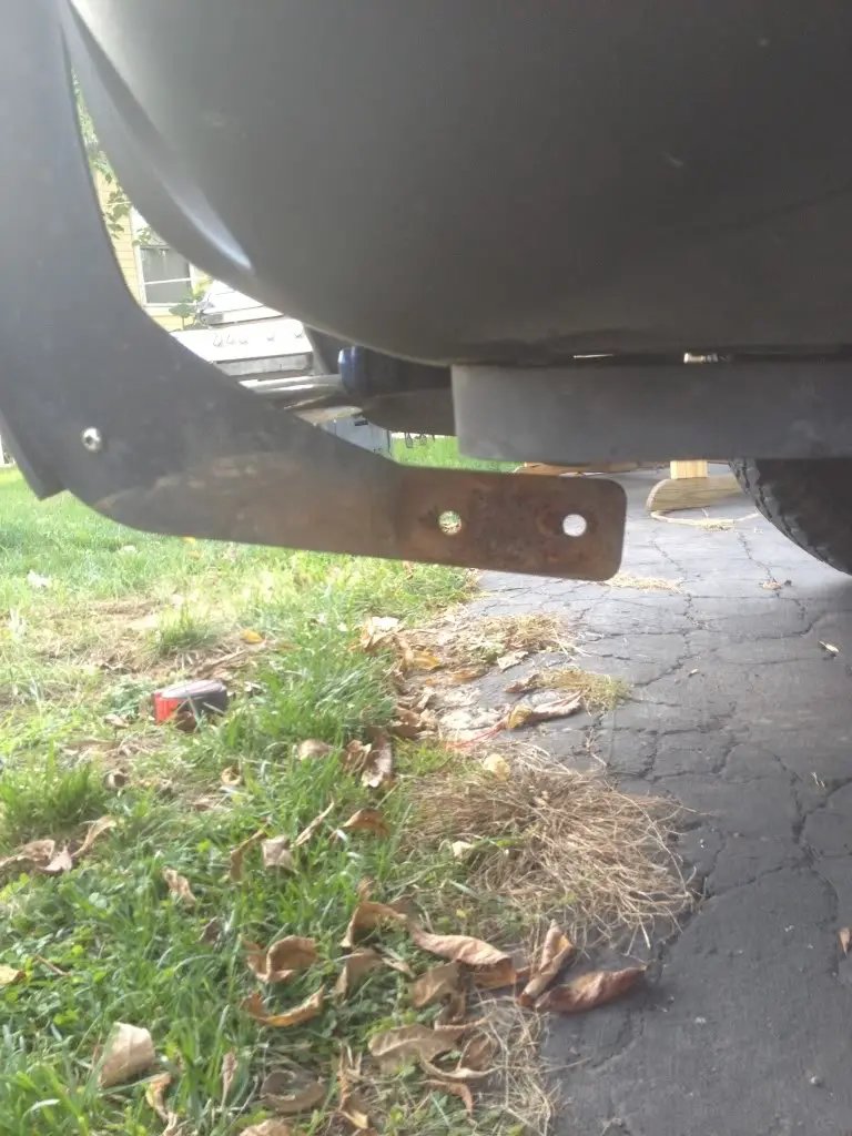

And if you could post a pic of where it goes through your bumper I think your bumper is different but a pic may help
yeah not a problem i had the same bumper as yours but opted for a all steel bumper of a 95 X it fit the brush guard better and held up better whacking the trees in the trails, im guessing you go to the hazelton location, seeing how its the biggest one of the three. ill snap a pic o the bumper tomorrow

heres how it gos under my bumper, before i had to cut some of the plastic air damn, which is one reason i switched to the metal bumper.
Ah I see I may have to swap to metal I like the look of the plastic tho damn ill have to see why I can come up with in a couple weeks when I get so e free time thanks for the pic dude

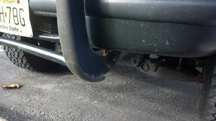

I chopped off the lower portion of the brush guard and mounted that piece to the frame. Then the brush guard got bolted to that piece. Check the picture
You can see the bracket coming out of the bumper. That mounts directly to the frame, and directly to the brush guard from there.
This could be an option for you as I was able to make it all myself, and it came out good for me.
