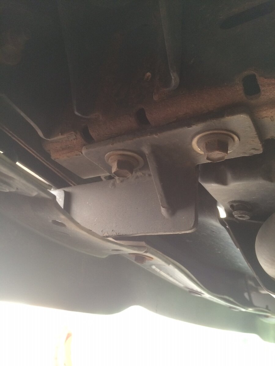

Here are a couple of pics that I took a while ago of the mounting points on my 03 Explorer. The mounting bracket bolts utilize the tow hook holes.

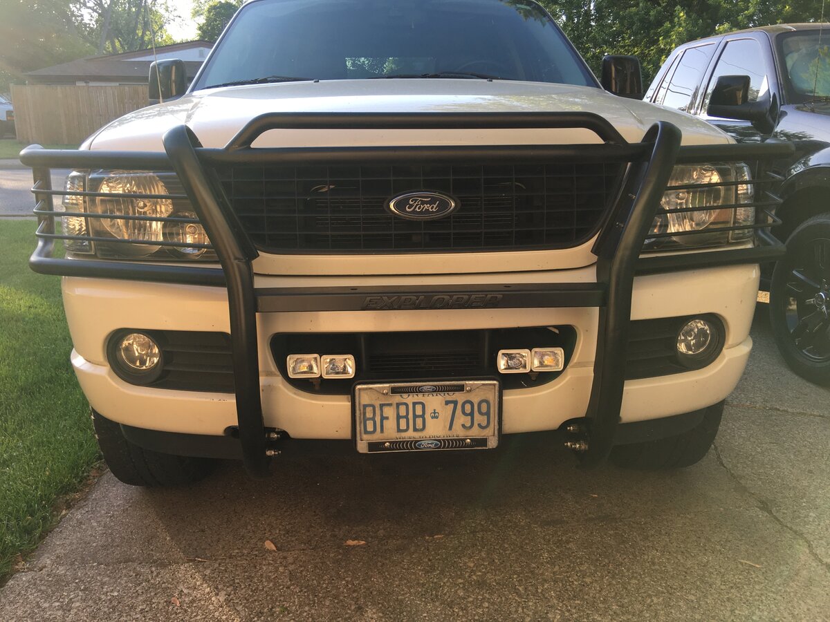

This is it on the Explorer. Note where the brackets come through the bumper in the tow hook openings- these don’t exist on the ST. You’d definitely want to make sure you get the mounting brackets, but there are certainly differences in the bumpers and the frame extensions that you would need to work with. Could probably be done, but you’ll be doing some extra cutting and drilling for sure.

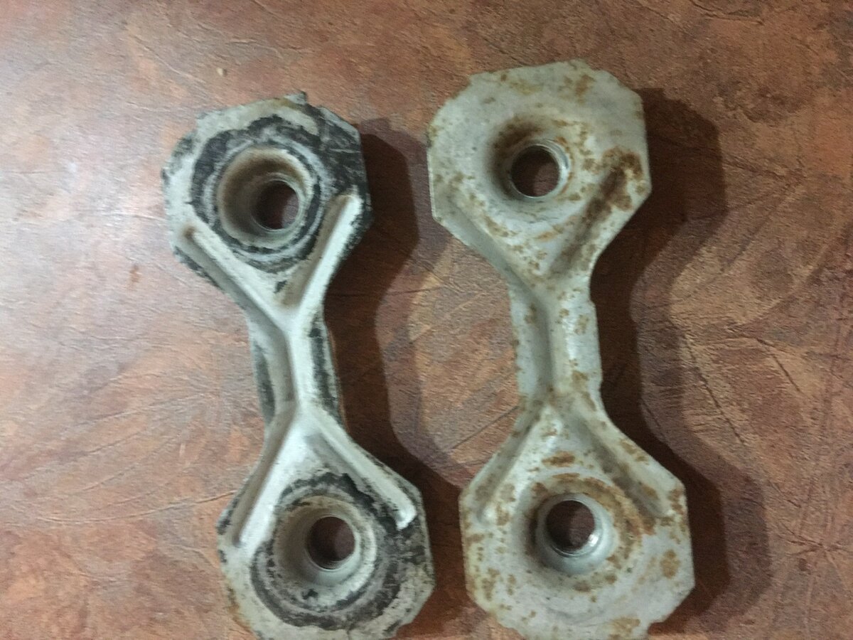

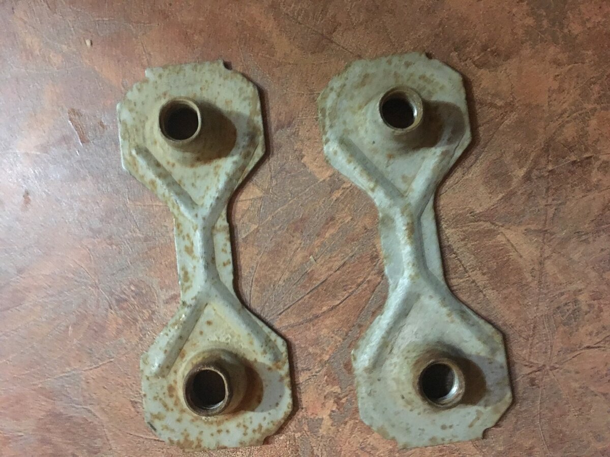

I also have the dog bone brackets inside the frame to thread the mounting bolts into. On the Explorer, the bumper (the inner metal section) can be loosened and tilted to slip the brackets into the frame. Not sure how you would do this on the ST.
Thank you, that is very helpful!
No problem. You can probably figure out a way to make the whole thing work. Be sure the seller has the big frame mount brackets. Keep us posted on your progress.
